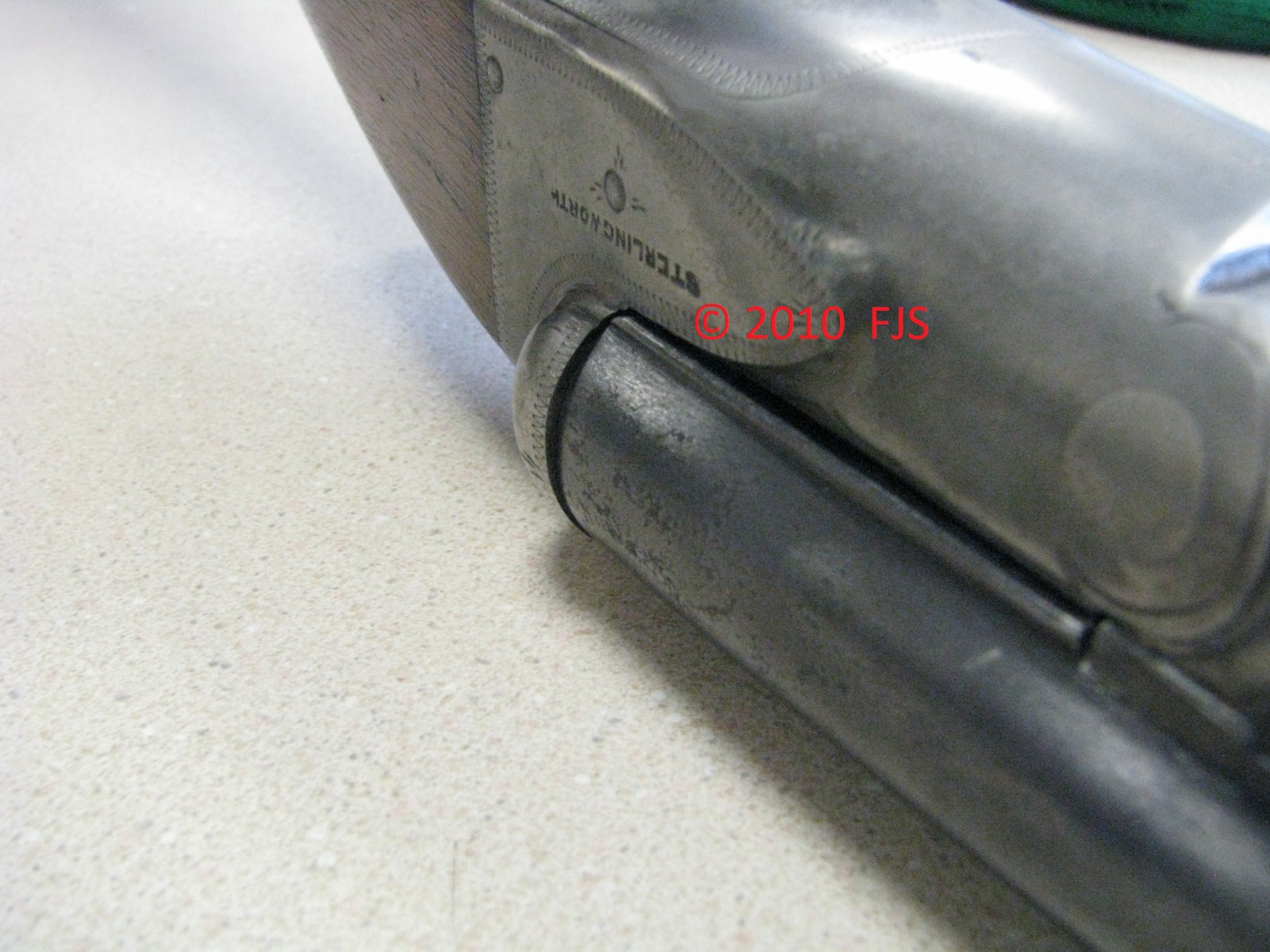

To clarify and FYI, here's the opposite scenario - a 20 gauge Sterly barrel on a 16 gauge Sterly frame. See pic. Note how the breech ball/fence extends beyond the diameter of the barrel breech.
Now ..... as I replied earlier, the barrel breeches on a 16g barrel will be larger in diameter than the breech balls on a 20g frame and both breeches will have to be "struck" to match the breech ball contour. Assuming the remaining wall thickness will be safe for use with standard factory shells. Once in a while I read where someone had barrel work done that compromised the wall thickness and the fella writes how the guy who did the work said it would be ok for real light (pressure) loads. How about when the gun is sold or otherwise moves on and the next guy or gal starts shooting regular factory shells loaded to SAAMI pressure specs? Bad business .......
