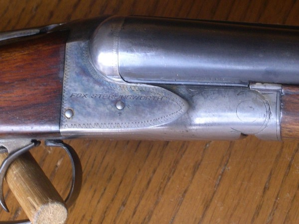

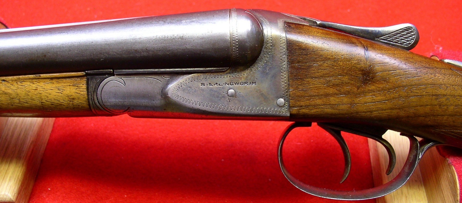

That is a very low serial number for a Savage gun. Philadelphia 16-gauge Sterlingworths I've recorded go up to 366666. All the guns I've recorded from 367024 on up are Savage. Is the gun marked STERLINGWORTH on the side of the frame --
or FOX STERLINGWORTH?
In theory a Fox 16-gauge chamber should measure 2 7/16-inch deep intended for 2 9/16-inch shells.
