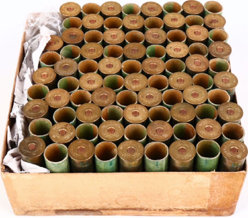

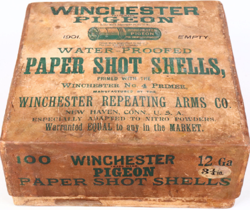

For years I've seen the listings in various North American ammunition company's catalogs from the 1890s to about 1907 for 12-gauge shells for bulk smokeless powder up to 3 1/4 inch. While I've yet to see a box of such loaded shells, a box of Winchester's 1901 PIGEON NPEs is in the May Wards Auction --

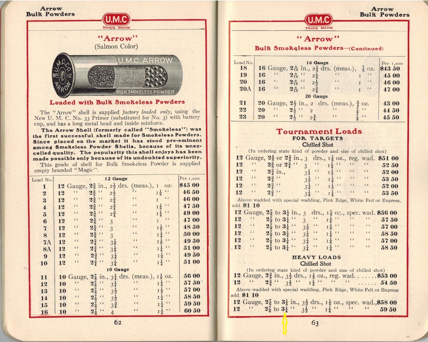

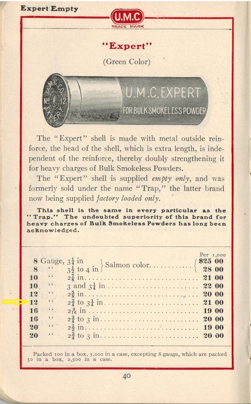

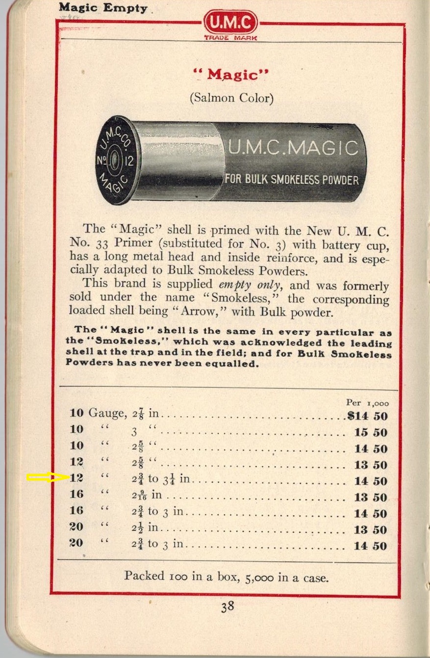

Some Union Metallic Cartridge Co. offerings from 1905 (yellow arrows) --

Really cool! Now to find the magic salmon colored ones

The only 12-gauge MAGIC NPE I've found is a 2 7/8-inch --
Magic No. 12, 2 7-8 inch.png (120.46 KiB) Viewed 5922 times

The box with 85 NPEs went for $1727 plus the vig. Our friend Will Gurton got a picture of one of the NPEs on a tape measure --
1901 PIGEON 12-gauge, 3 1-4 inch, NPE.jpg (93.18 KiB) Viewed 5818 times

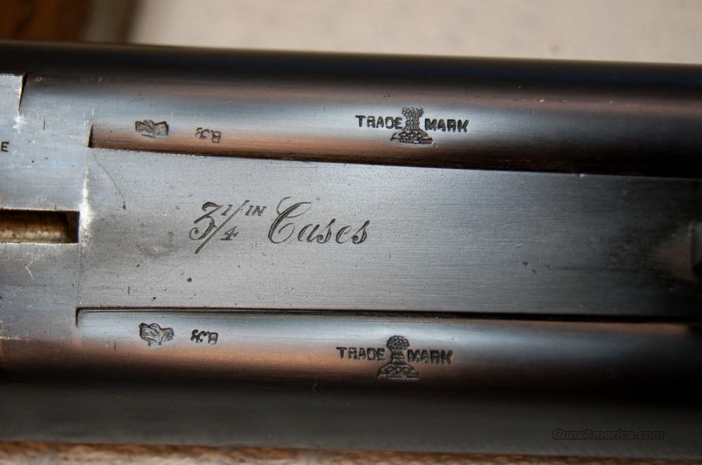

My Greener eight gauge is nitro proved for 3 3/4" cases. I haven't seen such ammunition on the Ward's site. Still looking.
