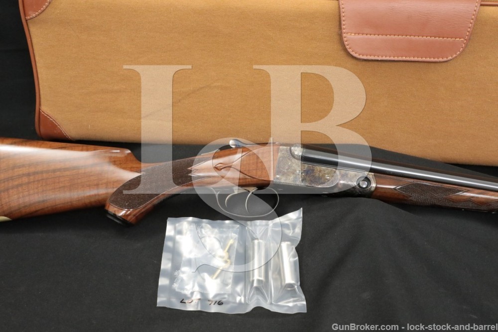

I have always tinkered in the back of my mind with owning a 28 gauge sxs. The one that my mind kept wandering towards was a Parker Repro made in the 1980's. Knew I would never be able to afford an original 28 Gauge Parker in any grade and it appears that the 28 gauge repro for the most part has passed the test of time and gets mostly 2 thumbs up for the Parker crowd. I had set down some must haves that I wouldn't compromise on and those included having two triggers and Q1 and Q2 factory chokes. Beavertail forearm was also on the wish list, but I'd not seen one for sale forever that hit all of my criteria. Well, one popped up on GB last week and it had everything going for it except the beavertail forearm and after setting a self imposed bidding limit I went after it and sealed the deal as they say. Funds have been sent as well as the FFL. I'm guessing in about 10 days I'll have my mitts on it. If everything is as expected it will be added to the Woodcock harvesting gun safe.
PS. First non-Fox double I've bought for many many years. Only other "non Fox" in the inventory is an Ithaca SKB 20 gauge that I bought so I could have a single trigger gun for ultra cold weather that I encounter out west chasing late season birds.
Double PS. Pictures to follow.

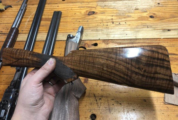

Stockman is finishing up work on my Repro. Sent me the below pic yesterday. As many know most of these guns have too little DAH. Some stocks can be bent some can't. This one I thought could be because its quartersawn and I was correct. Went from 2 1/8" to 2 3/8" DAH and added some cast as well for a righty. Then getting rid of that god awful bowling ball finish and adding an oil finish. This one is stocked in Claro and per my stockmaker had pores deep enough to catch fish in. Lots of filling in those pores before applying the finish. Anyway this is where we currently are. I'll have it back in probably a month. Finish being applied is Timberluxe.
