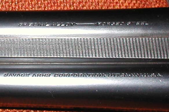

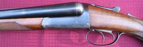

Just looking again at Paul's last two pics I don't see an engraved line around the barrel breeches and just fore of the breech balls.
The early SP-/SPE-Grades from their introduction in June 1932 into 1934 were absolutely plain, not a stroke of engraving anywhere --
Early Style SP- or SPE-Grade
By 1935, Savage added a bit of border engraving as on my 1937 vintage 16-gauge shown above. Also at some point in time they changed the right barrel roll-stamping to SPECIAL ALLOY -- FORGED STEEL and as on my gun the name Fox doesn't appear anywhere on the gun?!?
303548 05.jpg (54.5 KiB) Viewed 5640 times
Someone at Utica must have eventually noticed this and they began engraving A.H. Fox on the sides of the frame.
