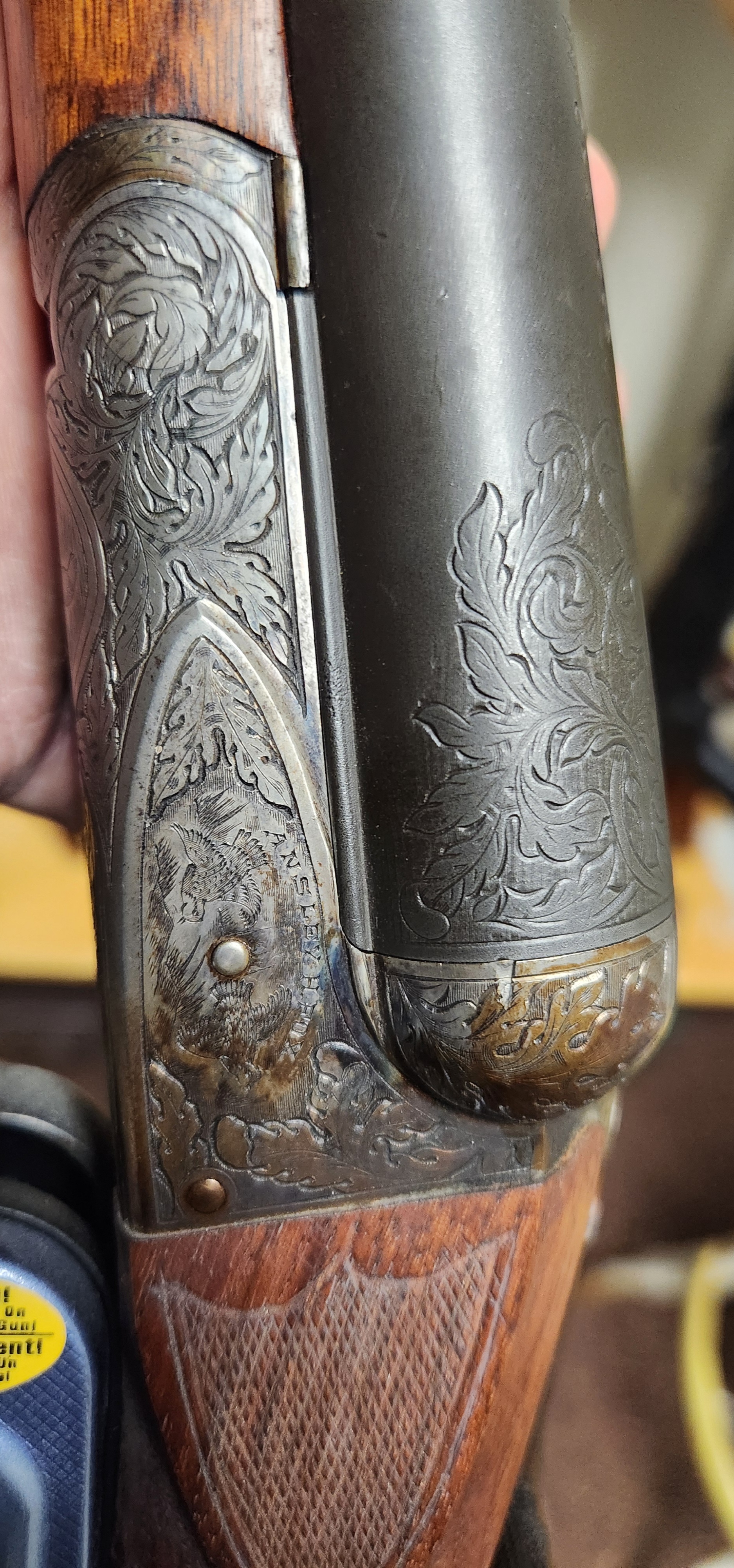

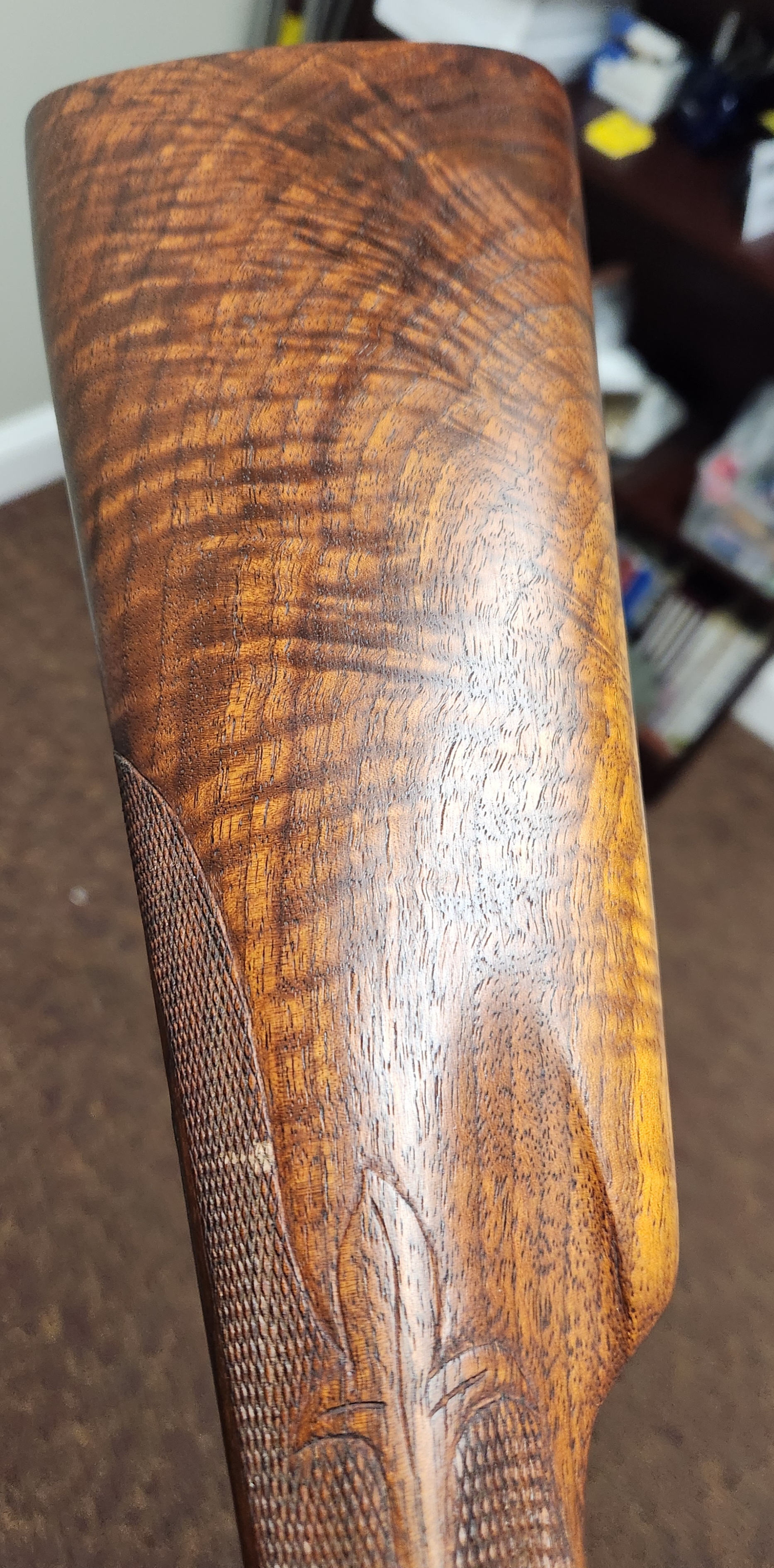

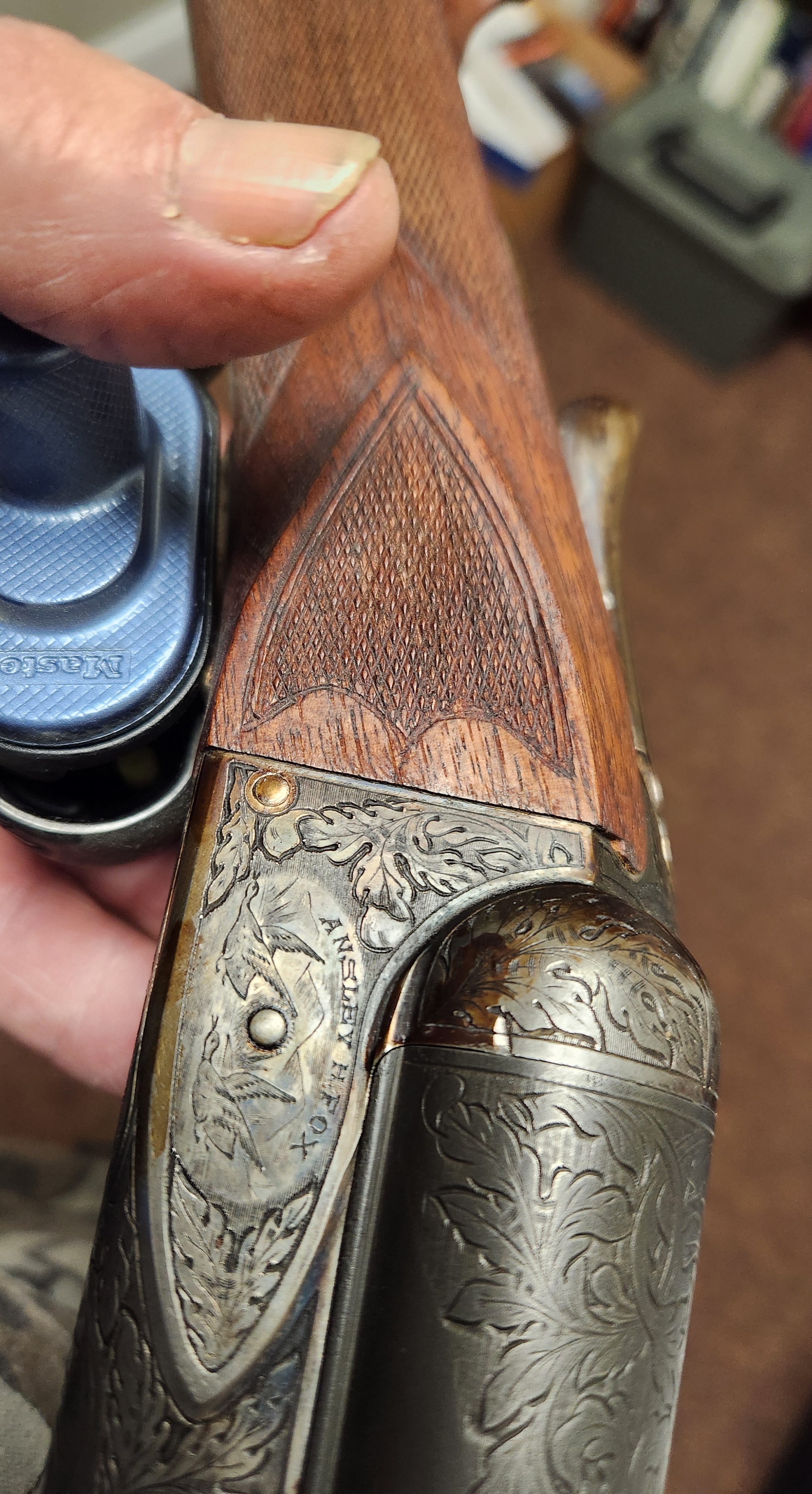

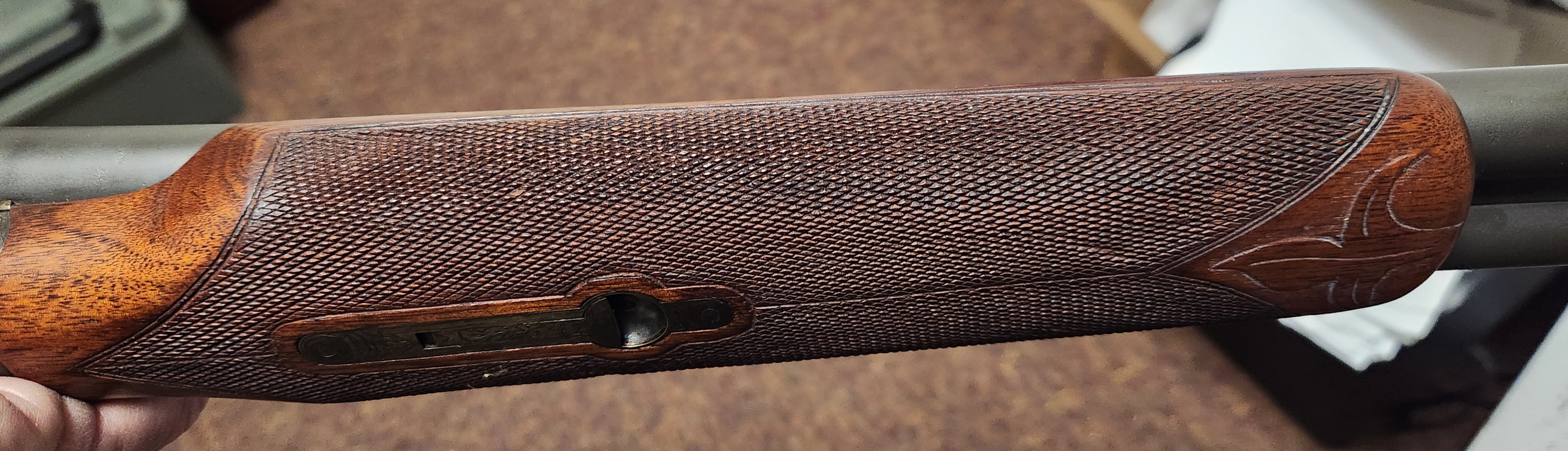

Re: Fox at a local store...another better one showed up
Post by Weatherby »
Oh my.....they may be getting this one.
I called dibbs already.
Some cool stuff is coming out lately.
Has thanked: 2521 times
Re: Fox at a local store...oh my forget that one
beautiful X ,keep us posted :wink: ps slight marks on both sides of fence,possibly vice jaws?
