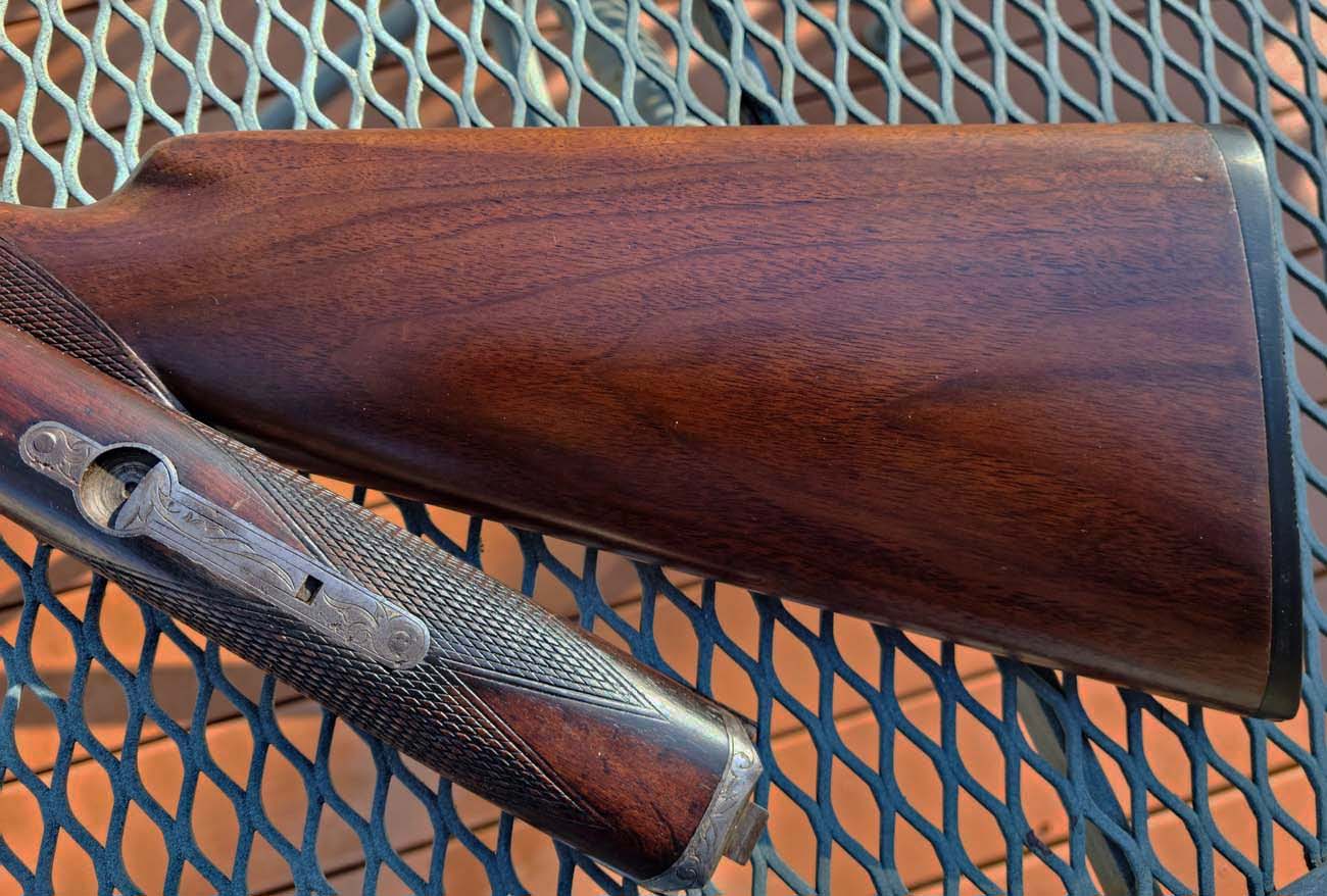

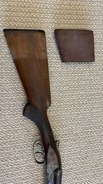

I added some finish and stain to fix the light spot caused by moisture under the slip on rubber recoil pad and match the color/finish of the forend. The barrels had some ugly pitting not deep but detracted from the gun, Breck Gorman is reblueing them after I polished them. Will make a nice little Fox 20ga hunting gun.

Very nice! John

Very nice job on the wood Craig. It looks perfect.

Wonderful little Fox!

It looks very nice Craig. It's nice to see this little girl being rejuvenated. Woodcock beware!

Wow! Nice job Craig. You can't tell the difference. Timberluxe?

Thanks for the positive comments. Daryl I do use Timberlux walnut stain, it is the best for duplicating Fox tone and color in my opinion. For this gun I use a matt spar varnish since it has great prosperities for a hunting gun, good in soaking conditions and flexible in cold to hot temperatures. I finish with a rub down with Brownell's triple F rubbing compound.
