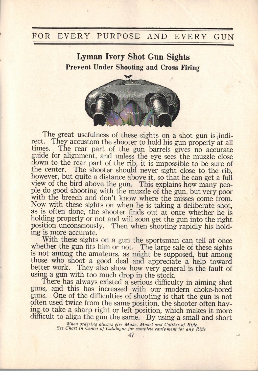

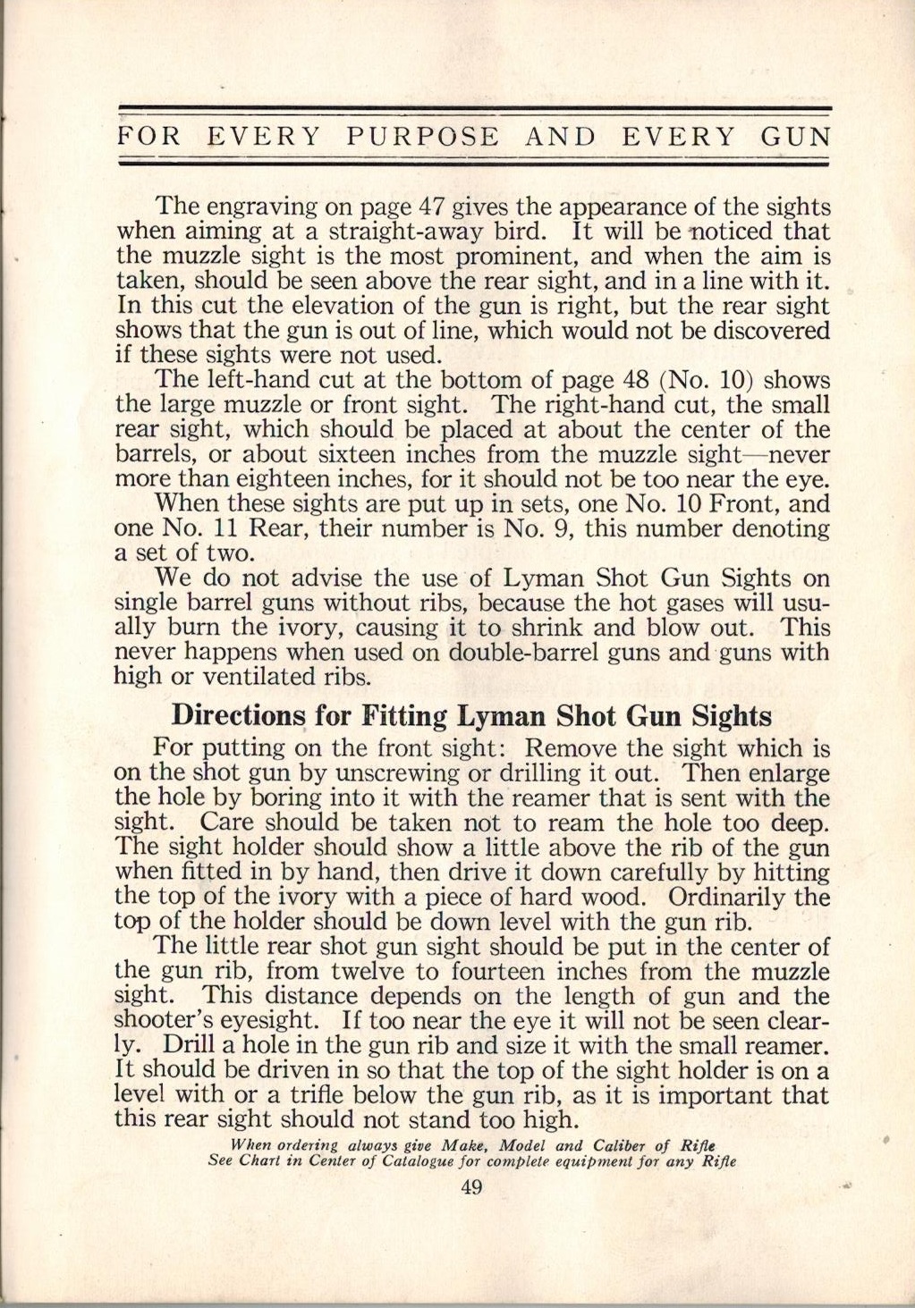

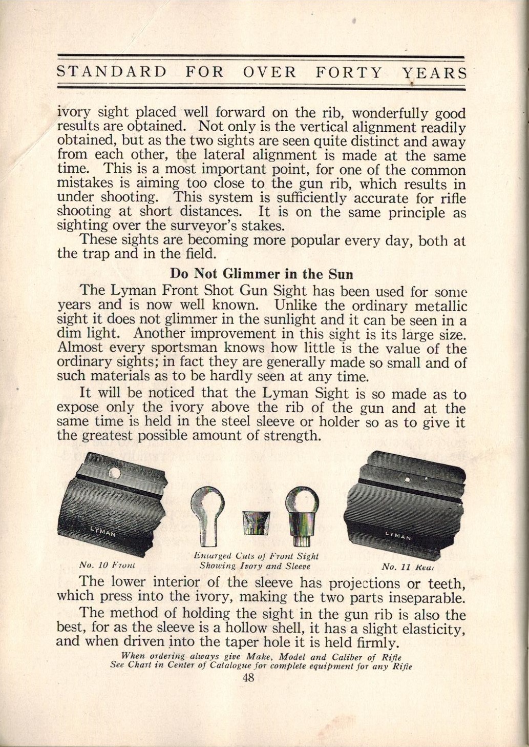

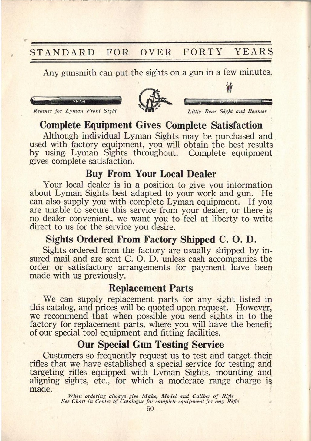

From a vintage Lyman Handbook/Catalog --

Thank you Dave. Just to clarify, what I referred to as the metal ferrule is the sleeve/holder mentioned in the text. One and the same. frank
