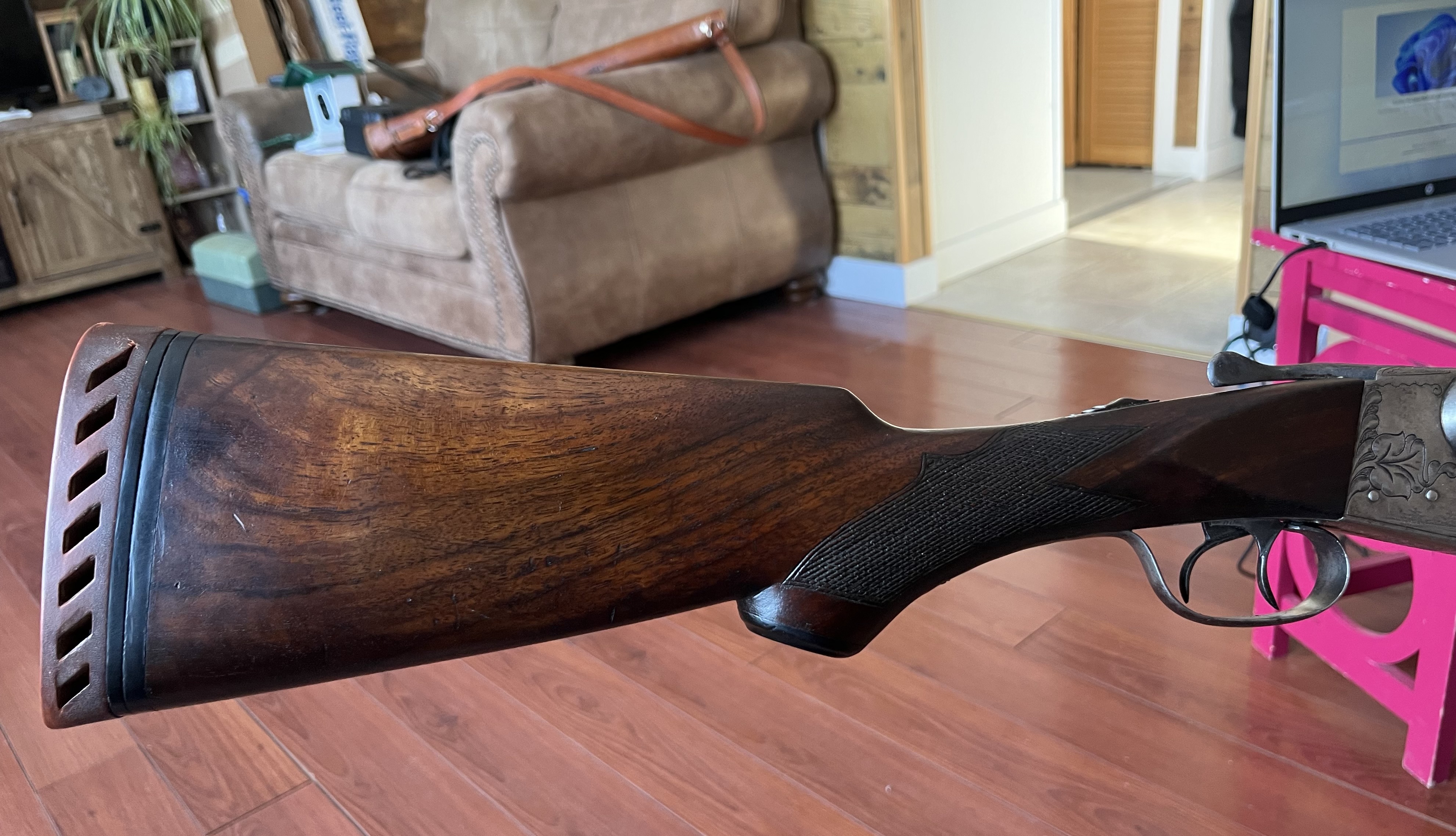

Lucked out again!! I picked up this Ithaca Flues 16ga through an online auction. It was advertised as a Grade 1 1/2 but the engraving of the dog on each side with bordering instead of large floral pattern had me convinced it was a Grade 1. The water table is stamped 1 1/2, 16 on the left side and PATD on the right. The rear of the barrel lug is also stamped with a number 7 on top above an S & 1 1/2 on bottom leading me to believe it is in fact a 1 1/2 Grade. All serial #'s match throughout.
The gun was advertised sporting 30" Krupp Fluid Steel barrels with 2 3/4" chambers and IC/F chokes which I cannot confirm until mic'd as I cannot find any choke or chamber length stamps. I'll confirm before I shoot it. The barrels wear a pair of ivory beads. It was also advertised as "barrels slightly loose on face" but that does not seem to be the case. There is absolutely zero play or any movement of the barrels in the receiver and it locks up tight with the lever well right of centre. The auto safety still functions properly and the triggers are crisp and positive with zero creep. I'll put my trigger pull gauge on them when I get a chance. There is no pitting or rust anywhere to be seen, bores are shiny and bright. There is a bit of colour case remaining on the top lever and top tang. Screws are not chewed up. Engraving and stampings are crisp and sharp.
The wood furniture is beautifully figured without any visible cracks but there are some light scratches and a few handling marks. The stock has been shortened with a lop of 13.5" to the front trigger and I'm 99% certain refinished, maybe even restocked?
Not certain if the checkering pattern on the pistol grip stock is an original pattern but it is very nice and definitely looks like something Ithaca would have put on a graded gun. The forend appears to be original and untouched and in very good condition and snaps on/off easily and securely with zero play.
A black pachmyr old english style pad has been added. The gun is lightweight, beautifully balanced, comes to shoulder and points like a dream!
I had my wife throw it to her shoulder a few times and when she picked it up she excitedly exclaimed "oh this is so nice and light" and then added with a tone of suprise mixed with excitement, "this is the first gun I have ever put to my shoulder that the beads are a perfect figure 8"! She then added "looks like I'm buying 16ga ammo now too!".
I told her I'd be more than happy to provide her with ammo if she was to take part in some SxS hunts and shooting with us.
Overall I think I did a-ok for a winning bid of of $675 coming to a hair over $800 with buyers premium, shipping and tax included.
Quite certain we have just added a nice little Hun gun to the fall line-up!
Sorry for the poor lighting in the pics. Any recommendations for ammo for this old girl? I assume low pressure light loads of 7/8 to 1 oz would be more than adequate?
