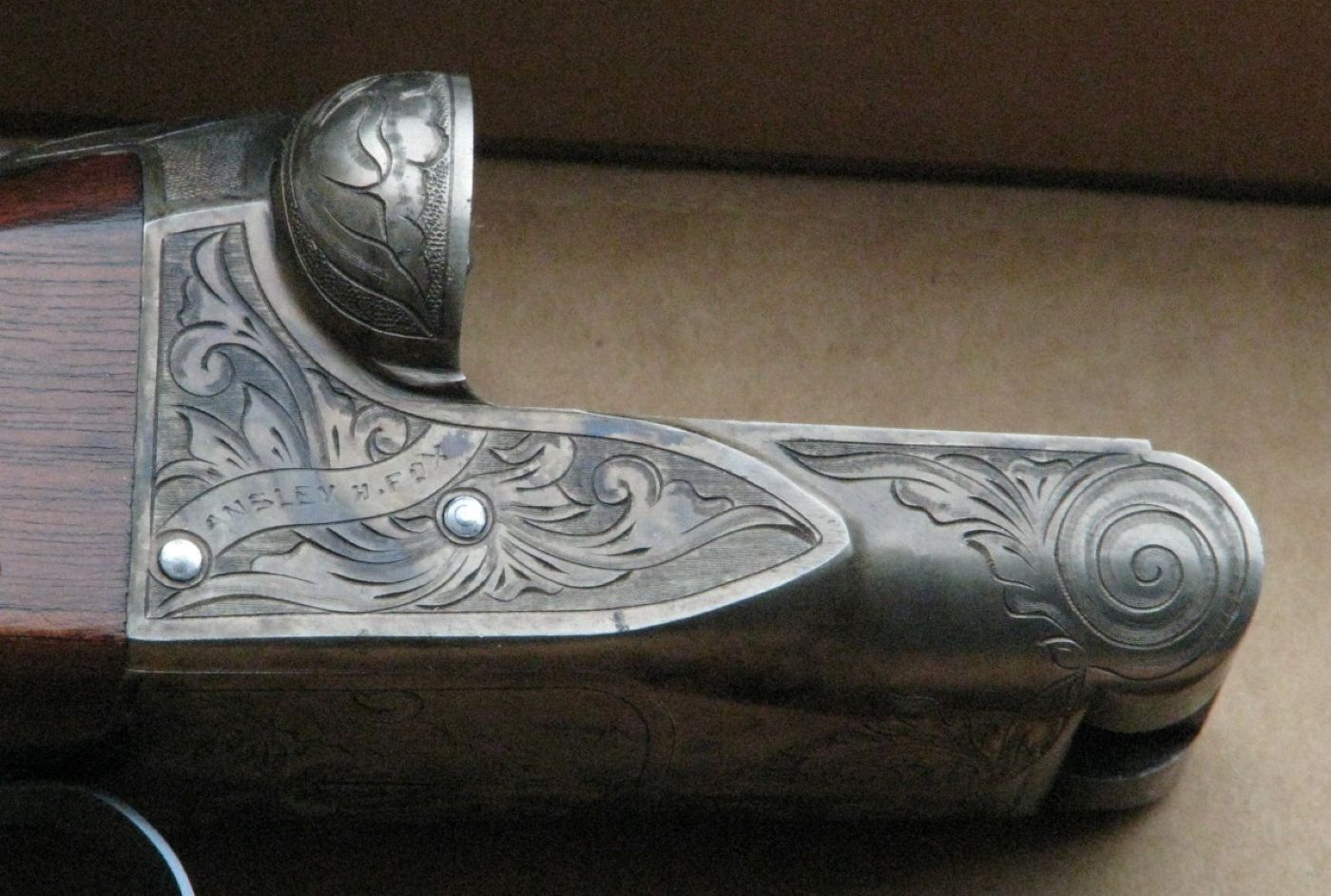

Here's a Utica era 16 bore AE that came to me new in the box with the factory wrapping paper. I don't see any evidence of a coating, and interestingly the CC is faded despite (apparently) not having been exposed to sunlight as many think is detrimental to the colors. frank
