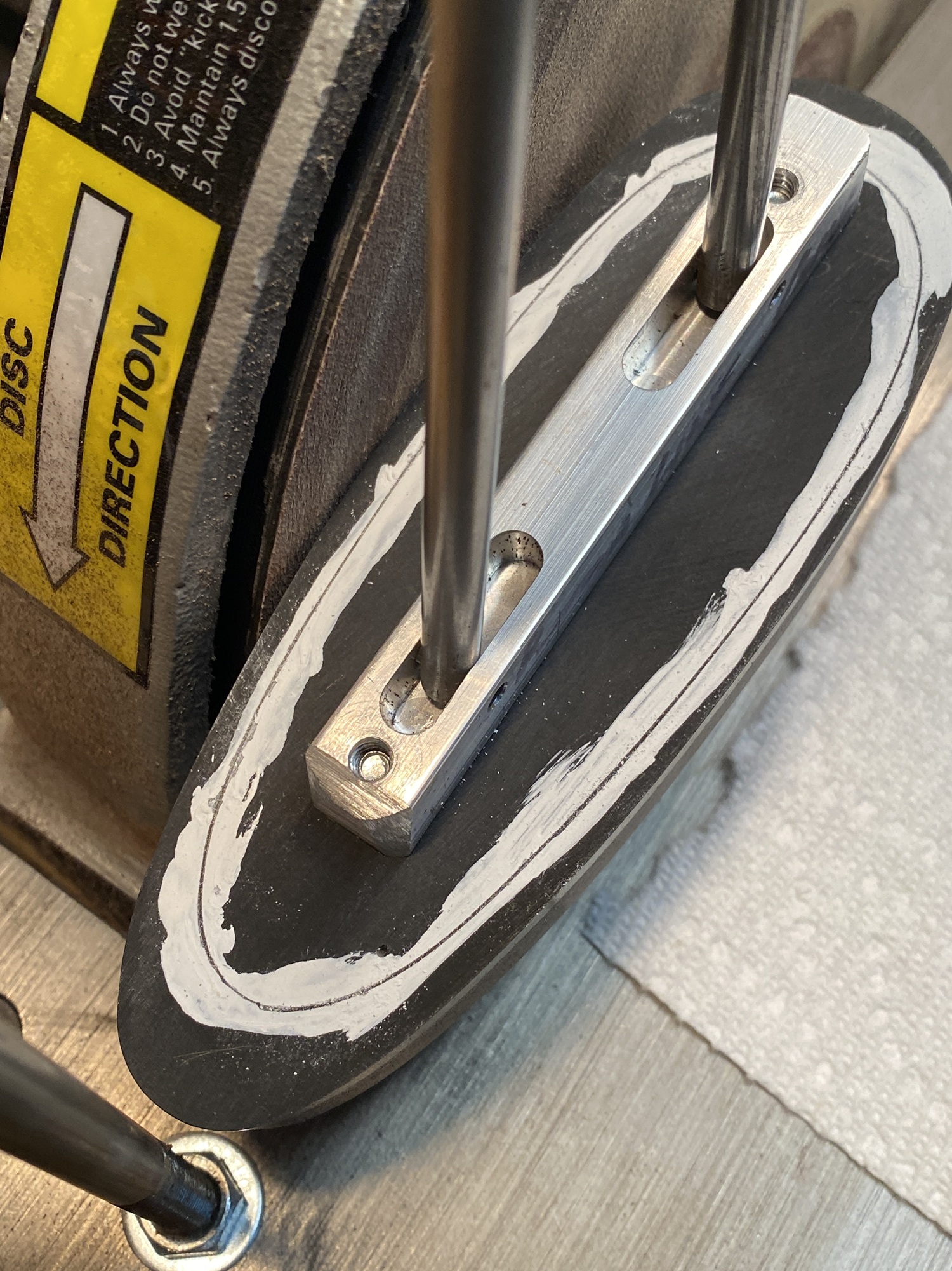

Yes Spyder a very nice job. I also like the 1/2" brick colored pads made by CSMC and I enlarge the screw hole centers to exact 3/8" diameter and make 3/8” plugs from a donor pad ..... which comes close to replicating a vintage SW Silvers thin pad (5/8" thick) insofar as looks but without the giganto screw hole plugs.
My pad jig is the "pendulum" type as referred to by Stan, made by Kick Eez, and hangs on its shepherd hook with small swivel on a high speed 12” disc sander that's dedicated to pad fitting work. Shown here already set for the comb line and toe angle and getting started on grinding a pad to the scribe line. frank
