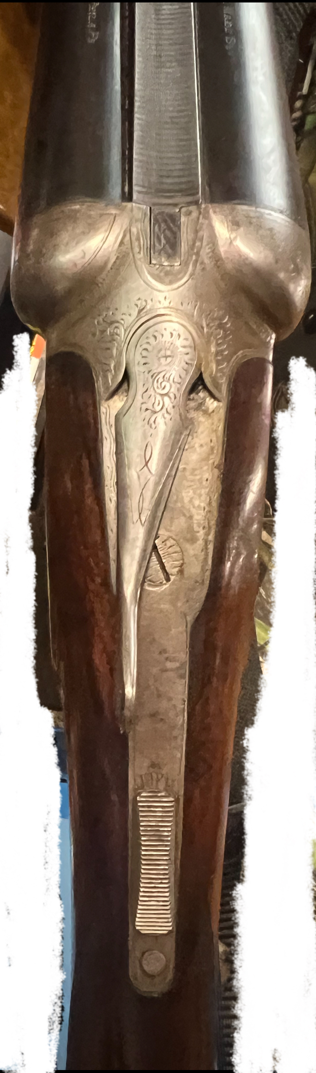

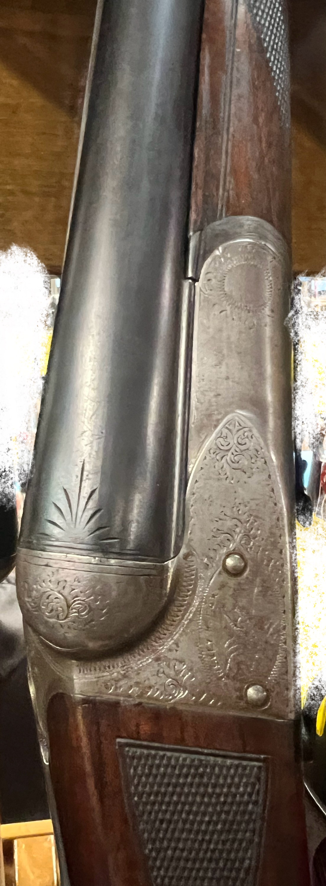

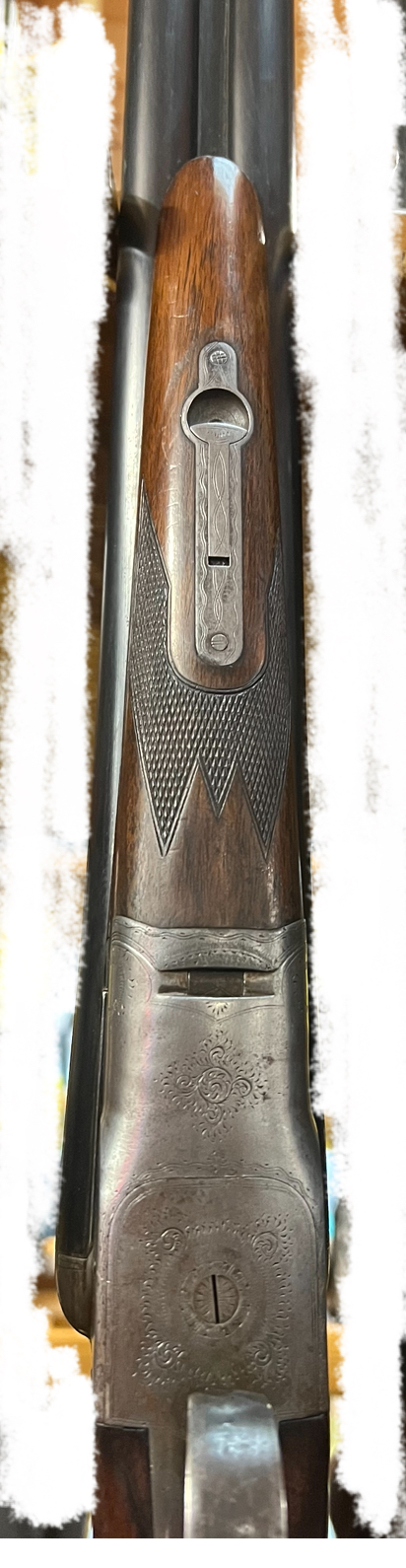

Hello to all and thanks for allowing me to join. I have a couple Sterlingworths 16 and 20 in my hunting rotation thusfare.. Recently ran into a A.H. Fox B grade 12 ga with 30” barrels the other day that overall looked descent at a pretty good price that I would think is a bit negotiable . Issue is the Break Action lever to the left.
I have read multiple threads on several forums, but I am actually wondering what a ballpark proper fix would go $$$ and if it is worth to do so on a B grade gun @ 30” . Most threads give a diagnosing etc , however no real indicator of what one would possibly be looking at $$. See a lot of run away suggestions when asked. At what grade and what line would someone want to actually talk about getting it fixed?

The cost depends if the gun is on face. With the forend removed does the barrel shake side to side or up and down. If the gun is on face a gunsmith can weld up the barrel tang and fit it so the lever sits center or to the right. I would guess that repair would be about $300-$400. If the gun is off face then the barrel hook would need to be welded and fitted add another $400-$450.
I appears to be a very nice gun with a rare engraving pattern for a B, fixed up I would say it would be a $2300 to $2700 gun. Craig

Re: A.H. Fox B Grade
To my eyes, that lever looks like it’s bent a little. Is that the case?
Just looking at the pics, it does look like the barrels are on the face, or at the least very near so. Plain and simple, the lever has been bent counter-clockwise probably to make it look less left to the uninitiated. Another possibility is a hand or finger deformity and made so for the owner’s ease of use
Most Fox levers are relatively soft and easily bent, but I've also seen some that were harder and broken in two by bubba fellas. There are many reasons for "lever left" beyond wear on the barrel extension camming surface, that don't involve microwelding and refitting to fix, to include wear-play and broken parts inside the locking mechanism. A competent Fox man can diagnose it quite easily once in his hands and stock removed. frank
