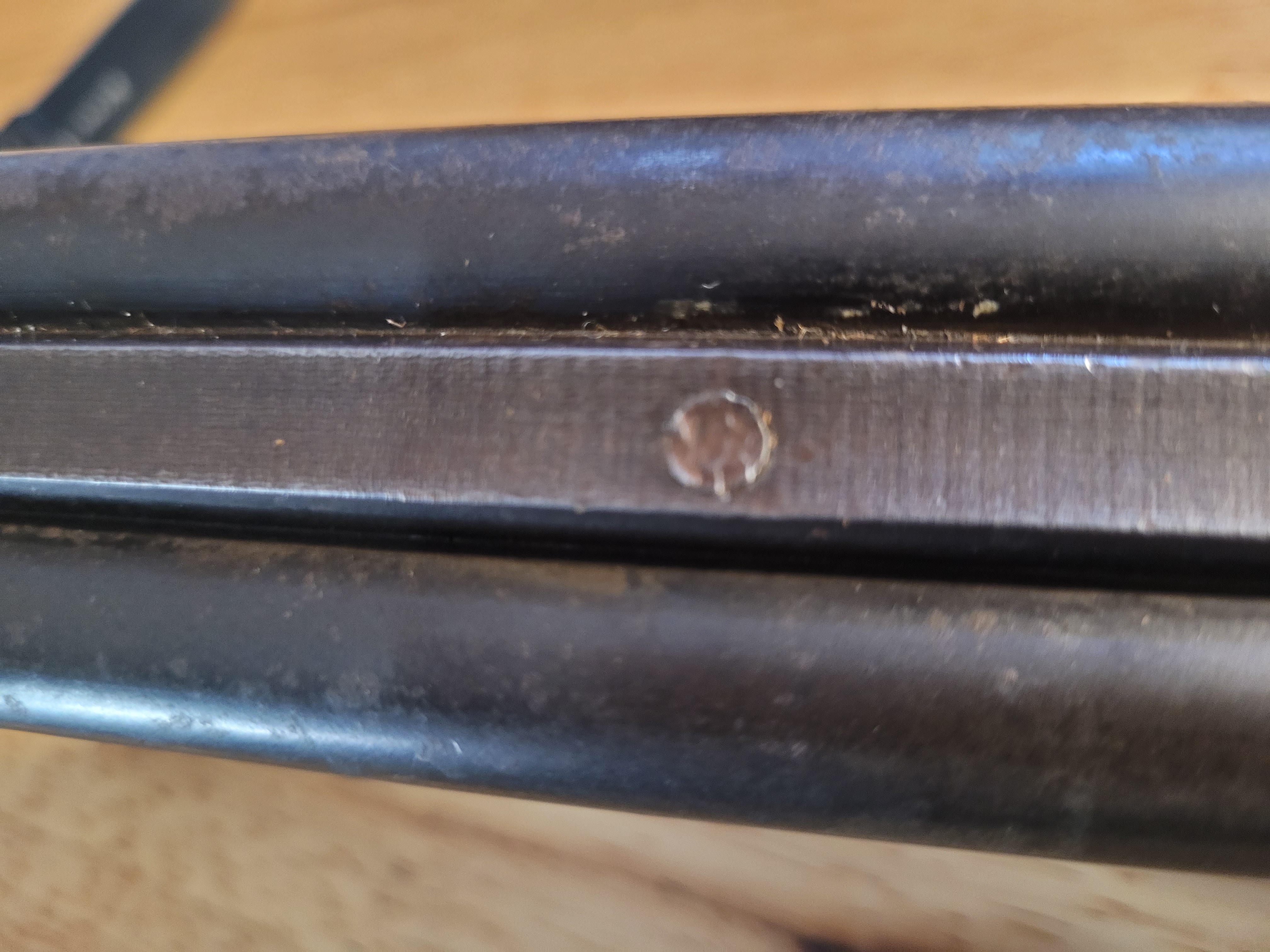

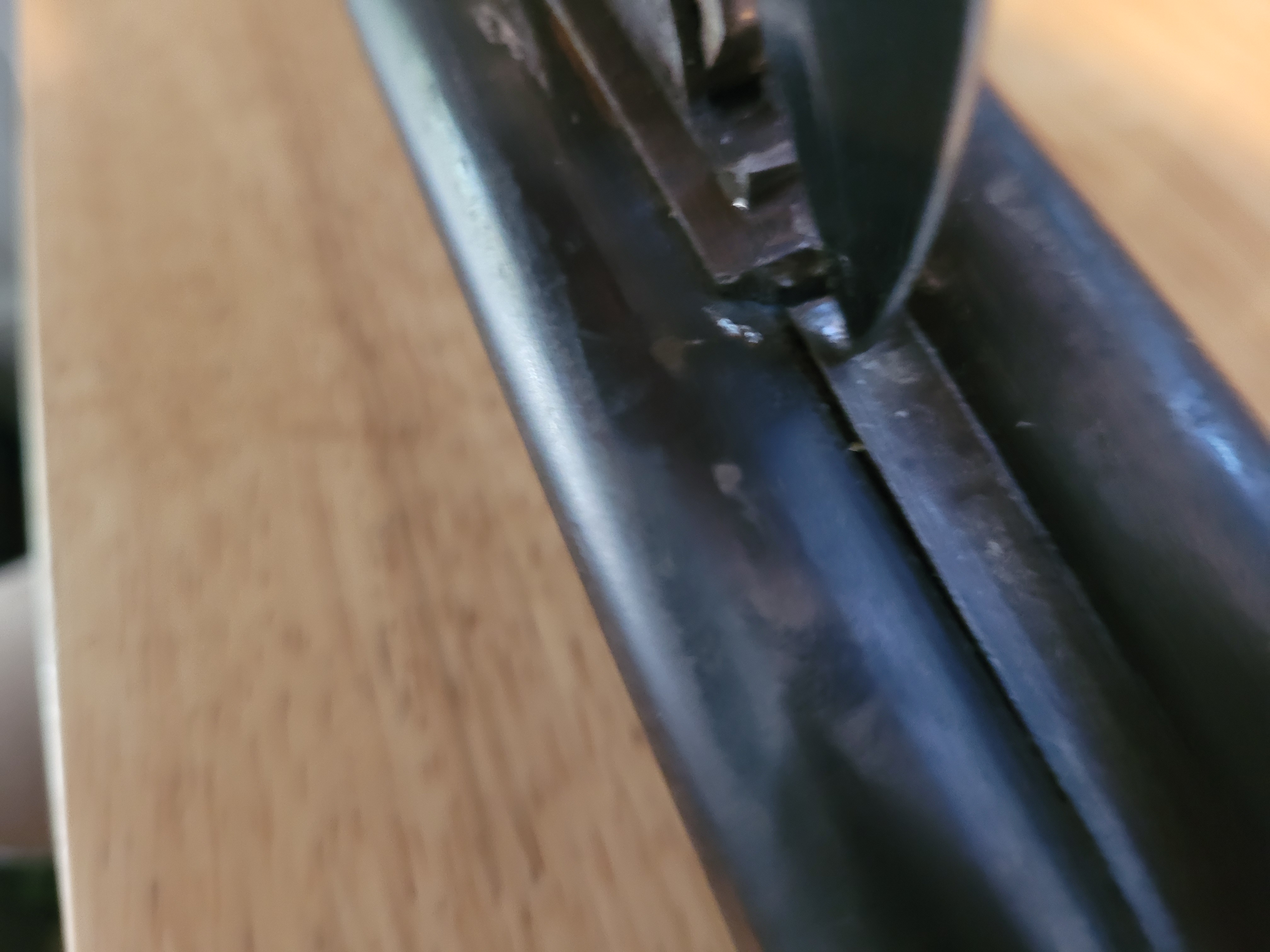

I had a little time today to fool around a bit so I dug into the wood dowel repair at the fore arm loop. It looks like the bottom rib was bent over into the channel between the barrels and then the wood janbed in there in was in there good but I got it out. There did not appear to be any significant rust at least what I could see. The forearm loop is super loose and the short rib is popped up at the loop end. All in all though nothing to make matters worse as far as I can tell.
I do have one question though. There is a fastener that goes from the top of the top rib down through the loop. Is this a pin, screw or not original?
