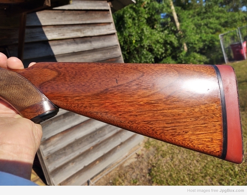

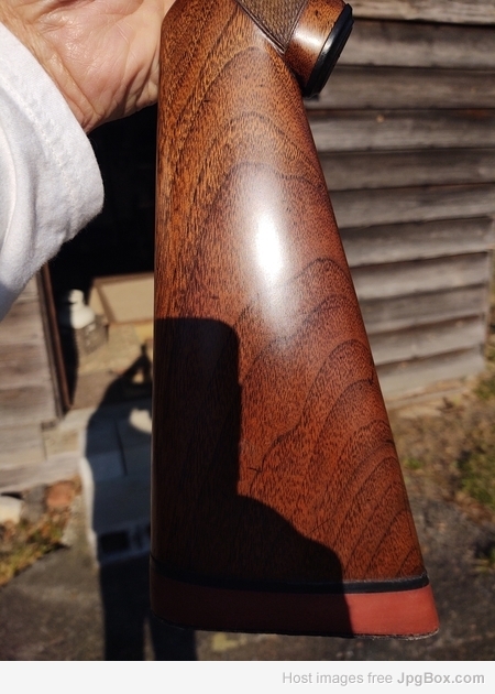

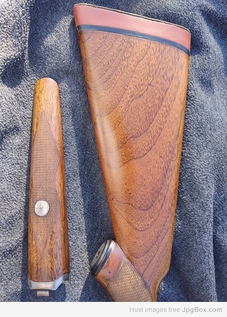

Here are a few pics I hastily snapped this afternoon. I failed to do it justice somehow, as the pics do not convey the depth of the finish. This is the thing that has so impressed me about this method ......... how it takes a plain piece of walnut, with little to no figure, and makes it look so pleasing. When done properly the wood takes on a holographic effect and when moved slowly, upon viewing, the appearance seems to change. It's like you are looking INTO the wood. Anyone can look up Pilkington's method of sanding in the finish, with 320, then 400, then lastly 600 grit wet/dry paper. The process completely fills in the pores and produces a finish as slick as glass, without the high gloss. More gloss can be added, but I prefer the low gloss sheen.
What I use for finish is a duplicate of what Pilkington used to sell as his Classic Stock Oil Finish. It consists of a 50/50 mixture of pure Tung Oil and Ace brand Marine Spar Varnish, with a tiny amount of Japan Drier added. Pilkington's finish, that he sold, had pure marine spar varnish in it, but the Ace brand has a little tung oil already in it, so the Japan Drier is needed to promote speedy drying of the finish. If anyone tries and cannot find the sanding in process, per Pilkington, let me now and I will copy it for you.

Thanks Stan, that is a wonderful looking finish and should be easy to maintain. Is Japan drier easily obtainable? I've heard of it but have never seen it.

Love the leather faced pad. Guessing that was glued on.

Thanks Daryl. Yes, Japan Drier is sold in hardware and paint stores. A friend in MT taught me this finishing method and it was he that worked out the recipe with added Japan Drier. When in use we mix 1/4 tsp. of the two part finish with 1/2 tsp. mineral spirits. Then to that we add three-four drops of Japan Drier, according to the relative humidity.
Tom, that leather faced pad has special significance to me. The leather was cut from my grandad's old duck hunting coat. Brings back wonderful memories.

Stan, thanks for the tips. Your stock looks great and I love the sentimental touch to your pad.
