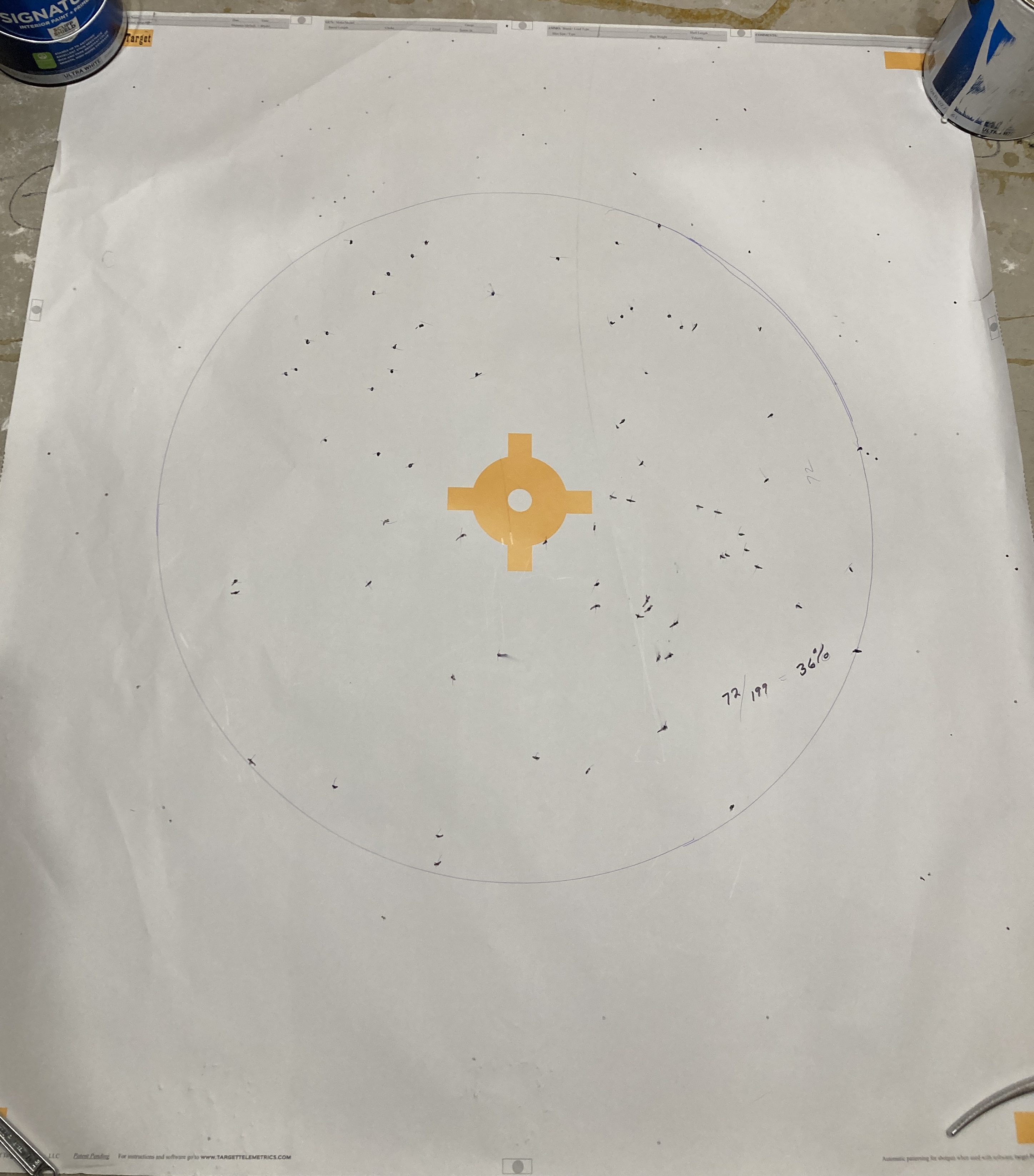

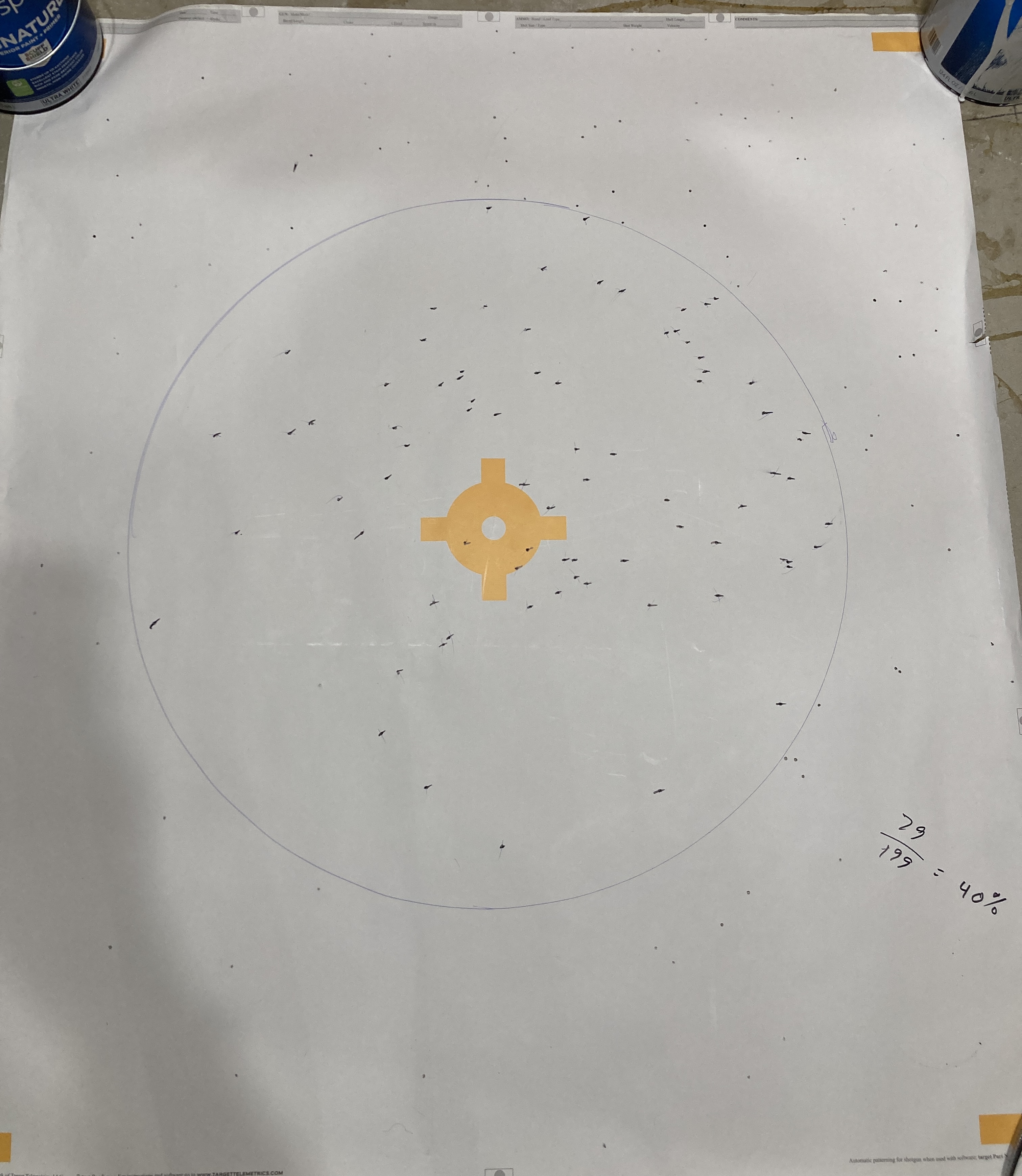

Friends and colleagues…. One last comment regarding my experience with Boss ammo. As mentioned above, Craig shipped me 2 rounds of Boss 2 3/4”, 1 1/4 oz #5 copper plated duck loads (with fiber wads). Considering the price of ammo, and the hassles of shipping, this was very generous. Thanks Craig.
Yesterday, I took two shots using my Super Fox, right barrel choked at .048”. I was excited to give these shells a try because they worked pretty good in Craig’s gun. Unfortunately, they did not work for me. First, I did not empty a shell to count pellets. The Boss website says 238 pellets. Craig counted 199, so I used Craig’s count.

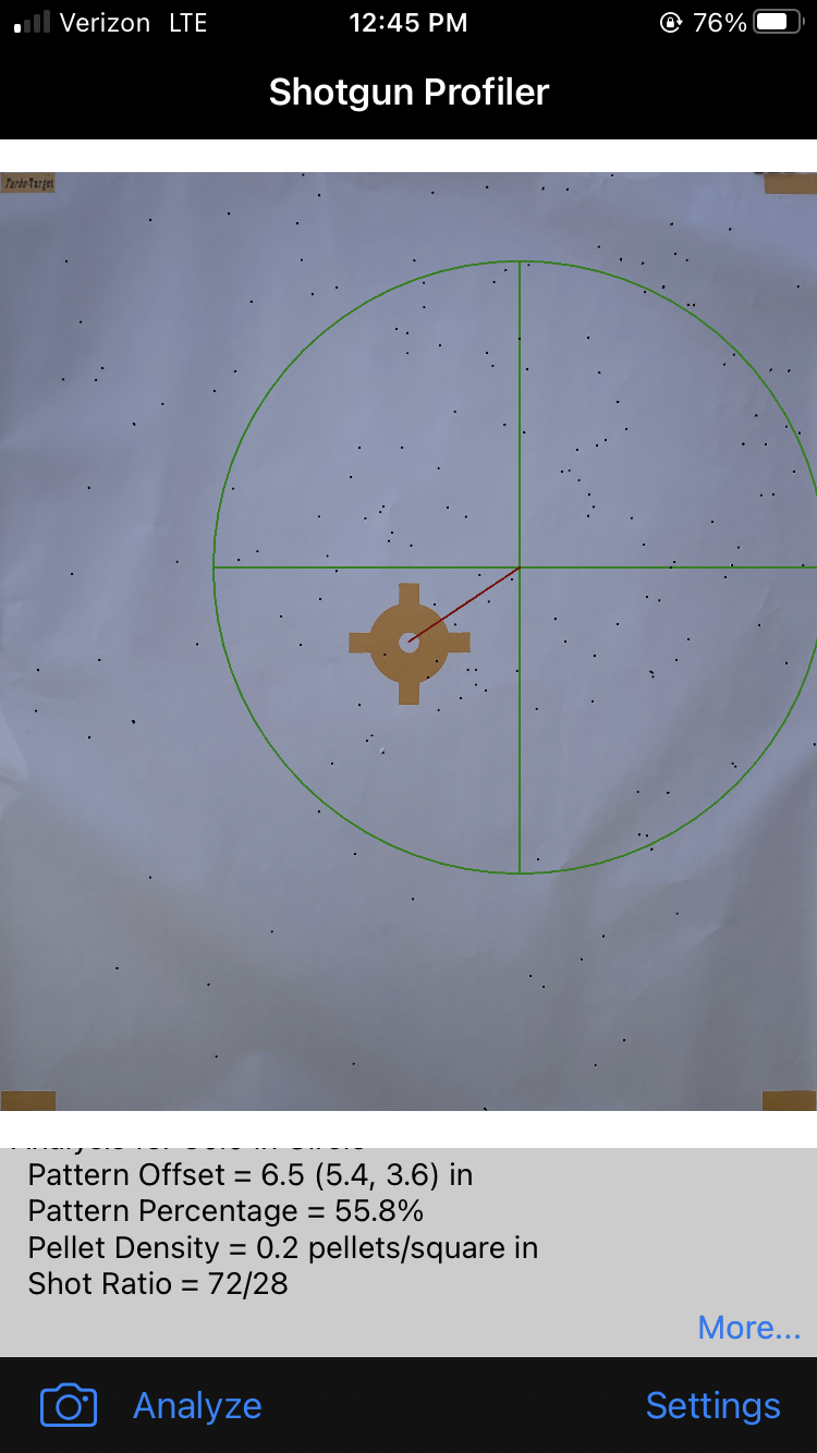

My first shot put 36% in a 30” circle at 40 yards. My second shot put 56% in the 30” circle at 40 yards.

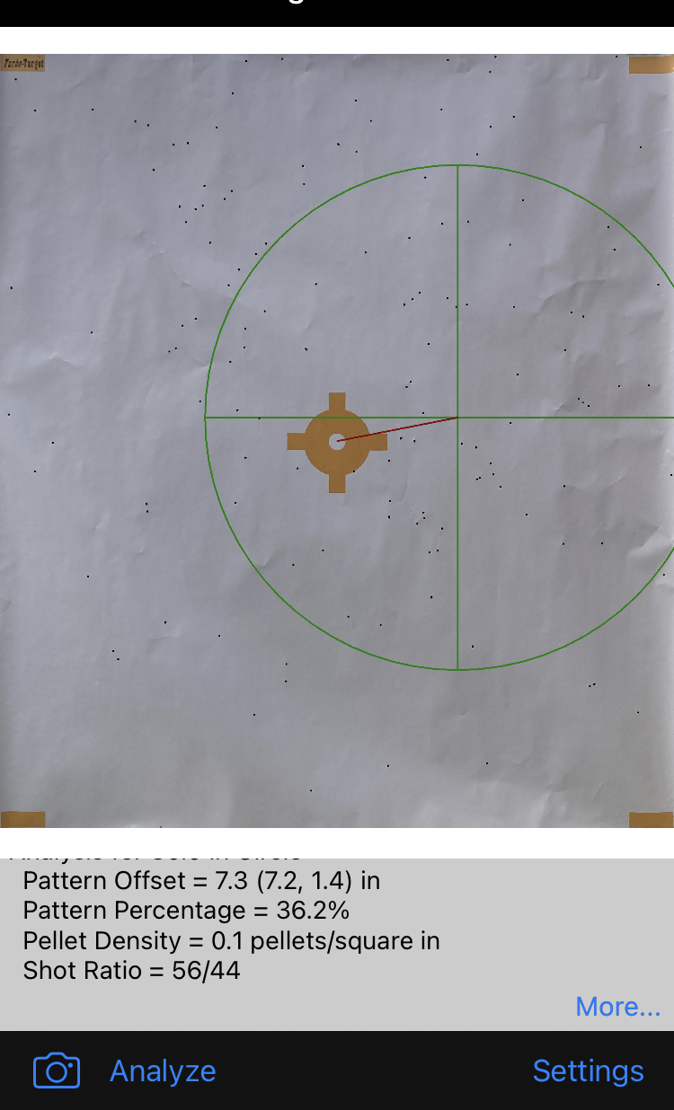

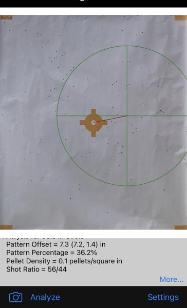

As some of you know, I use a patterning software stored in my phone. One of it’s features is that it “corrects” or “determines” the center of impact and then creates the 30” circle. I like this feature because compensates if my aim is off dead center. Some of you may disagree. Okay, so after I used the software to analyze the pattern, I simply drew a 30” circle and counted the pellet holes. Using the “traditional” method I had patterns of 36% and 40% respectively. Incidentally, I did NOT find any fragments in my hardboard back stop as I did last time. Once again, thanks Craig, and I look forward to further discussions while at Hausmann’s. Jeff

Thanks Jeff: Crazy such a difference in two very similar barrels. If I had "corrected" my patterns for center with your software I it would have improved my percentages. My SF had very few flyers, they were just outside the 30" circle.

What is the name of your patterning app?
- Posts: 3838
- Has thanked: 2903 times
- Been thanked: 1818 times
Re: Pattern testing my SF with Boss,TM and Salt Creek ammo.
“Target Telemetrics”. I’ll be having dinner with one of the creators in about an hour.
