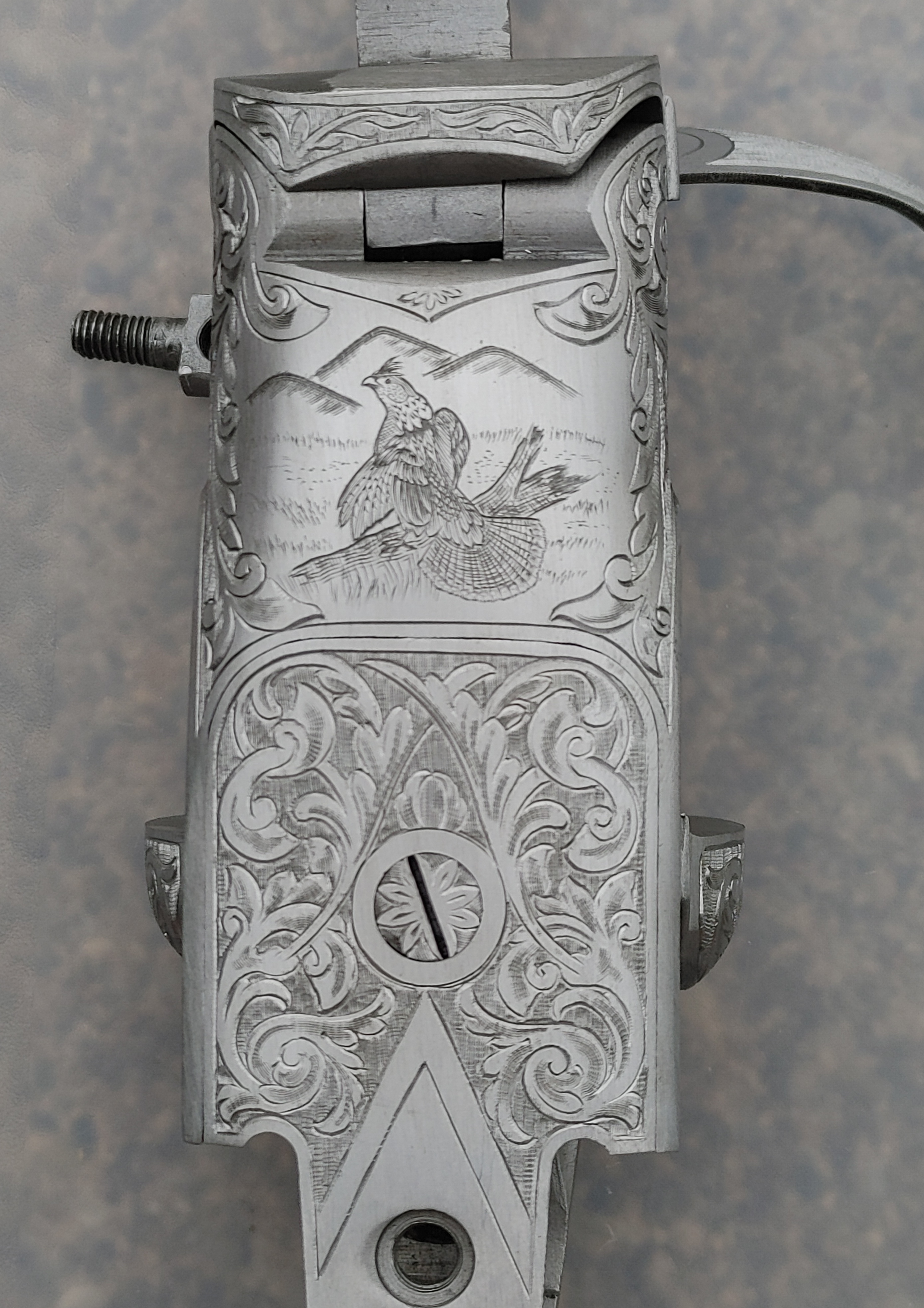

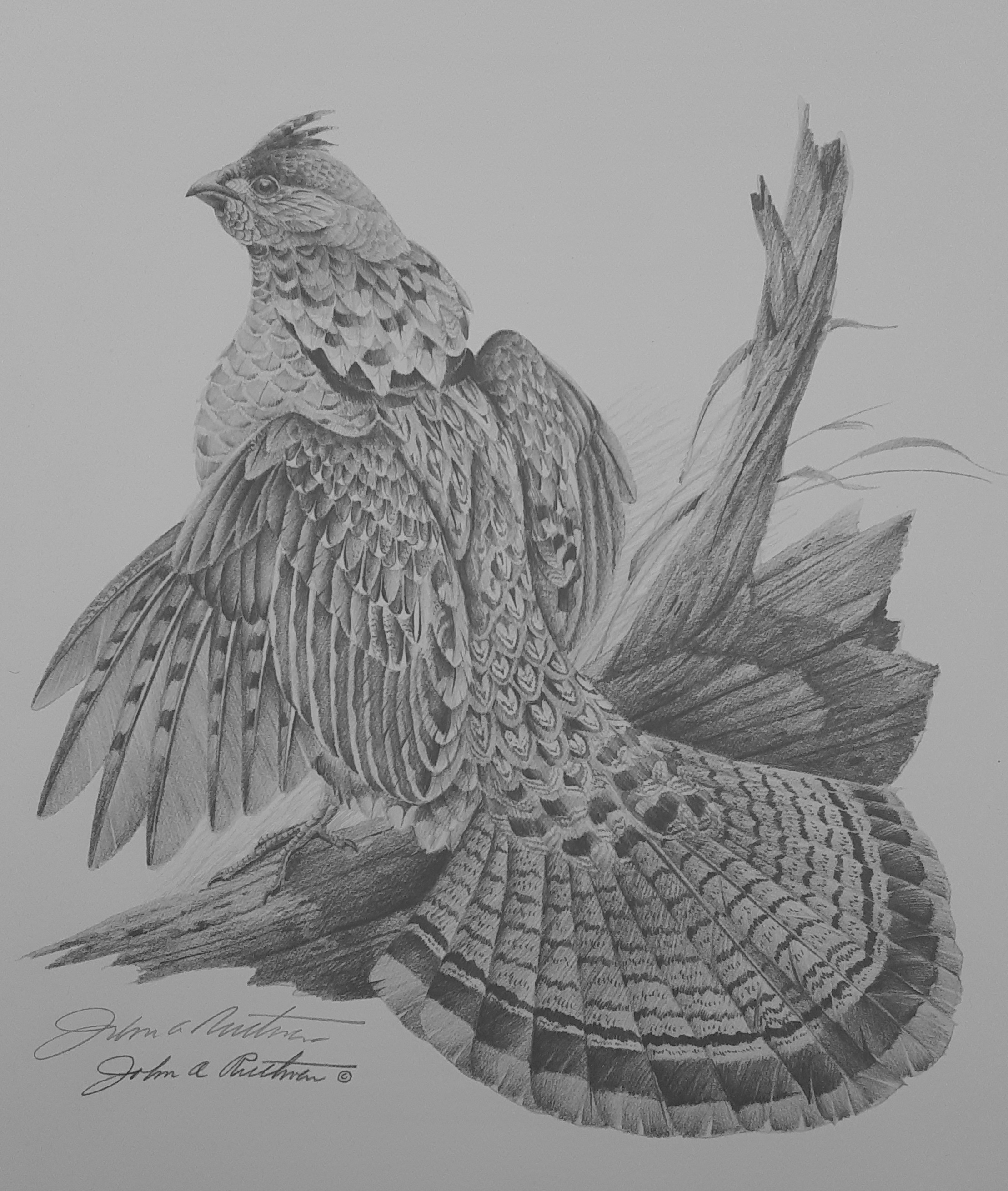

Moving forward, I reached out to Mr. Gournet at the NE SXS this year and we talked about the project. I also told him since it was an upgrade I wanted a Grouse on the bottom of the receiver and not a flying Grouse but rather a drumming Grouse. He asked me if I had a picture and I provided him some prints that were provided at a Grouse banquet in Ohio in the 1990's as I recall that I had purchased. They had been signed by the artist who was at the show. Attached is that pic that I provided to Gournet and also the almost finished engraved receiver pic that he provided to me over the weekend. I think when all is said and done, it will be a nice gun to chase Michigan Grouse and Woodcock with as we no longer have Grouse in Virginia.

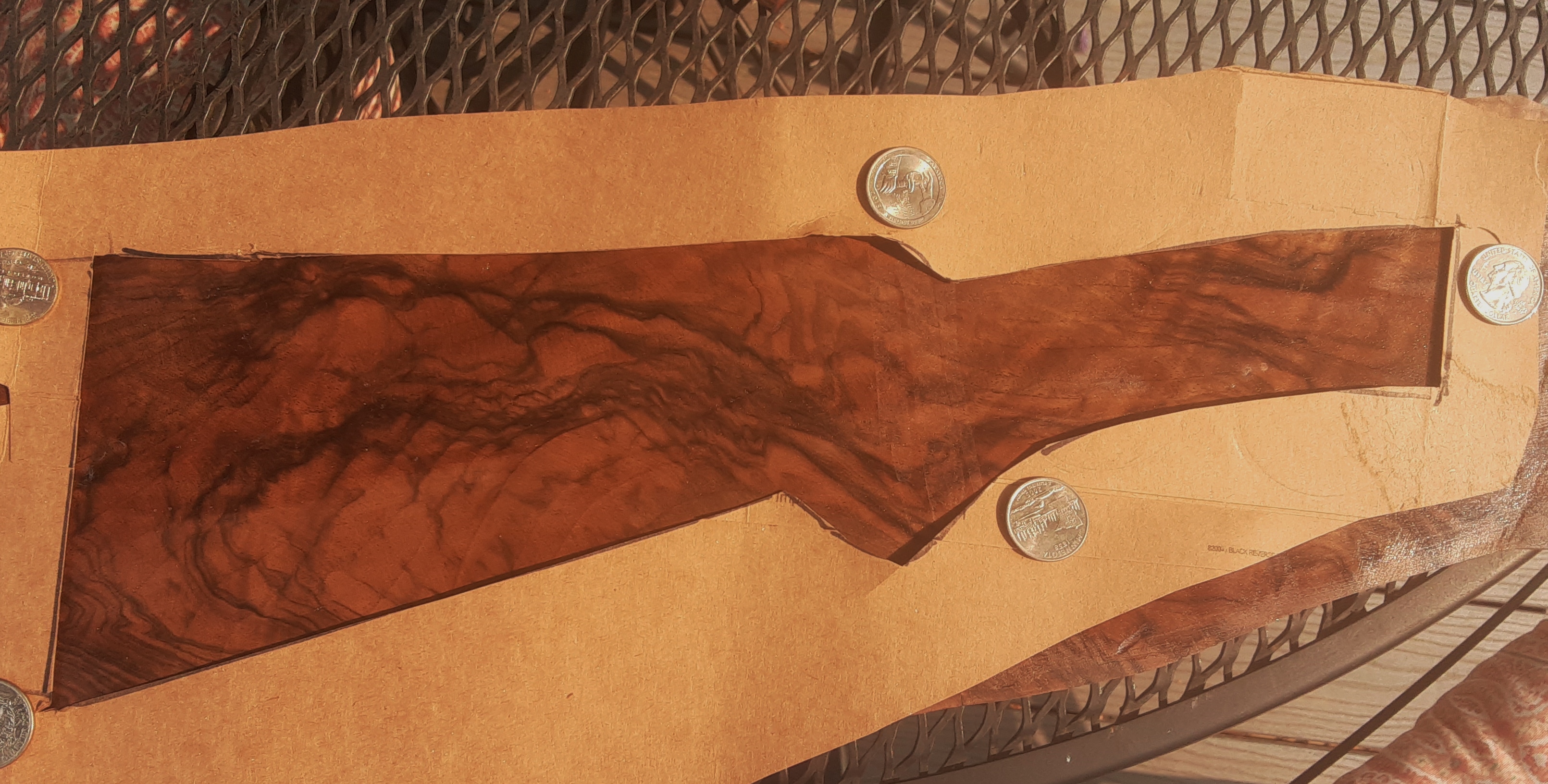

The blank on the bottom is what is being used. IMO pretty period correct. It matches quite well on both sides and is laid out correctly per the stockmaker. PS. both sides shown.

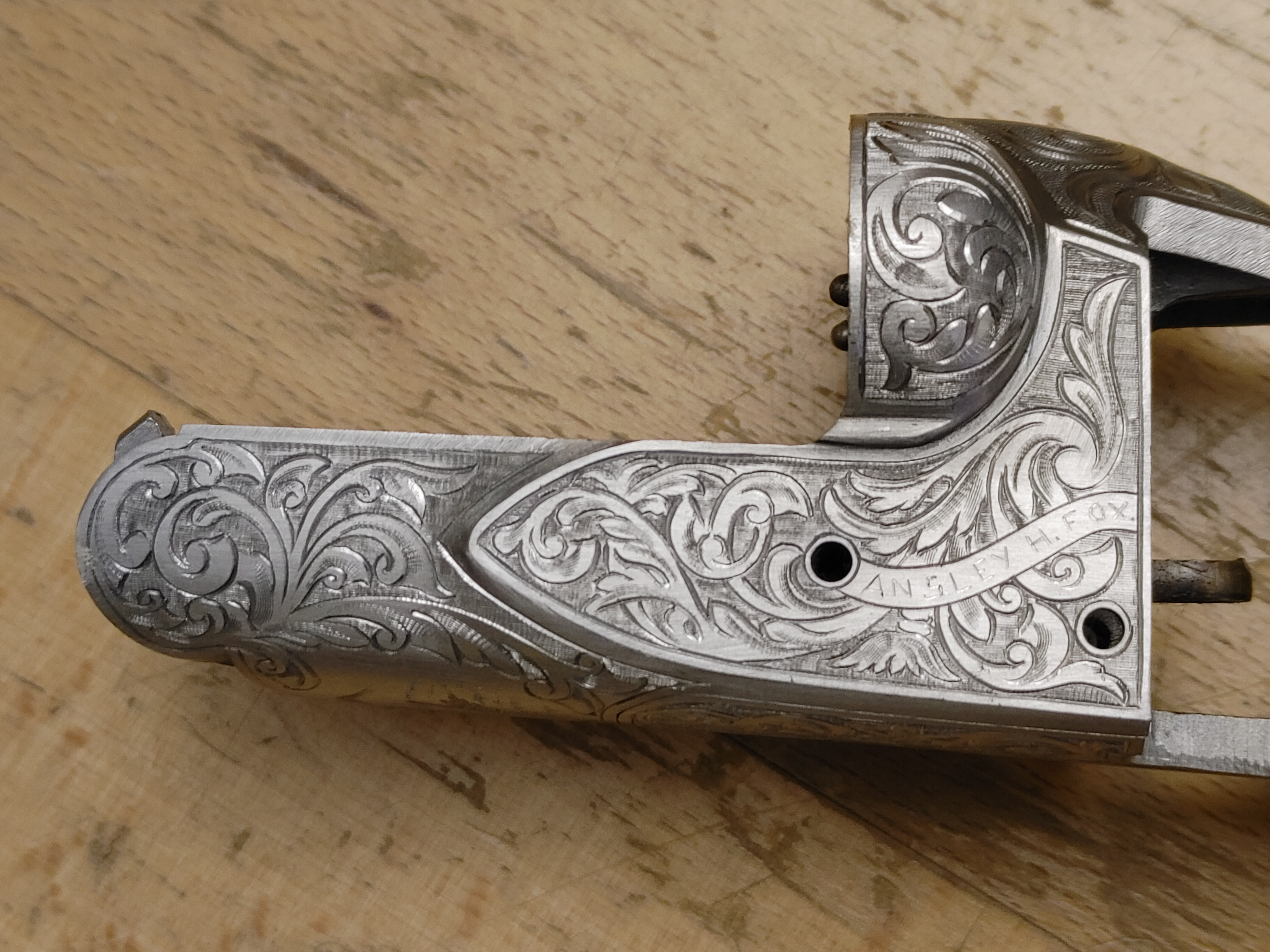

Done. Gournet has completed his part and is sending it back to the stockmaker. Here tis the finished frame.
