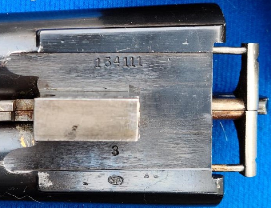

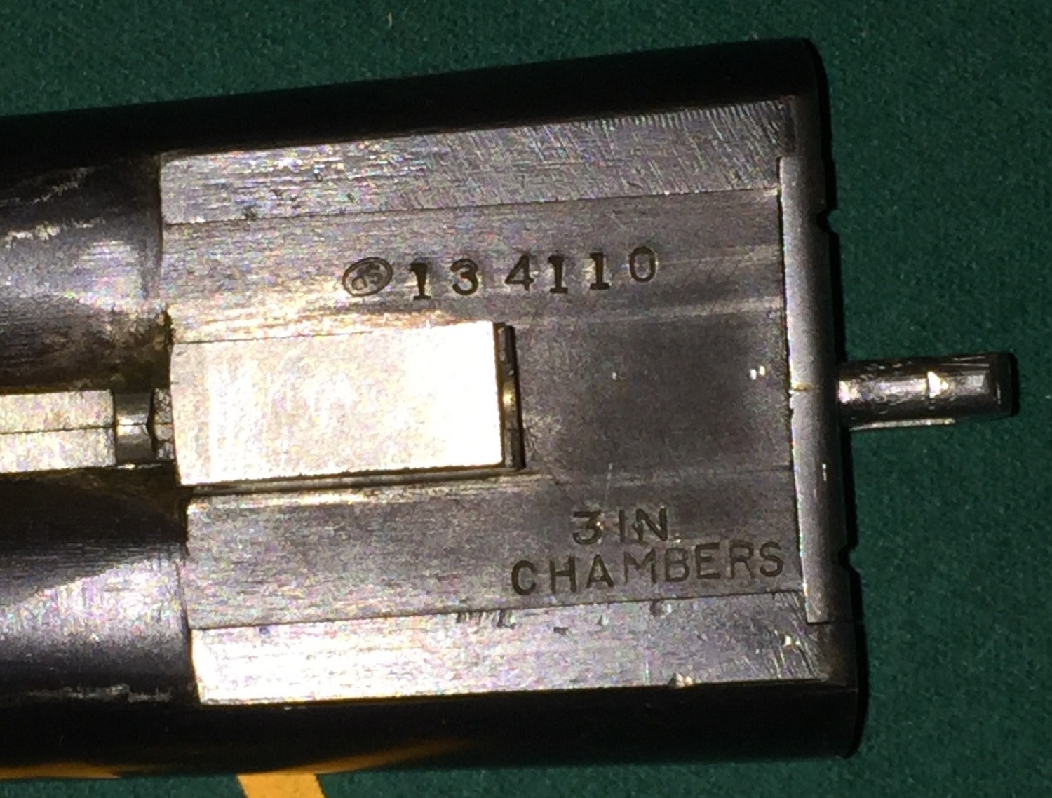

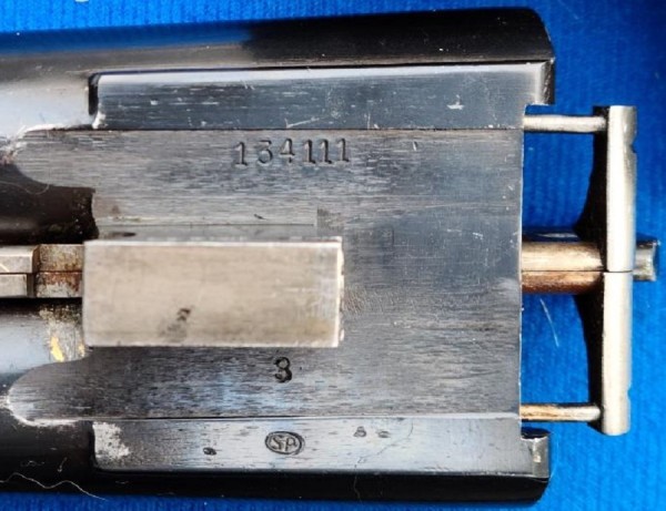

Here are pictures of the regular style Wildfowl barrel flat and 134111 for comparison --
Note the different font for the serial numbers.
The other Wildfowl barrel flats I have pictures of are similar to 134110.

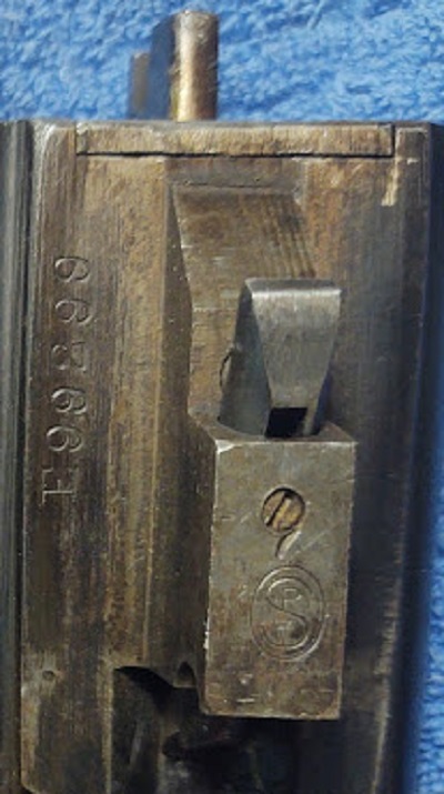

I know I have a picture of a Fox barrel with the Stevens Proof Tested stamp somewhere, but can't find it right now. The Stevens mark is a larger oval with a big S in it with smaller P and T within the loops od the S. Here it is on a J. Stevens --

Interesting pic with the two barrel flats.
