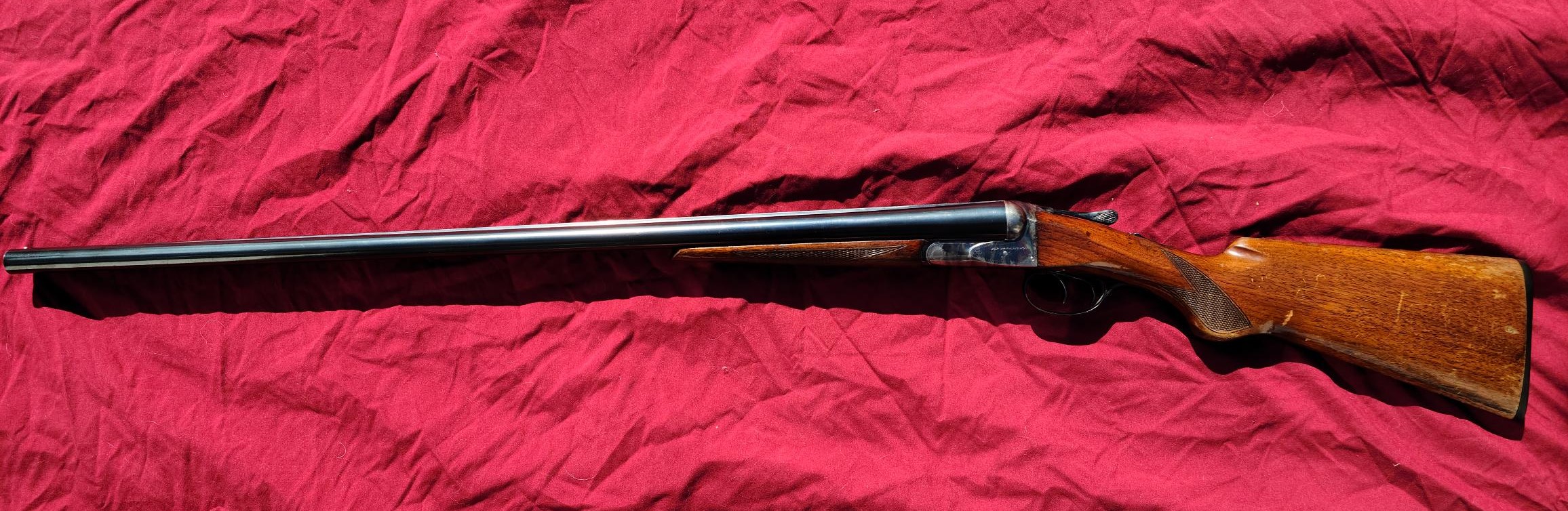

Sorry for reviving such an old thread, but I came across it while looking for info on a Wildfowl i just bought. Mine is 134111, just one off of Foxnut's 134112. It has the standard butt plate. Does the wood looks to be standard for Sterlingworths for the time?

Re: Fox Sterlingworth Heavy barrels (HE weight)
NorthernBob,
Yes the wood appears to be of the standard Sterlingworth style and finish of that era w/the capless pistol grip and finish. Very nice gun. Nice catch. When I get a chance I’ll post a pic of one of the guns from the other batch that Frank mentioned in the post.
