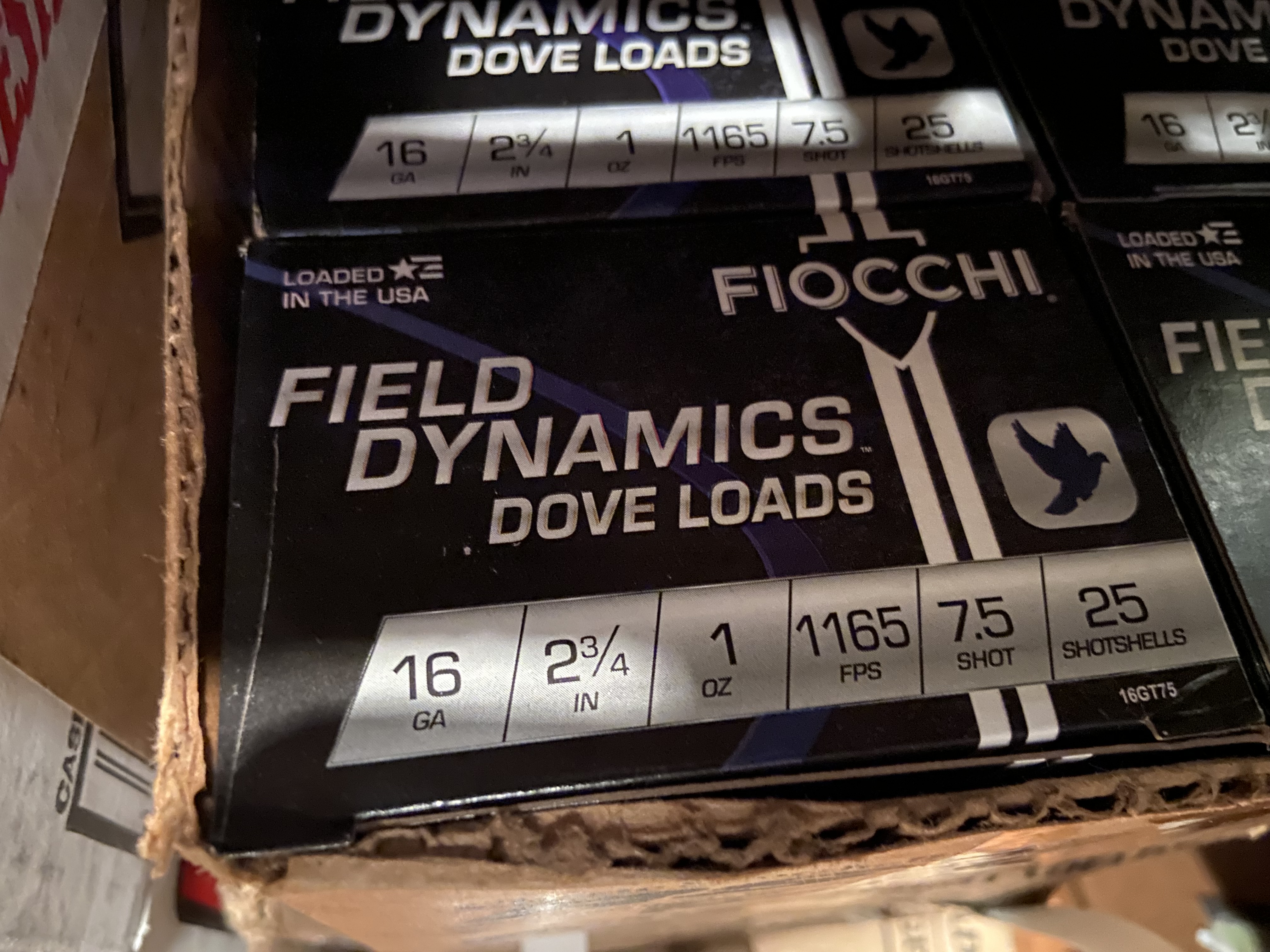

Here are the 16 Ga loads I was thinking of using.

In my humble opinion your choice of load as pictured would not concern me, to use in your gun. I use similar loads, in my 2 3/4" chambered Fox guns, regularly.
But, only you can make that decision, based on your knowledge of the particular gun.
