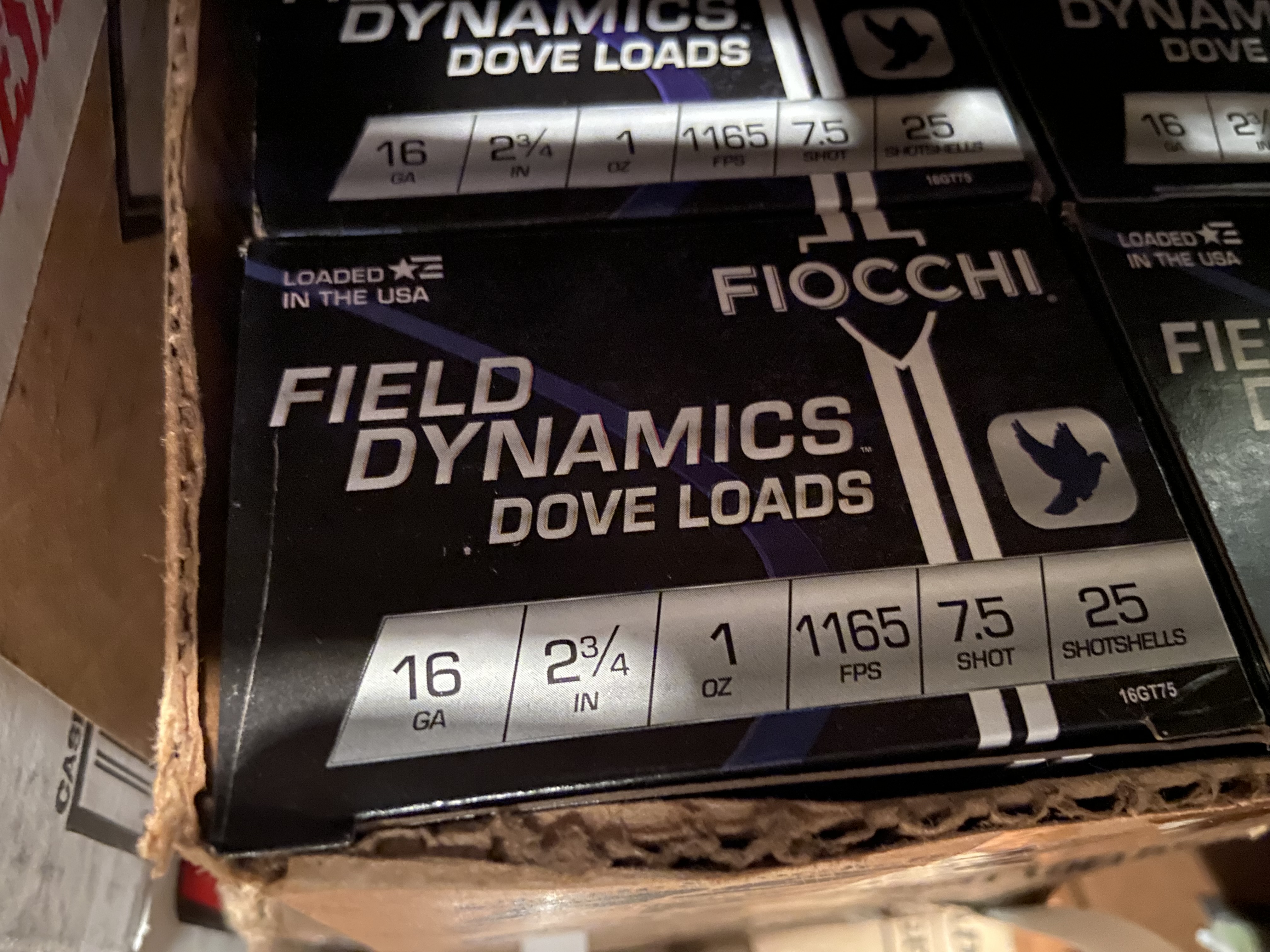

I have a 16 Ga Sterly Philly gun that at some point went back to the factory and was rechambered to 2 3/4 and so stamped. I had Hosford measure the barrels and the minimum wall thickness was .030 and .039. Those seem pretty respectable to me based upon what I’be been able to read. Would you be concerned about using reasonable 2 3/4 loads out of this gun?
The same gun also has a 20 Ga barrel set with 2 3/4 chambers (not factory stamped) with minimum wall thickness of .035 and .041 which again seem reasonably thick to me. Same question would you have any concerns with reasonable 2 3/4 loads in the 20 Ga set?
Here are the 16 Ga loads I was thinking of using.

In my humble opinion your choice of load as pictured would not concern me, to use in your gun. I use similar loads, in my 2 3/4" chambered Fox guns, regularly.
But, only you can make that decision, based on your knowledge of the particular gun.

Those are plenty thick IMO. There are many original Foxes with 4 weight barrels that are unmessed with and they are often found at less the .030 MBWT.
