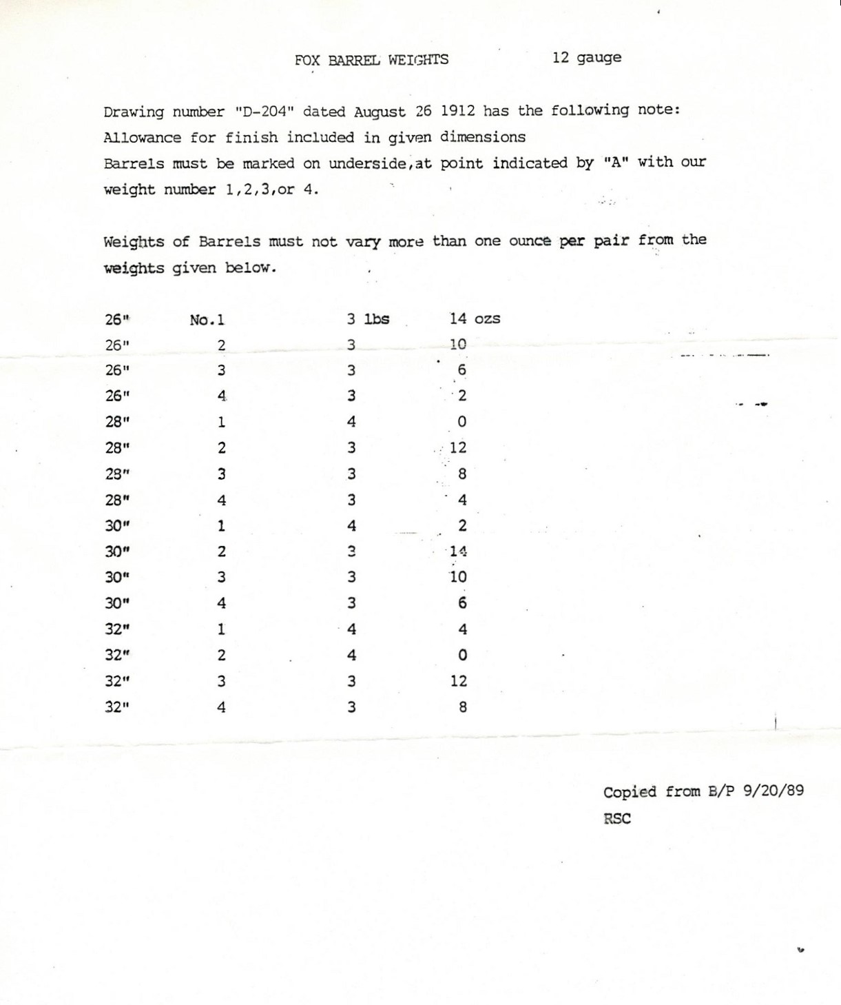

Fox barrels in the rough were broken up in to four weights from the heavier 1-weight down to the lightest 4-weight.
There were also the 0-weight barrels for the HE-Grade Super-Fox.

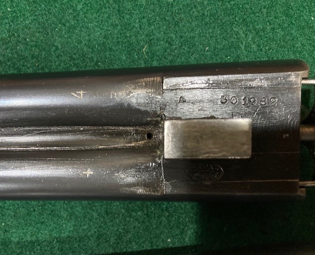

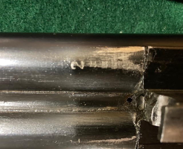

Larry, remove your barrels and look for a number stamped on the underside that looks like this. Sometimes it's still there, and sometimes the number has been removed during the striking process.

Dave kindly posted the 12-gauge "barrel-weight" and weight (mass) chart, and indicated that chart is for rough tubes. Let me emphasize that rough tube sets (barrels) will loose 2-4 ounces from the indicated weight (mass) when struck and finished.
As many here know there are barrel-weight/mass charts in MM's Fox book for 12-16-20 gauge. All too often and especially on another site fellas will write so glowingly how they have a penchant for finding Foxes with 4-weight tubes and how desirable they are, when in fact they often have 3-weights and are correlating with the rough/unstruck mass shown in the charts in the book. Me? I've found that true 4-weight barrels are typically too whippy for good shooting, and in a given Fox I'd much prefer 3 or even 2-weights versus 4's. A few ounces minus/plus on the front half of the barrels make a definite and discernable difference in swing dynamics. JME. frank

I'm a big fan of the 3 weights as well. FWIW, I had Jon Hosford measure a couple of sets of 16 gauge 4 weight barrels for me at the NE or Southern last year (Can't remember which frankly) and they were pretty darn thin as far as minimum barrel wall thickness. I passed on a very nice 16 AE for that reason that I was prepared to buy. FWIW, many and I many of the dealers don't provide that measurement, so its up to you to do your own research. Jon Hosford has helped many others as well. That's money well spent IMO.Silvers wrote: ↑Thu Jan 19, 2023 7:44 am Dave kindly posted the 12-gauge "barrel-weight" and weight (mass) chart, and indicated that chart is for rough tubes. Let me emphasize that rough tube sets (barrels) will loose 2-4 ounces from the indicated weight (mass) when struck and finished.
