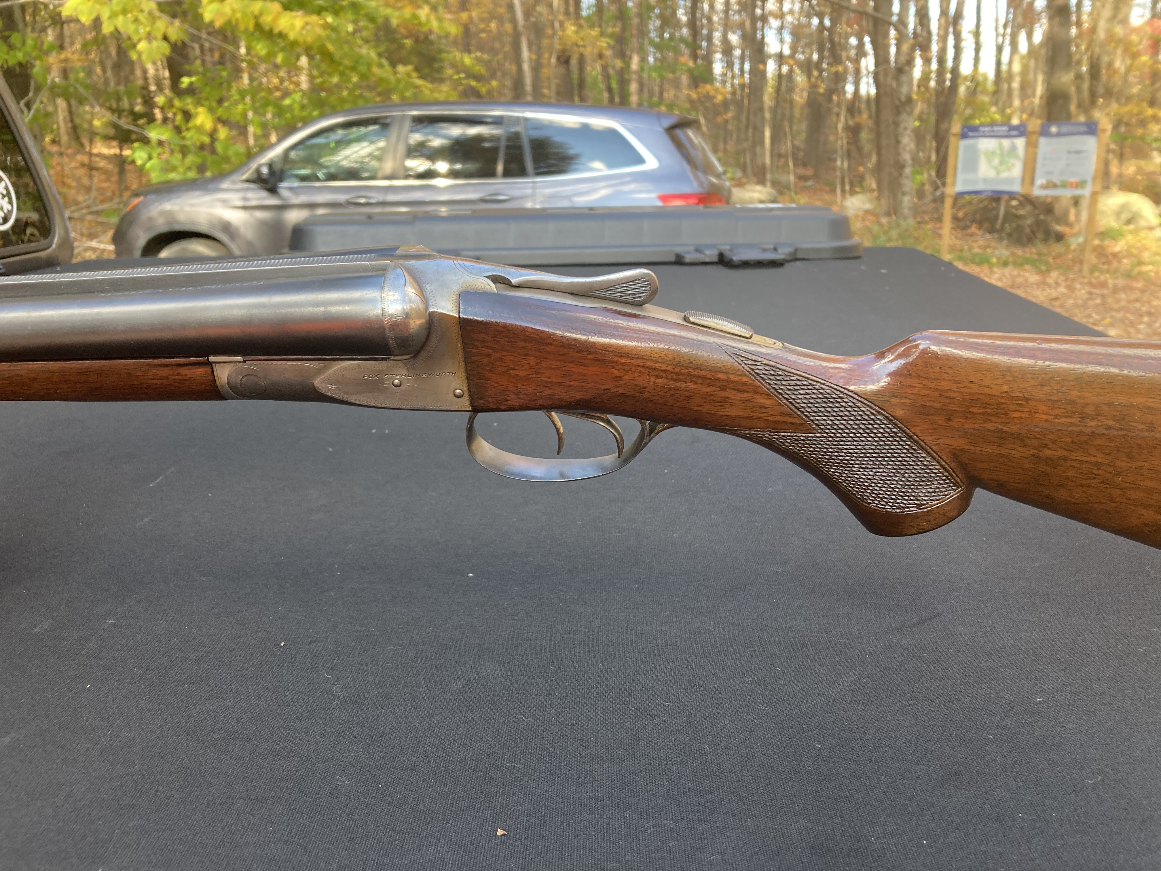

I’ve been looking at local shops and online for some time now. Just pulled the trigger on a 16 ga sterlingworth. I always remember hearing about my grandfather’s friend owning a 16 gauge fox and going up to NH looking for partridge back in the late 50s early 60s. Have been intrigued by the American classic ever since.
This one seems to be in okay condition, hopefully good enough to use for pheasant for the short 6 weeks per year the season is open. I was wondering what the print on the action “fox sterlingworth” as opposed to the many I’ve seen that read just “sterlingworth”.
Any input, good or bad on the few pictures below would be appreciated!

The Savage made Sterlingworths were usually marked "Fox Sterlingworth" while the earlier Philadelphia SWs were simply marked "Sterlingworth." Savage bought the A. H. Fox Gun Company in late 1929 and moved production to Utica, NY. Based on that serial number, your gun was made in 1934.

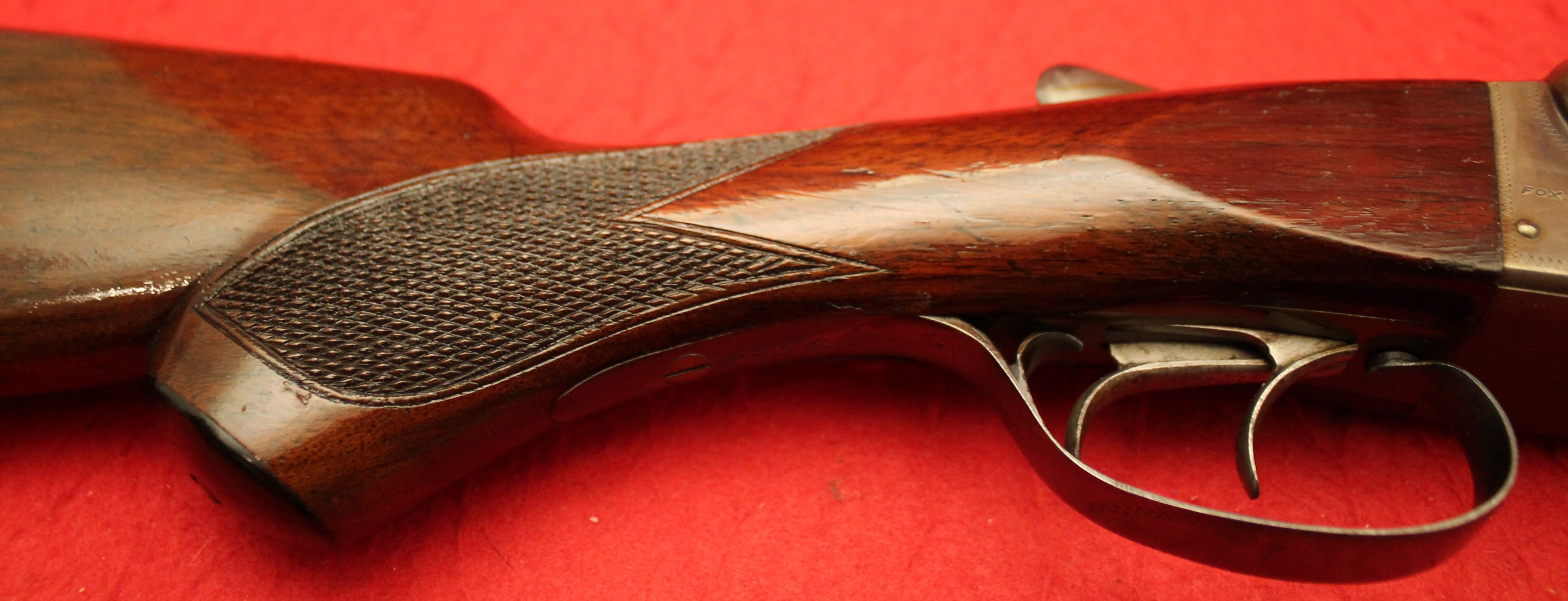

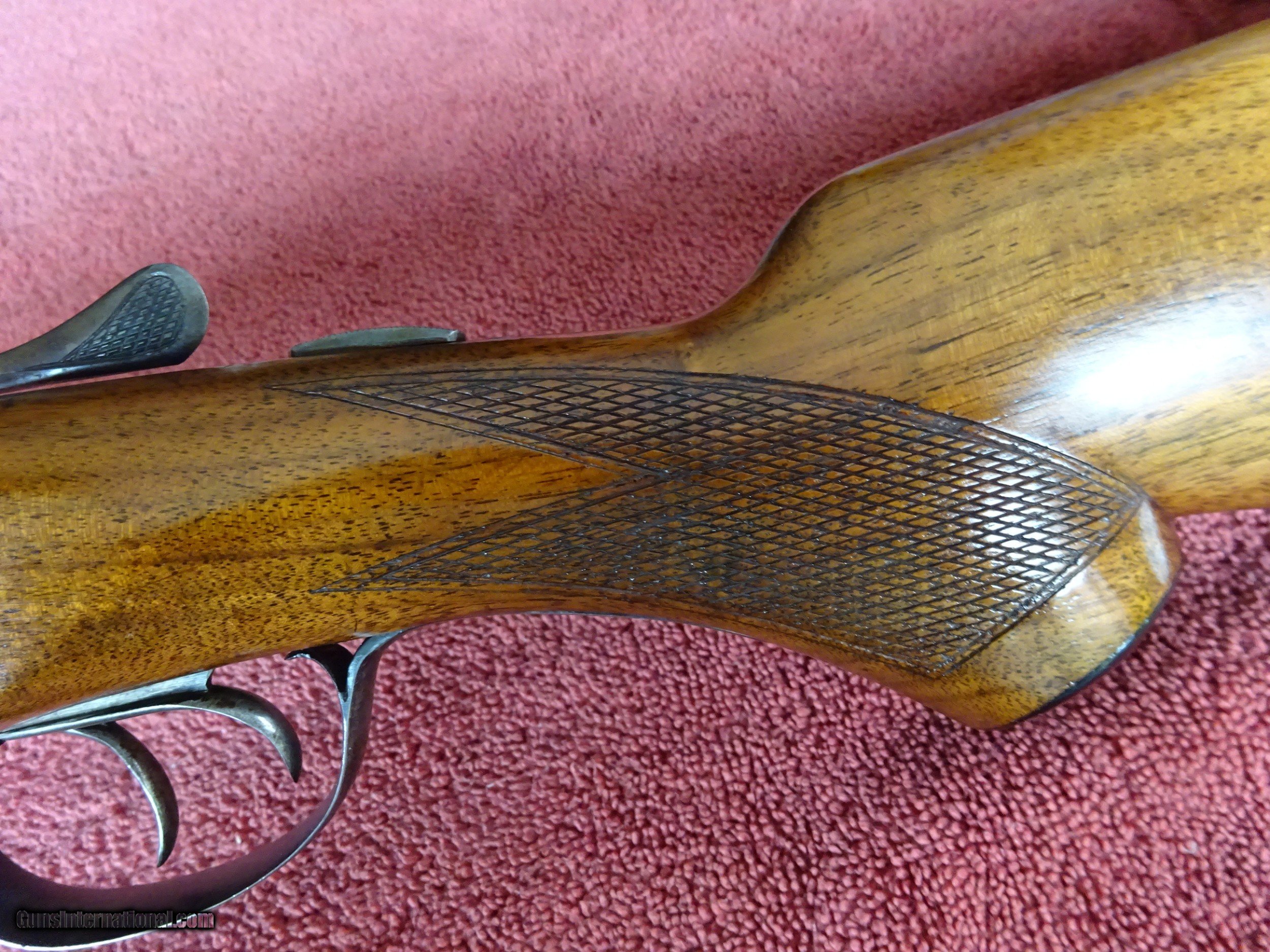

Nice gun. I'd be happy to shoot Pheasants with that gun. Are the barrels marked STERLINGWORTH FLUID COMPRESSED STEEL or SPECIAL ALLOY -- FORGED STEEL?
Your gun has the Philadelphia styled top-lever and safety slide but the bulkier Savage-style forearm wood. Also, Savage cut the checkering deeper with pointed up diamonds. Somewhat nicer than the Philadelphia era flat-topped checkering on the Sterlingworth --

A 16 gauge Fox is a wonderful bird gun and yours appears to have modern stock dimensions. Bobby

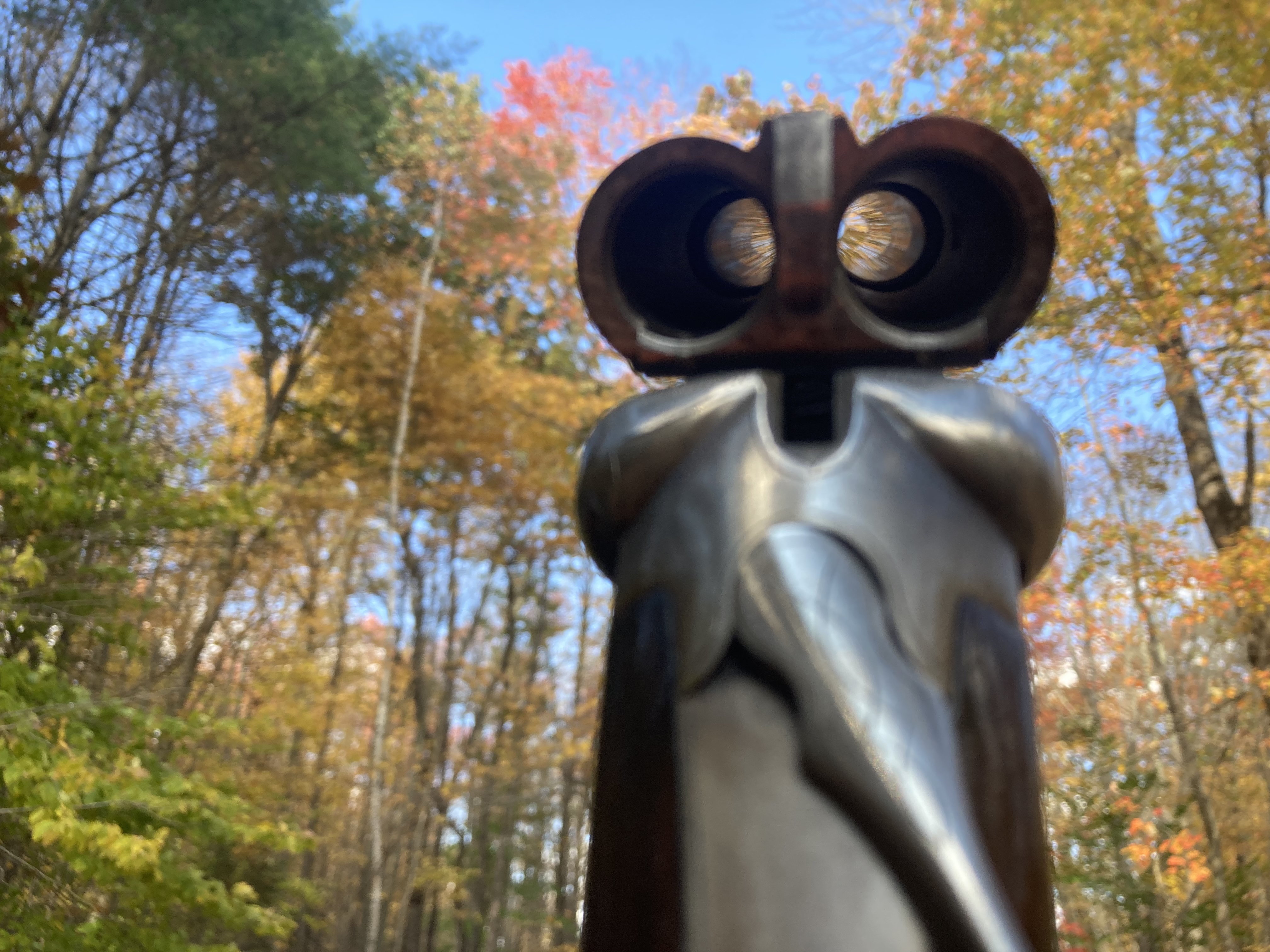

Gun arrived at the shop today. Seems to be in overall decent shape, less a pretty sloppy revarnish attempt. Some ran onto the action.
2 3/4 with nice clear bores.
A few more pics below. Excited to get it out and see how it shoots.
