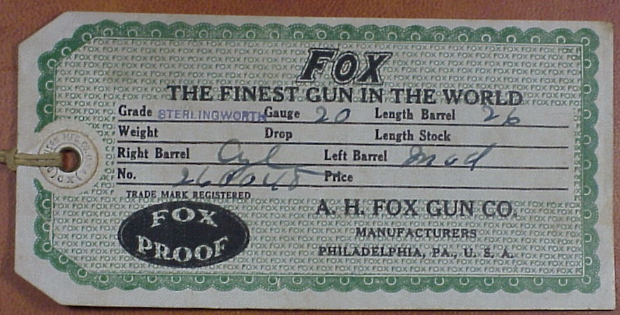

With the North American Nimrod's general "more is better" attitude these old guns probably saw plenty of Western Super-X, Peters High Velocity, Remington Nitro Express, etc. loads from the 1920s to the late 1980s. I wonder if our manufacturers began regulating their guns for those loads?
Early on the A.H. Fox Gun Co. hang-tags showed the load the gun was targeted with --
By sometime in the 1920s that disappeared --
