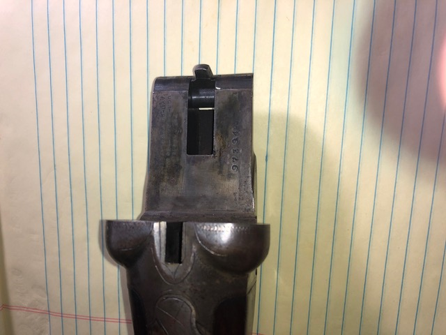

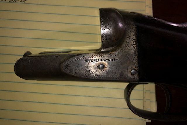

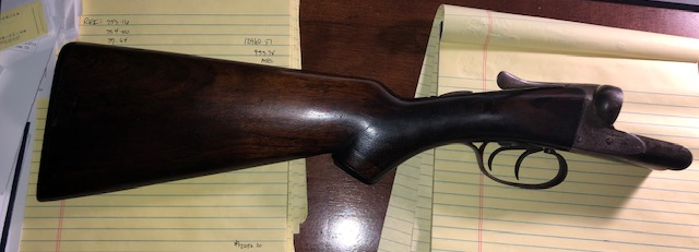

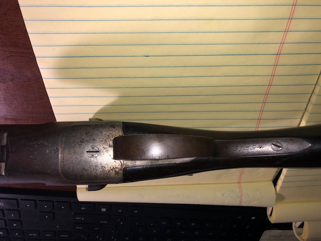

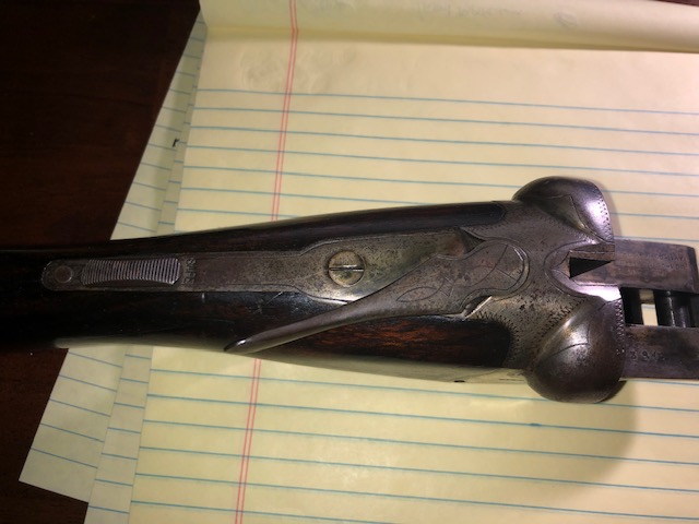

Good day everyone, truly appreciate the opportunity to share this with ya'll, thank you. I recently purchased a Fox 12ga and was looking for some help in determining what this Fox truly is. After doing some research, I've determined the shotgun was made in 1922, but other than that, I'm not quite sure what grade it would be. Any help would be greatly appreciated. I know she's rough, but I'm hooked.

You have a 12 gauge Sterlingworth gun there. The following will provide info on all the various grades they put out:
