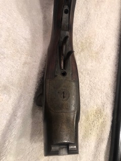

forearm, trigger guard, and most of the screws/bolts. bottom barrel rib is starting to delaminate

please see the pictures

Looks like a good candidate for restoration. It would be best to find an ejector forend (or at least a forend iron) that came off a Super. A f/e iron made for a regular Fox 12-gauge ejector gun could be made to work but would need expensive mods = been there done that on a Super that came to me without a forend. But even a complete f/e that came off a Super will likely require some work to get to fit and function on your frame. On the barrel rib, as you talk with gunsmiths almost all will want to sell you a total rib re-lay to include rebluing. Just based on what I see its worth a try to reattach that loose section and keep the barrels more/less honest. I've done a few of them now and none came loose. The balance of work needed looks pretty straightforward once you locate the parts. That missing main frame screw (under the break lever) might portend additional work needed inside the frame but you won't know that until disassembled. From what I see on the one pic, you're missing the hammer and sear pins and likely the hammer sears and sear spring.

if you're going to be missing parts - those are not the worst ones to have to find
that's all good advice from Frank
