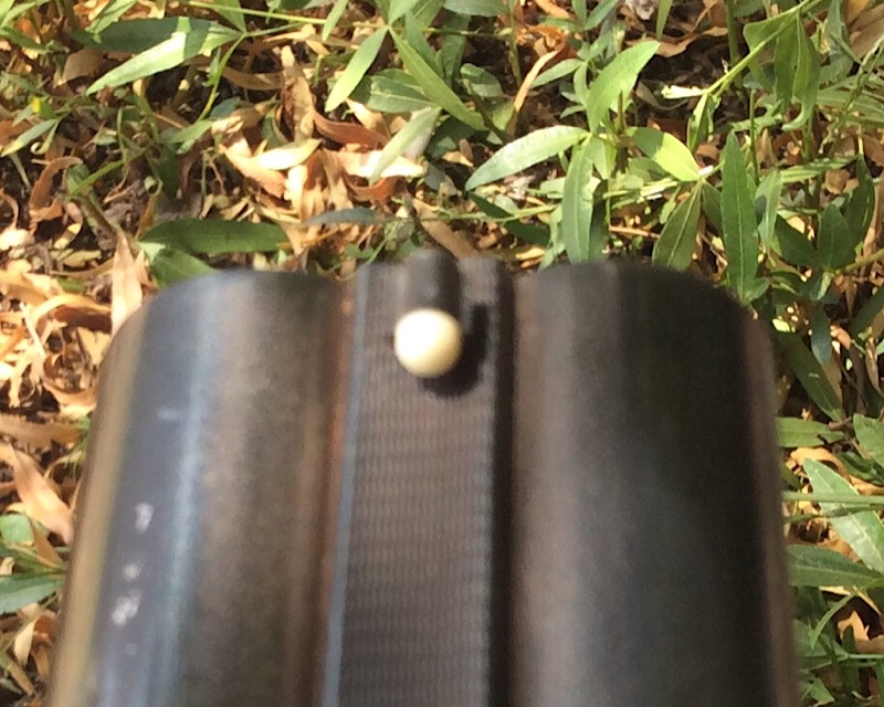

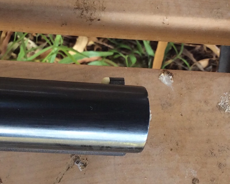

I looked at the Bead styles on the main page and there isn’t a style like the one on my 1923 Sterlingworth. I suspect there are more styles then depicted on the main page but would like to confirm. Here are a couple of pictures.

That is a non-original bead sight, Johnm11. It is a nice sight, but was probably not even being produced when your SW was built. What that is, is a Bradley style bead sight. The originals were just a bead, without the elongated section.
If you want it closer to original, you can buy an original A H Fox bead from Pumpkin Mtn Gunshop and swap it out. Usually an easy job.

Bradley sights typically have a threaded shank whereas the original Fox metal sight is a taper-fit (no threads). Your barrel rib has probably been drilled & tapped for the Bradley and if so you won't be able to revert to the original Fox sight without using an expedient like black-colored epoxy, holding the bead plumb/centered while the epoxy sets.
