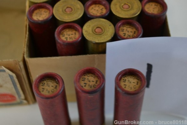

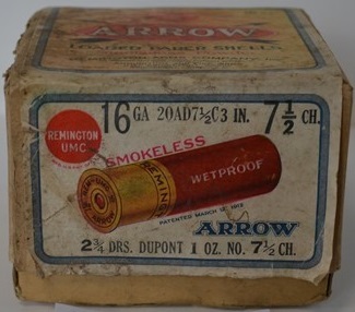

As I recall there were nine 16-gauge production cards that requested 3-inch chambers (one being our October 2013 Card of the Month) and one for 2 7/8 inch shells (April 2012 Card of the Month). A lot more 20-gauge guns were ordered chambered for long shells.
ARROW 16-gauge 3-inch 02.jpg (34.93 KiB) Viewed 9486 times

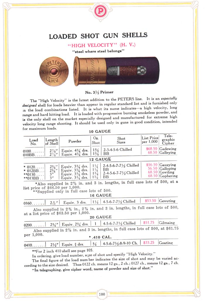

While I don't see extra length cases offered for their progressive burning powder loads by Winchester, Western or Remington, Peters offered to put their High-Velocity loads in any length case the customer wanted.
1927 Peters Cartridge Co. catalog
20-gauge 3-inch High-Velocity
20-gauge 3-inch.jpg (55.52 KiB) Viewed 9404 times

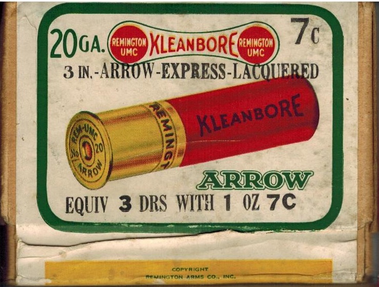

I've never found these Remington ARROW EXPRESS 3-inch 20-gauges offered in any catalog, but here they are --
20-gauge 3-inch ARROW EXPRESS
