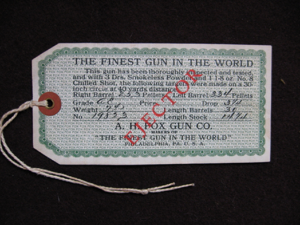

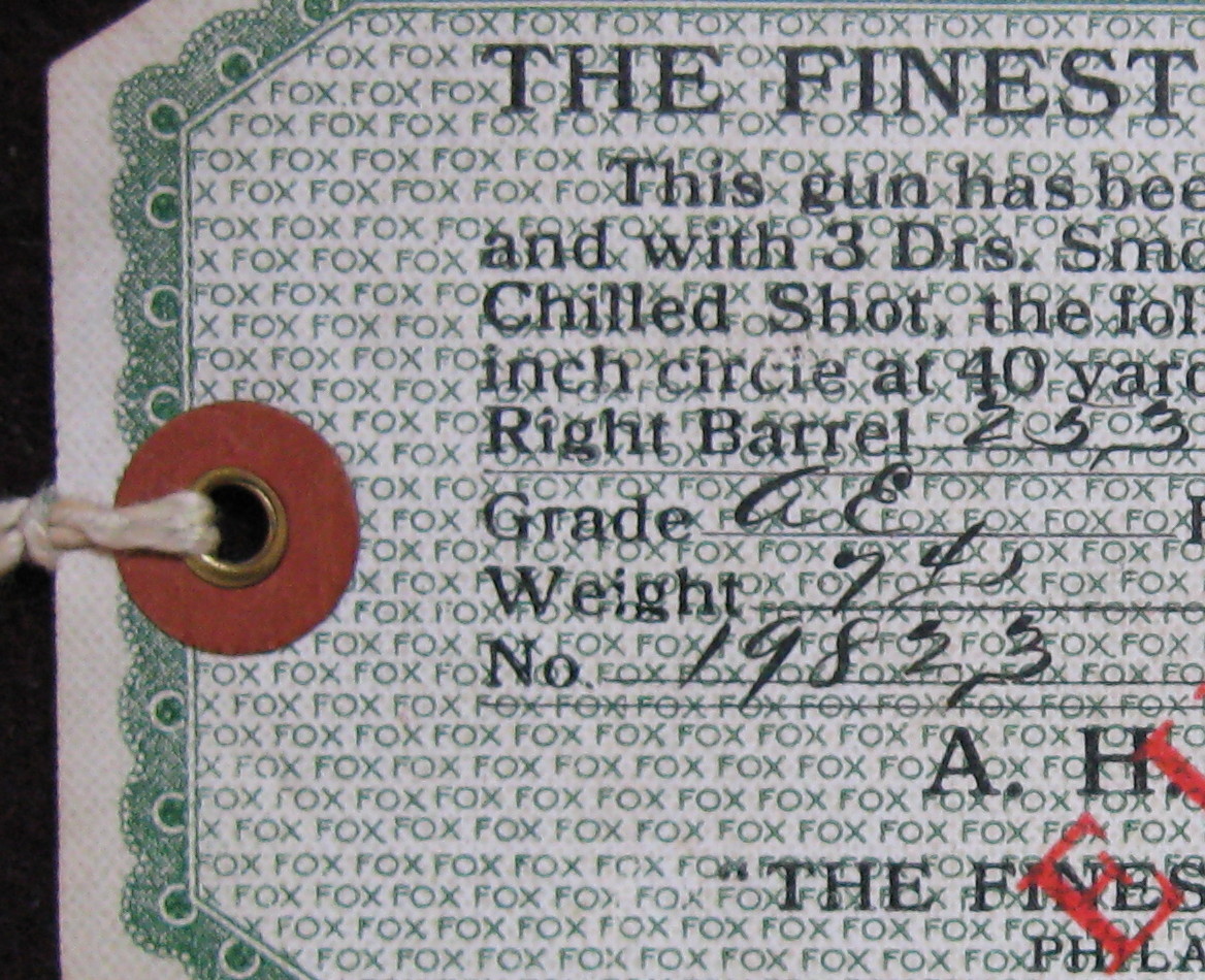

Not saying it is the case, but one needs to be careful a hang-tag isn't one of these repros off ebay --
http://www.ebay.com/itm/A-H-Fox-Model-D ... Sw311Zuwm5
The real hang-tags have brass grommet reinforcing the hole where the string attaches.

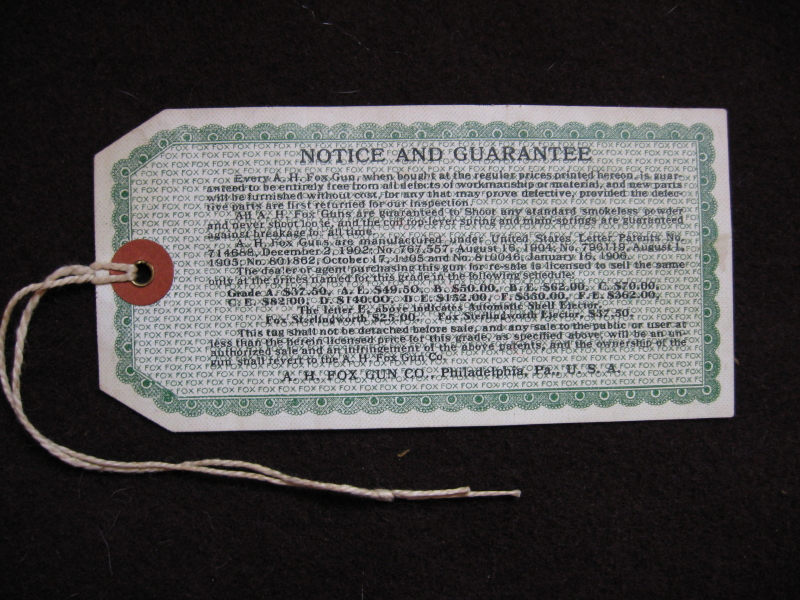

Here's some pictures of a genuine Fox Hang Tag . . . .
Front side of tag
Front side of tag
Close up of grommet reinforcing hole
Back side
Back side

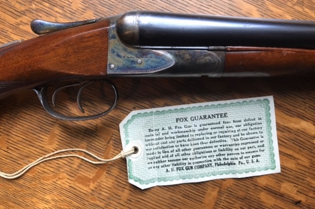

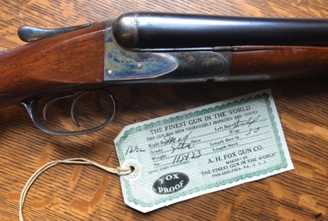

Amazing what I can find when I look in the right place!!
Looks like a very nice find.

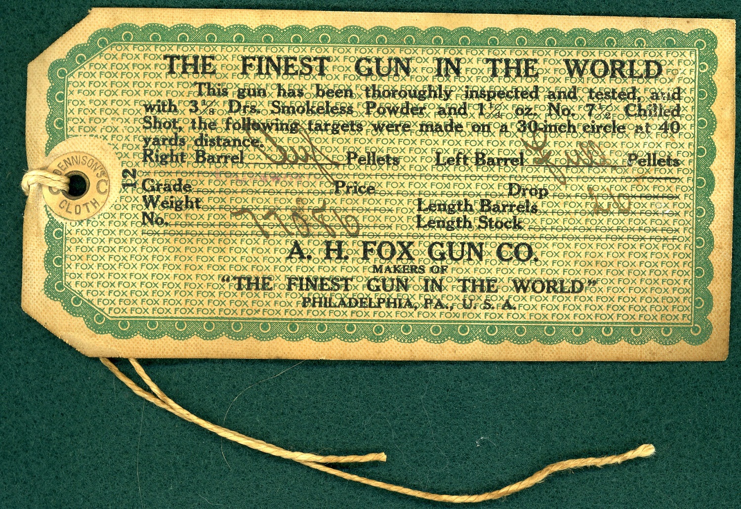

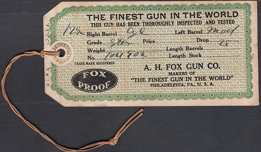

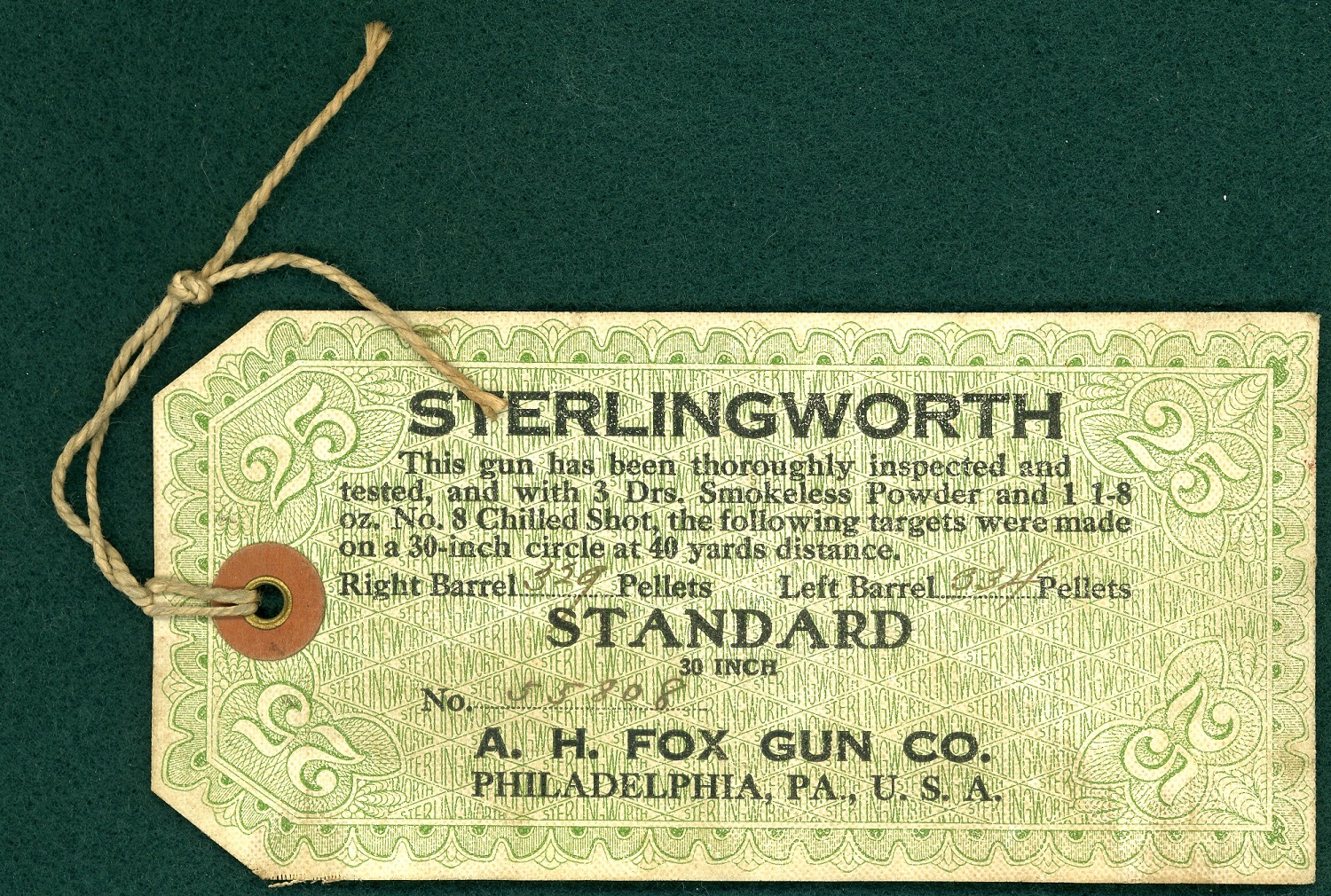

Over the years the hang-tags and the information given on them changed.

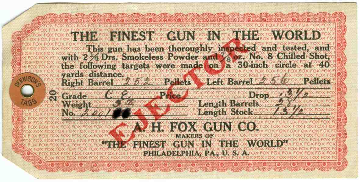

At one point in time 20-gauge tags were red.
I've never seen or snagged a picture of a 16-gauge hang-tag, and the Holy Grail of hang-tags would be the one for a Super-Fox that explains "BARRELS NOT GUARANTEED-SEE TAG."

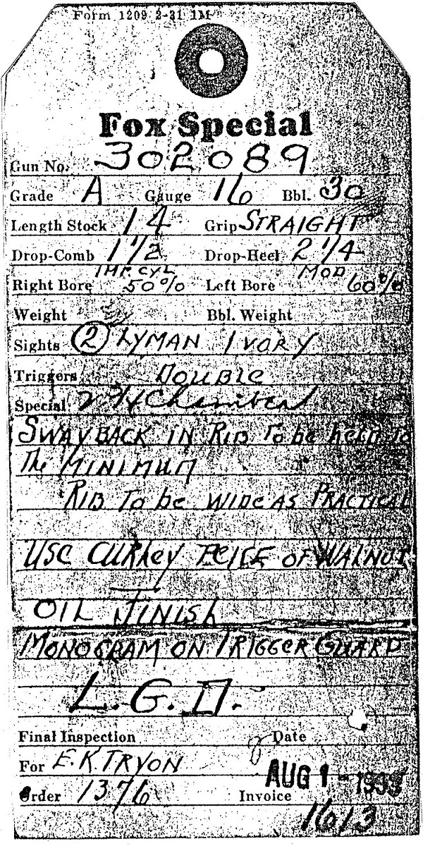

The only 16-gauge hang-tag I have a picture of is for a Savage-era Fox-Sterlingworth Deluxe Field and it doesn't give any load data. Based on the 12- and 20-gauge hang-tags I have pictures of, that give load data, I'd suspect the gun would have been targeted with 1 ounce of #8 chilled shot, nominally 409 pellets to the ounce. So, 211/409 = 51.6% and 241/409 = 58.9%. I have a 30-inch 16-gauge that was ordered bored 50 and 60% --

I would have ordered the above 16 with top rib as narrow as practical.Bobby
