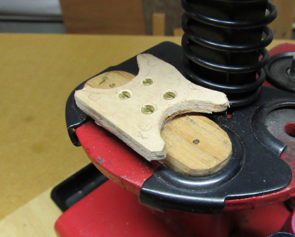

You can make your own cheap and dirty but very functional device that will accommodate your 2 3/4" setup to easily switch to 2 1/2".
I have a 12 and 20 gauge MEC Sizemaster and switch from one size to the other with no or minimal adjustments, as pictured below.
Made one for a friends 16 gauge MEC and it works quite nicely also.
I also made and use but not shown in the picture below a simple spacer I use in the powder and shot drop station, thus eliminating any adjustments there.
Hope this helps.
