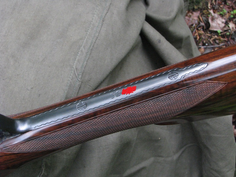

This stock is original. But does the checkering look original? I don't remember ever seeing that shape on the cheeks before. Considering this was for an AE and the card shows no extra wood work, I would assume done after?

That cheek checkering is atypical, and sans any factory documentation it was probably done afterwards. Regarding a Fox straight grip trigger guard, good luck on finding one. Best bet is to cut off the tail and "stretch" a regular half or full pistol grip guard. Here's one that was made to the dimensions of a righteous one to include the hole spacings, and properly Grade engraved. Welding must be done by a competent man so that the filler wire and old/new sections will match when blued or whatever. Not what most amateurs can do with their new Harbor Freight mini-welder. I've seen many that don't match and they stand out like a sore thumb.

Also, that stock appears to have an oval initial shield in the belly. Certainly not "normal" for any era Ansley H. Fox double.

I have an AE grade 16 that came from the factory with a straight grip. It was restocked at some point prior to my getting it.
However the stock pictured in the OP looks like a C grade or higher - based on the checkering of the cheeks and the quality of the (European) walnut. I do not think that Fox used European (thin shell) walnut on A grade guns.

The two sections of checkering appear to be done with diamonds at different angles and different spacings (LPI -lines per inch). That typically suggests it was done by a different "hand" as some stockmakers like to say. The cheek panel was probably checkered later and isn't original as others here have already suggested.
If you look at most any fine gun you'll usually see the grip and cheek panel checkering is identical in terms of LPI and angle of lines, and same with the forend checkering - it all matches properly. Montey Kennedy's book Checkering and Carving of Gunstocks is a great source of information on this subject. Newer books have been written, but I guess I'm old school now.
