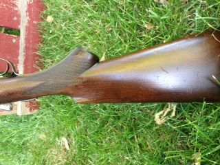

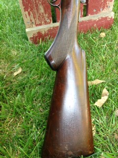

Thanks guys for all the info. My eyes were opened by you all and I tried to apply it as I took measurements and a bunch of pics. It definitely has been worked
on as you'll see. I'm told the stock was redone by Bill Ferguson, but not sure what else has been modified or they finished. The drop at heel is 2 and 1/4 inches and the drop at comb is an inch and a quarter. I'm still not sure if the barrels were cut down. The foregrip has a small crack running approximately 4 inches from the front right side back and there is a small pin that's been placed in it. Please take a look at the pics and give me some feedback. Again the serial number is 57108. I sure do appreciate the information and I enjoy learning and going through this process.

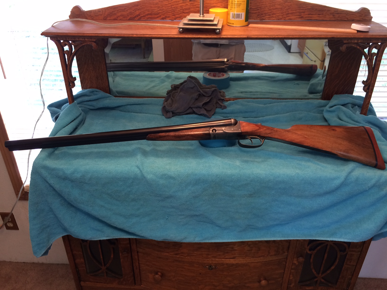

by HighDesertMan
More pictures

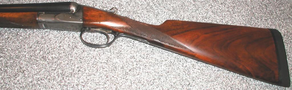

That is definitely a restock, and 98% sure the barrels have been cut. A Sterlingworth stock of that era looked like this --
57277 right
57277 right
57277 06.JPG (38.01 KiB) Viewed 9649 times
57277 left
57277 left
57277 07.jpg (36.97 KiB) Viewed 9649 times
The Sterlingworth was only supplied with a capped pistol grip until 1935 when Savage introduced their Fox-Sterlingworth Skeet & Upland Game Gun with a straight grip --

Re: Seeking Advice on a Fox Gun For Me & My Dogs
Posted: Sat Jul 08, 2017 11:05 pm
by HighDesertMan
Thanks for the information researcher. That makes sense with what I'm being told about it. I'm not sure what it does to the value. I imagine they had a good reason for doing what they did. Given that the barrels we're likely also cut down how does one go about determining what the chokes are? Being that I'm looking for a fox side-by-side to hunt birds with maybe I should take the advice of others and look for something more solid and original to its time. I know that I would like the barrels to be open and modified.
