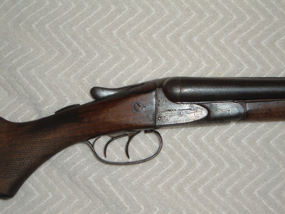

I have a 20 gauge Sterlingworth (# 235158) with 24.5 inch barrels. The standard short barrels are apparently 26". Where do you measure them; is it something other than breech to muzzle? This was rumored to be a "Lady's Gun"; guess it's possible someone had the barrels cut down?

I got my letter; factory shipping date of Nov 1915. Sterlingworth Brush Grade 20 gauage with original 26" barrels. I assume with shortened barrels, a cracked and nailed-together (!) stock, and the general well-worn appearance of the gun, that it would not be worth much to resell. I'm thinking of getting it OK'd by a gunsmith, and if it's shootable, getting a new stock and keeping it in the family.

This is the first 20 gauge that I have seen with the "Extra" Engraving. Has any one else seen one in a small bore?

One with somewhat similar "extra" engraving was pictured on a thread here a few months ago. The best guess seemed to be that it was after market work.

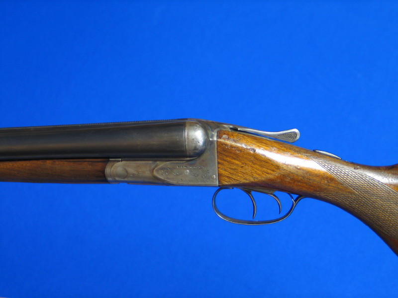

I will go out on a limb here, I have seen 4 of these guns and they all look to have the same amount of extra engraving. I think the last post stated that they may have been made up for one dealer or distributor possibly as a special order.
extra engraver sterlingworth.jpg (75.35 KiB) Viewed 3415 times

This one went to Watkins-Cottrell in Richmond, which appears to have sold a fair amount of Foxes...
