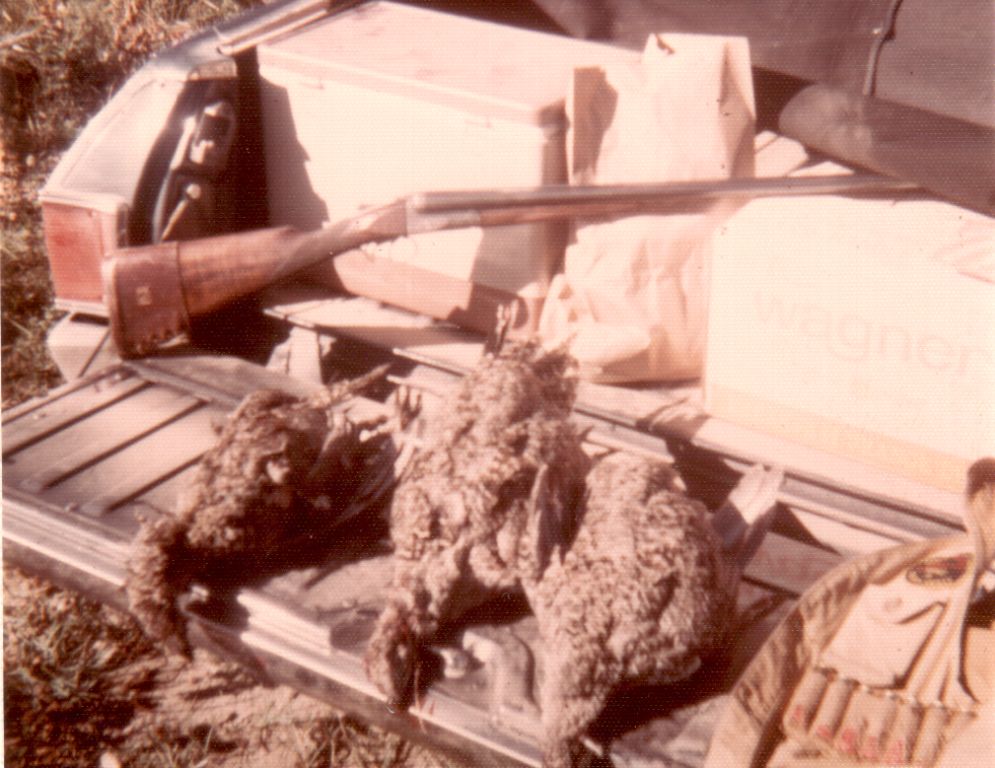

Galco pads in different sizes across the back for use on various guns I don't shoot all that often. Middle left the RedHead lace-on I've used on "Meat-in-the-Pot" for sixty years --
center the Pachmayr slip-on I use on my 12-gauge Fox-Sterlingworth Ejector Skeet & Upland Game Gun. Some of the others were on guns when I bought them.
