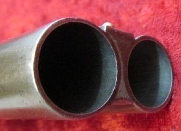

This is a bit off topic, but a 12-gauge Savage-era Fox Sterlingworth Standard showed up on GI and the picture of the muzzle of the said to be 30-inch barrels shows a gap between the tubes and clearly a keel.
138693 01 30-inch.jpg (52.27 KiB) Viewed 3417 times
May be a nail for the coffin of the old mantra that if there is a gap between the tubes, they have been cut.
