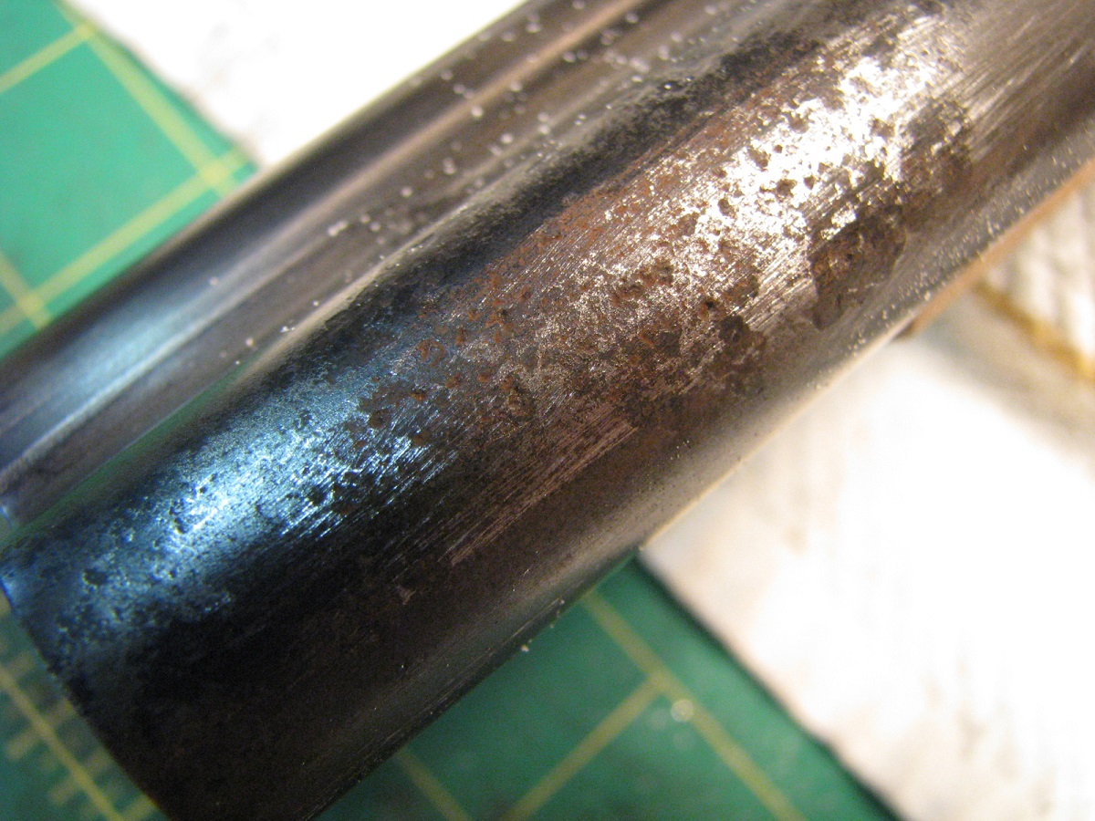

Congrats on a nice catch. The pics on page 2 here show a shiny spot and what appears to be shallow surface rust on the shorter barrel set. It takes a lot of rubbing with emery just to remove a few thou of steel, but Tom (vaturkey) gave you good advice on getting the barrel wall thickness checked. If indeed only surface rust it can be worked out and "spot reblued" by a good man using a specialized rust bluing solution (not cold blue). I personally wouldn't pay the money to have one or both barrels completely reblued, which will be costly and stand out like a sore thumb on an otherwise honest gun.
I mix my own solution using an old-time formula and do spot rebluing myself but only on guns I own. Maybe some of our members will step up and recommend a gunsmith they've used who's capable of doing that work?
I also see what appear to be a gap where the stock abuts the gun frame but that just may be shadows in that one pic. frank
PS - if your barrels look better than these, you should be OK. :) That blue color on the muzzle end is machinist Dykem. Click twice to expand this pic.

Thanks, Silvers. The depth of the issues on the two barrel sets I have does not appear to be as well weathered as the picture you provided. This definitely makes me feel better. I do not plan on doing anything drastic to my gun. I am refinishing the wood and will just blend the shiny spots on the barrel. I don't like having half a gun that looks new and the other half looking in true form. Although I am refinishing the wood, I still plan on it blending with the metal parts as best as I can manage. The gap seen in the picture is not near as bad in real life. I will post some pictures when I get the old girl freshened up and put back together.
