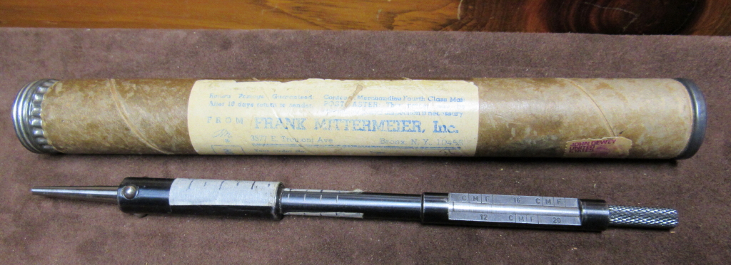

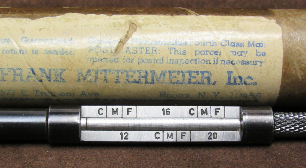

HDM,
If you have a simple set of calipers, either the dial type, digital or the older Vernier calipers to measure the diameter of the bore at the muzzle you can measure the diameter at the muzzle. You won't be able to measure inside the bore but at least you can determine if there is still some choke left.
The bore diameter should be around 0.729" +/- a couple 0.001's for a 12 gauge S'worth. If the bores measure less than that, at least there is some choke left. If both measure around that diameter, likely cut back from 30" or more.
An old Frank Mittermeier gauge would work just fine or some of the more modern tools. See below. The Mittermeier can give you a very good idea of where the choke starts and relatively how tight the choke is. I think a set shows up on ebay every so often. (Nope, mine aren't for sale.)
