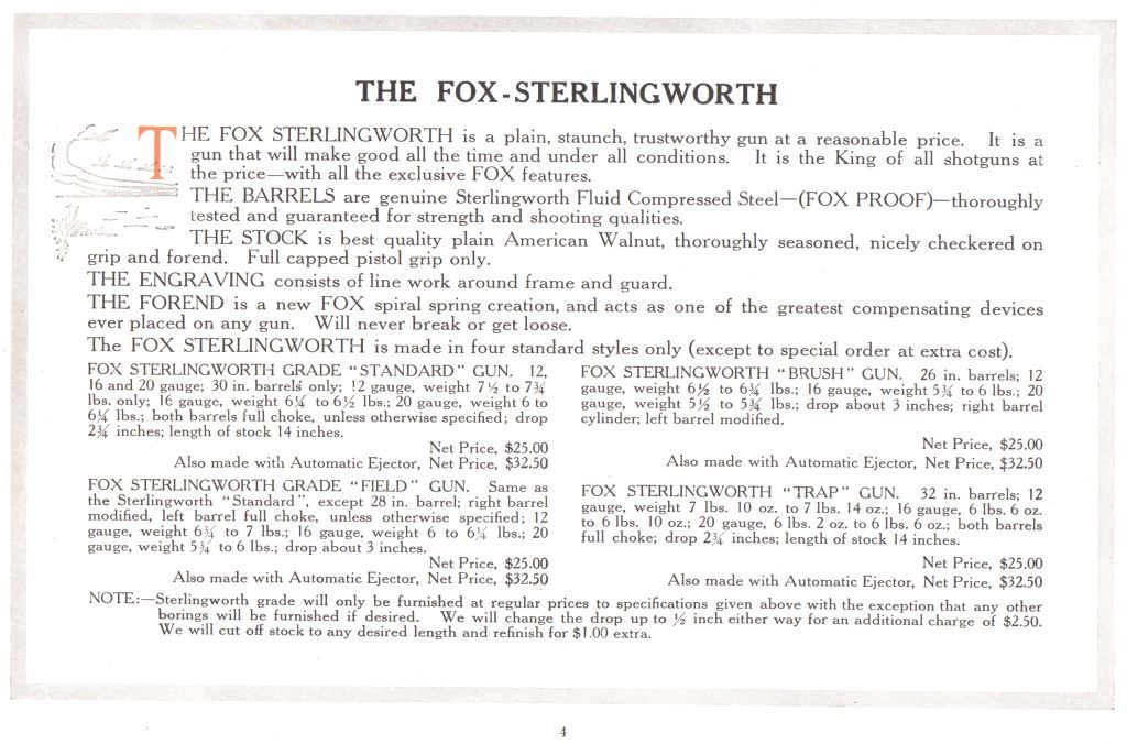

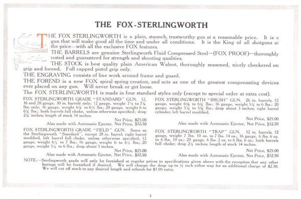

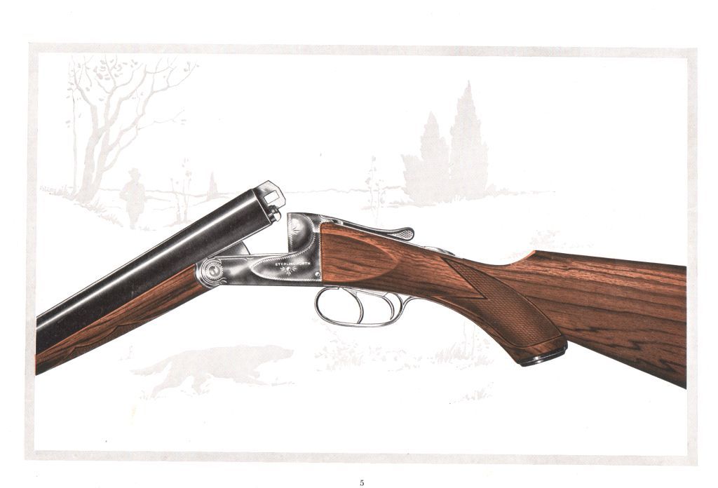

The Sterlingworth pages from the 1914 "A Fox Gets the Game" catalog --

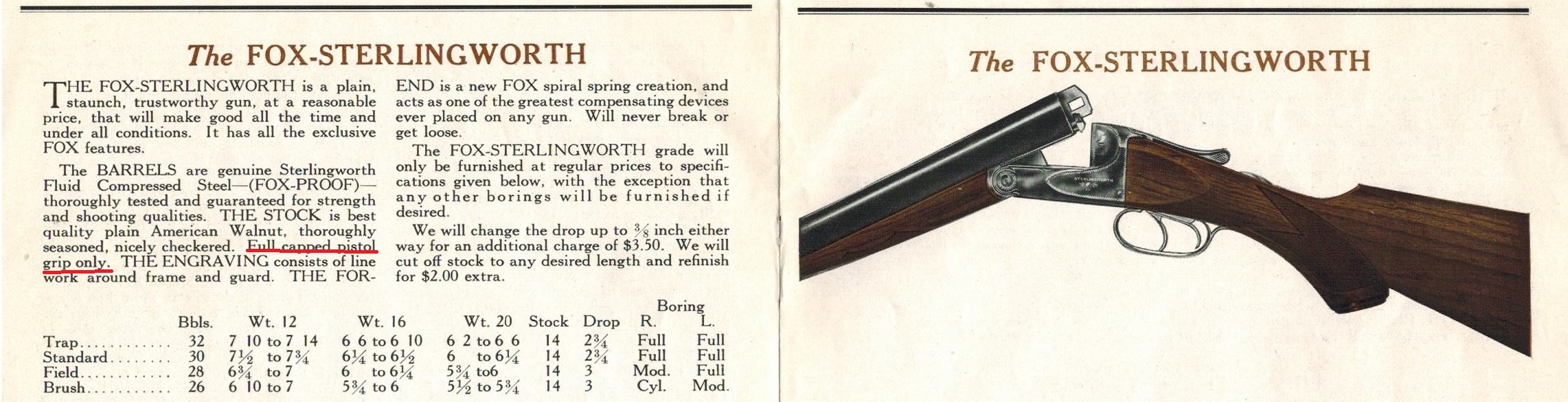

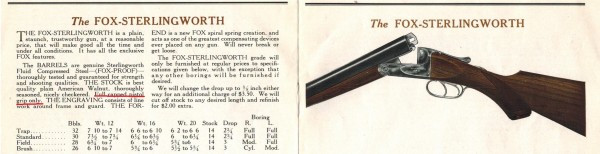

From the 1928-29 Catalog --
