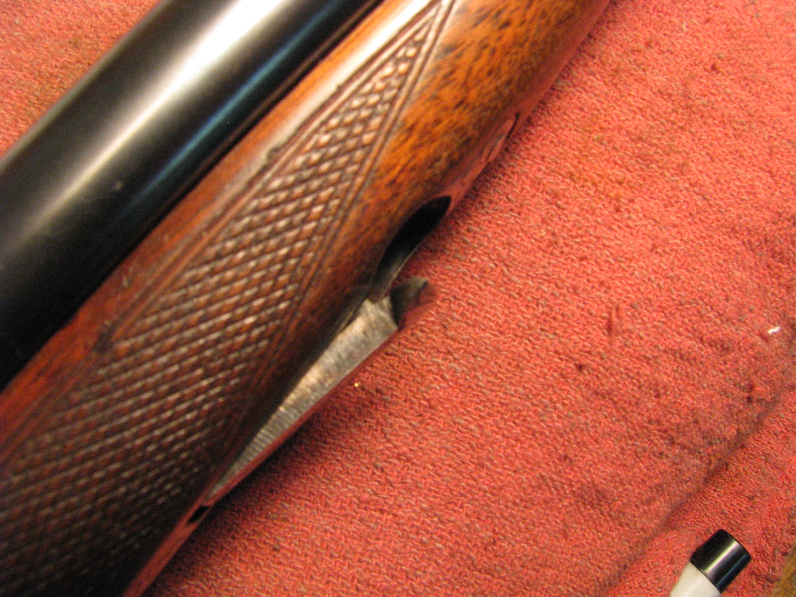

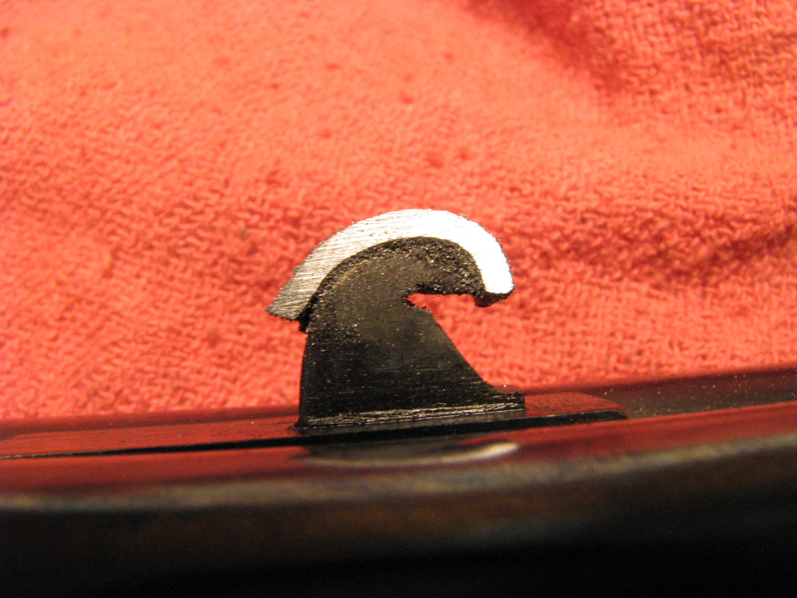

Here's a photo of the screwed-up forend lug, with the broken piece lying on top in position. You can clearly see where it broke off. It broke because someone in the past filed away the top of the lug, weakening it drastically.
