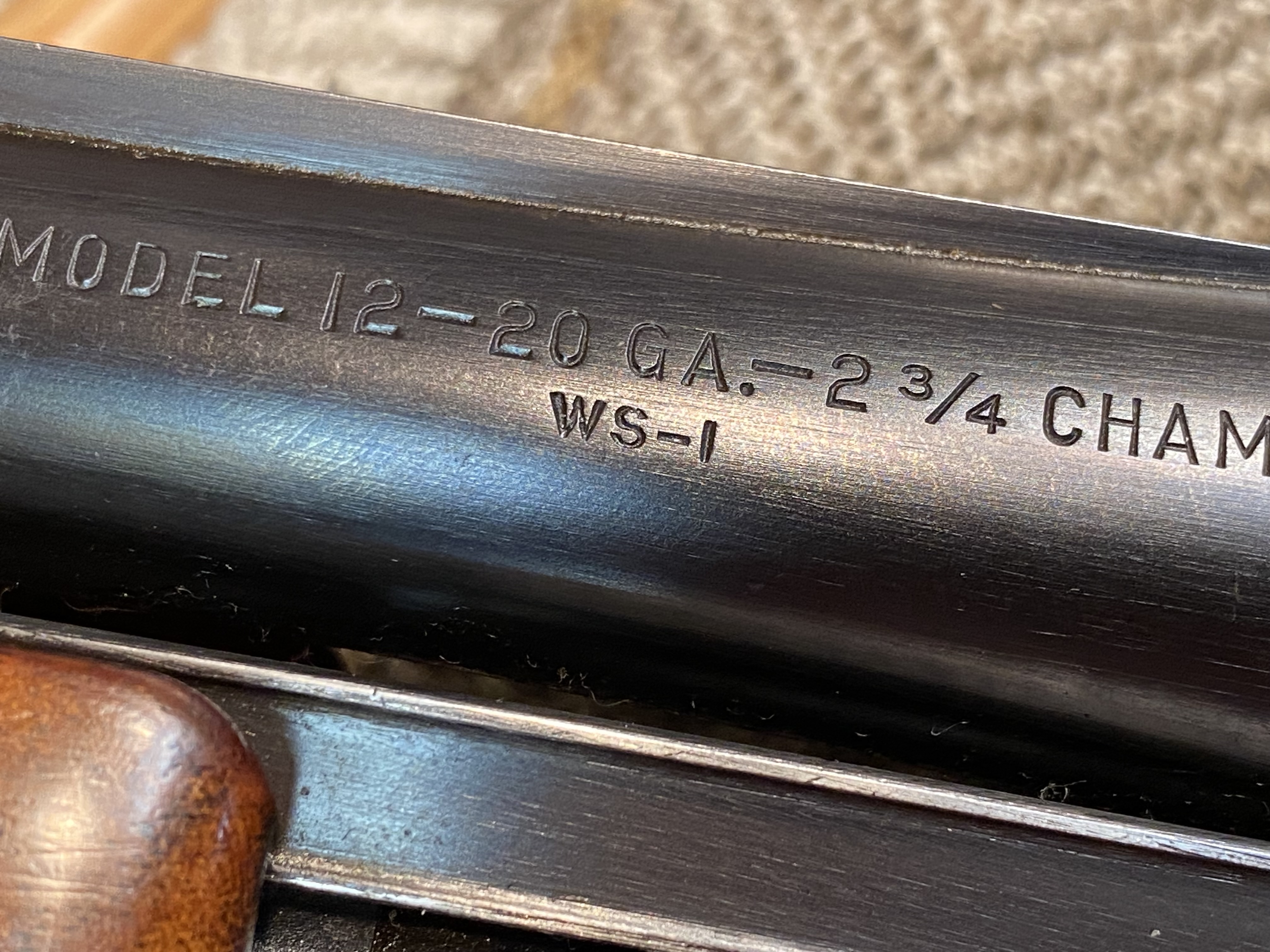

My 80’s Remington 1100 Skeet barrel also has a “reverse” choke, similarly designed to my 12 Model Winchester 12 with a .004-.005” constriction with about a 2” inch long section to the muzzle that is opened to about.010” over cylinder. While I haven’t done any formal patterning tests, I have shot thousands of rounds over the years with Model 12/1100 using contemporary plastic/shot cup ammo on the skeet course. My observation is that the SK-1 design of the Model 12/1100 delivers a pattern out to 25 yards comparable to a cylinder choke(no constriction). When using standard .005” Briley Skeet chokes in another of my Model 12’s as well as other skeet choked shotguns the patterns are “denser” as demonstrated by consistently cleaner breaks from skeet stations 3-5….As opposed to usual chips/pieces from those same stations…and comparable to a cylinder choke. My Remington SK-1 behaves like a cylinder bore as well. Just my thoughts observations though. My interest is peeked though, and I may do some formal pattern testing to get some actual data.

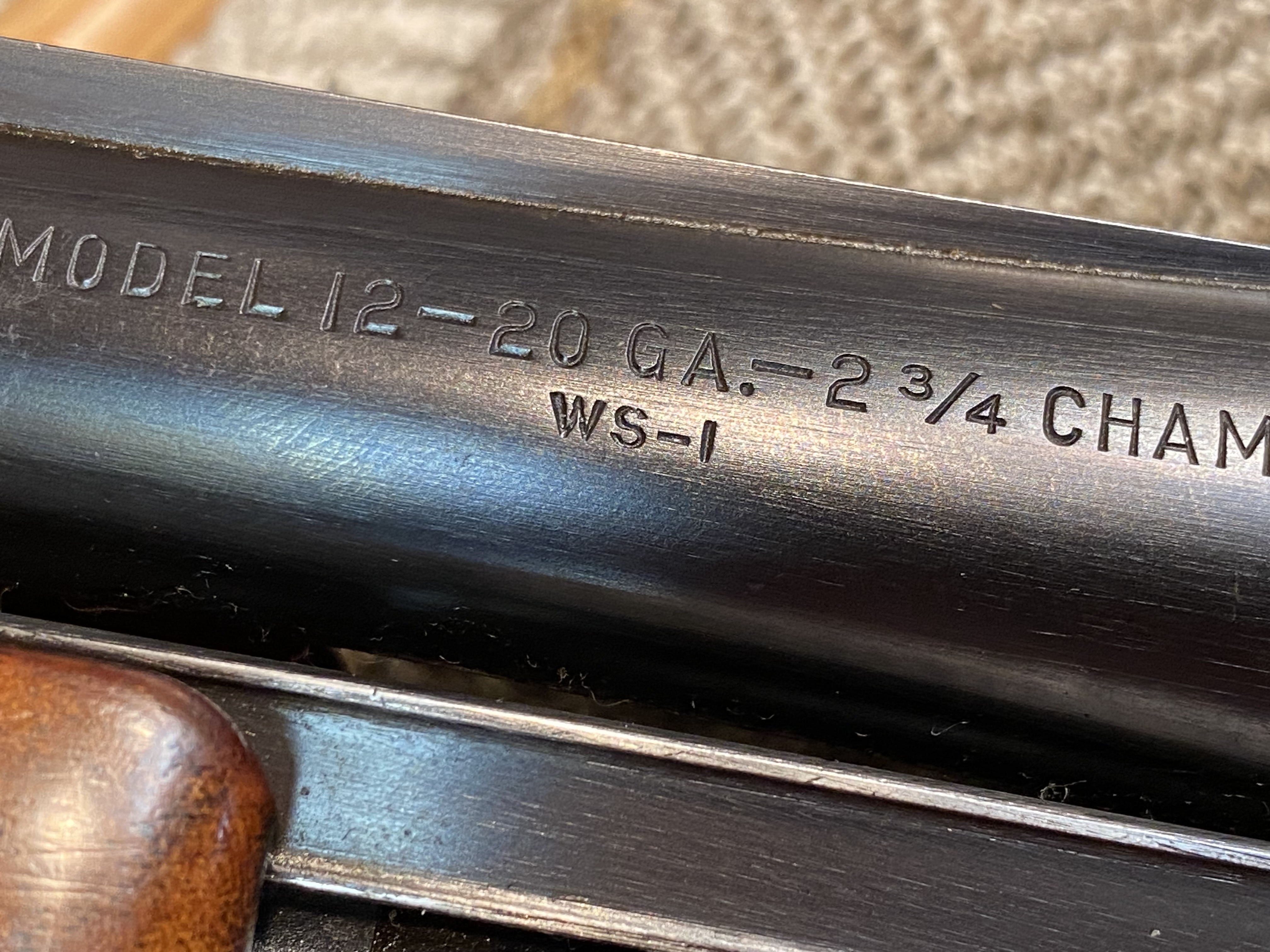

My 80’s Remington 1100 Skeet barrel also has a “reverse” choke, similarly designed to my 12 Model Winchester 12 with a .004-.005” constriction with about a 2” inch long section to the muzzle that is opened to about.010” over cylinder. While I haven’t done any formal patterning tests, I have shot thousands of rounds over the years with Model 12/1100 using contemporary plastic/shot cup ammo on the skeet course. My observation is that the SK-1 design of the Model 12/1100 delivers a pattern out to 25 yards comparable to a cylinder choke(no constriction). When using standard .005” Briley Skeet chokes in another of my Model 12’s as well as other skeet choked shotguns the patterns are “denser” as demonstrated by consistently cleaner breaks from skeet stations 3-5….As opposed to usual chips/pieces from those same stations…and comparable to a cylinder choke. My Remington SK-1 behaves like a cylinder bore as well. Just my thoughts observations. My interest is peeked though, and I may do some formal pattern testing to get some actual data.
