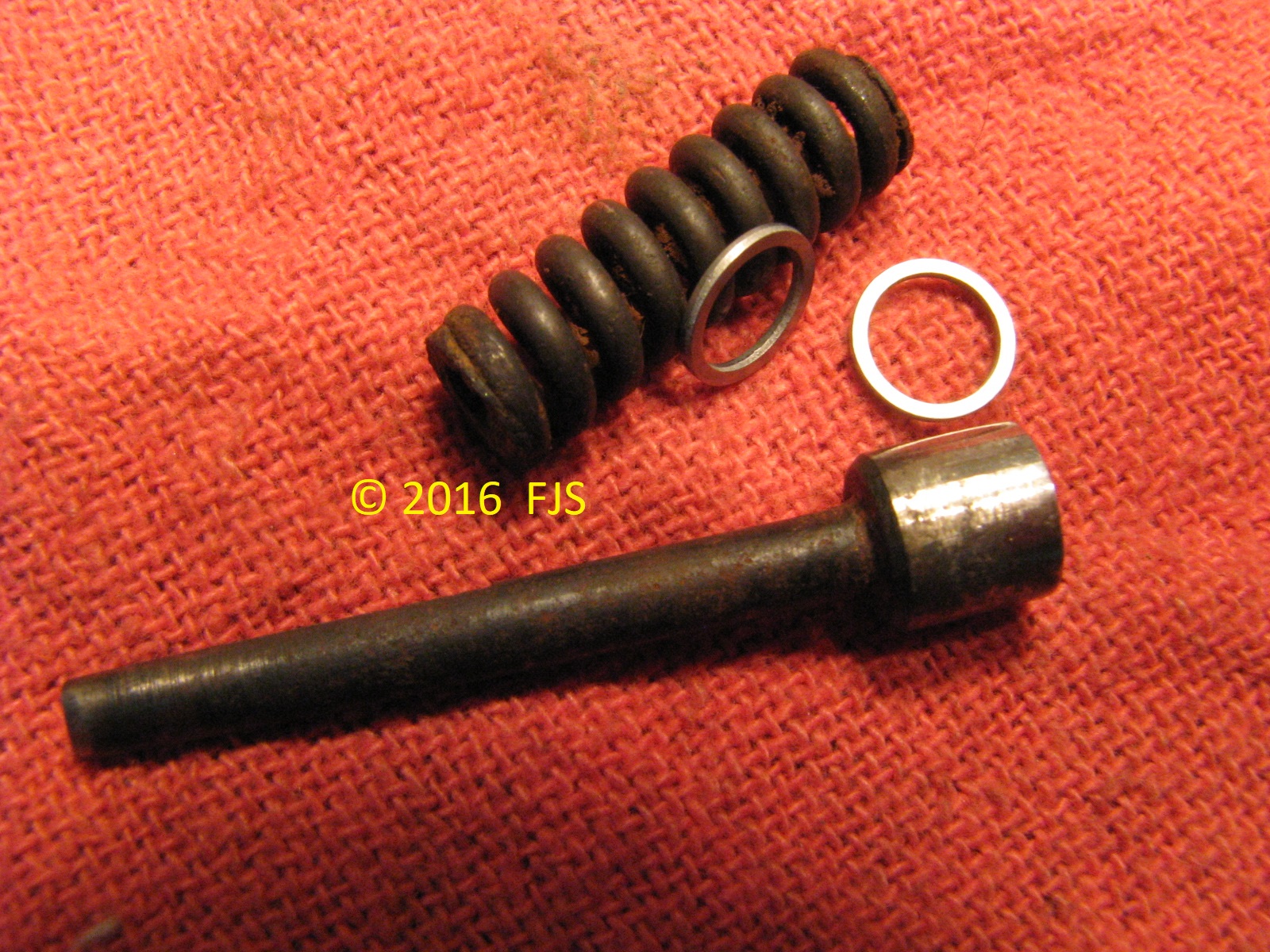

Here for info are spacers I made up on the lathe to increase the compression of weak and virtually unobtainable Fox smallbore mainsprings. This one a 16-gauge Ejector gun. One spacer per spring. Easily done and it doesn’t take much to restore the spring rate and fall of the hammer(s). frank
