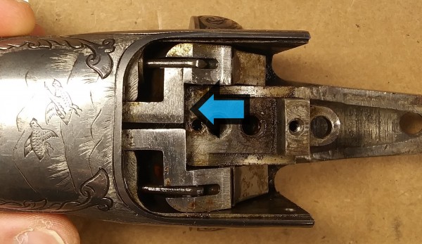

The pictures below are to big to put in one post, sorry for the size. I used instructions posted on this forum to get this far, but I must be missing something or something is stuck? I removed to hammer pin and tapped both hammers off the frame hammer block and the hammers have to come out. I understand that this happens, but I've worked the hammers off and on the hammer block and nothing has loosened. I can't find a schematic drawing and I am going off of what I can find in the McIntosh Fox book.
1st Pic Hammers on the hammer block in frame

Post by bb_shot »
2nd Pic Hammers off Hammer block in frame

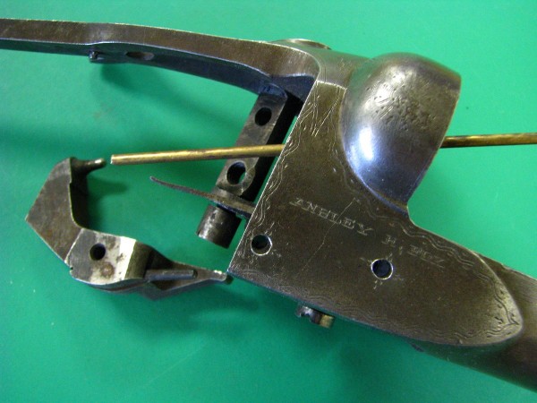

Just keep tapping/pushing backwards on the 3/32" rod through the firing pin hole in the standing breech until the hammer(s) pops out. It's being held in place by some slight compression of the mainspring. Once the hammer tip clears the frame you may push against the top of the hammer. No Kroil or similar should be required. Again, I recommend you use a brass punch because it's initially pushing against the tip of the firing pin which is integral with the hammer(s). If you can't find 3/32" diameter brass get an old fashioned brazing rod at the hardware and scrape off the flux coating.
