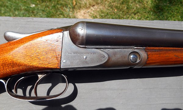

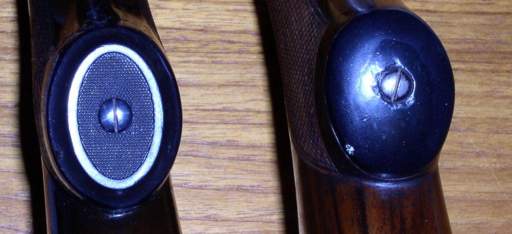

Looks like a nice example of a The Sterlingworth Co. "pin gun". The proper grip cap for a gun of that vintage was like this --
57277 11.JPG (35.58 KiB) Viewed 12078 times
I don't know if anyone is reproducing that grip cap.
Later they used the grip on the left and finally the one on the right.

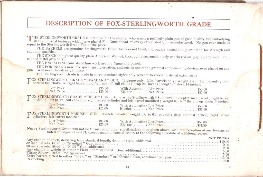

I don't believe there is such a thing as a The Sterlingworth Co. ejector gun. The 1910 The Sterlingworth Co. catalog doesn't mention ejectors and only offers the 30-inch barrel STANDARD gun and the 28-inch barrel FIELD gun. The highest The Sterlingworth Co. serial number I've recorded is 53824 and the lowest serial number Sterlingworth Model 1911 I've recorded is 53140. The lowest serial number Sterlingworth Ejector guns I've recorded are in the 589xx range.
The 26-inch barrel BRUSH gun was added to the Sterlingworth offerings in the 1911 A.H. Fox Gun Co. "Campfire" catalog No. 24 --
1911 Campfire Catalog page 14
1911 Campfire Catalog page 15
along with the new 1911 F.T. Russell designed automatic ejectors.
The 16- and 20-gauges were added to the offerings in the 1912 "Campfire" Catalog No. 25 and the 32-inch barrel TRAP guns were added to the offerings in the 1913 "A Fox Gets the Game" catalog.

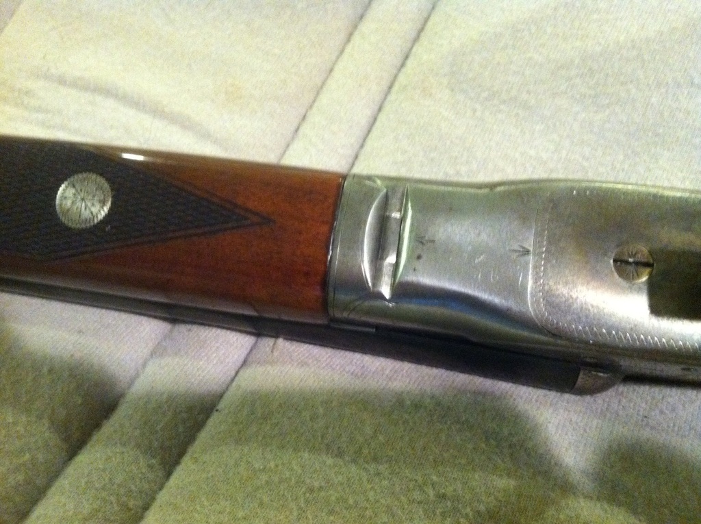

Looking at your third pic, the break lever appears to be a little too far right which likely indicates someone installed a new locking bolt but without properly fitting it. You might want to get a good Foxsmith to look at that.

Silvers, Thank you for your reply, and boy I hope you are wrong. Unfortunately for me you are probably not. Who would be a good fox smith? I live in the greater saint louis area. One reason I bought the shotgun without holding it was that pic....I really do not want to learn the hard way on my first fox. I will say that in my recent internet google picture research LOL, I have seen photos of top levers in the same position on fox guns, anyway live and learn I guess. Is there anyway to tell myself that the bolt has been replaced without taking it to a smith or not? Obviously any repair would need to be done at a smith.

When properly fitted the very end of the break lever will be slightly right of centerline of the top tang. Farther right than that often indicates a replacement bolt/improperly fitted, maybe one of the factory reject bolts on the market, or possibly that someone has jimmied up the bolt camming slot in the barrel extension to get the lever farther right. Whatever, then when firing heavy loads the barrels will often pop open because the camming contact isn't proper. I do all my own mechanical work on Foxes but can recommend Brian Dudley (NY) and Dan Rossiter (PA) to inspect your gun once you get it and can discuss with one or the other. I see and talk with both of them at SxS shows and shoots. You can look up their contact information by using the search function (upper right hand corner). But with that said there are plenty of gents here who can step up to get you contact info for Brian or Dan, or alternately to recommend a gunsmith they've used for similar lockup work.

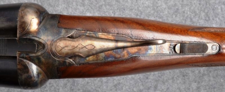

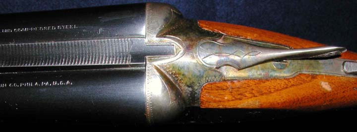

FWIW, here are the top-lever positions on a couple of mint to near-mint Sterlingworths --
