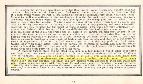

by Researcher
The only mention of the finish on Fox wood I've found is these sentences used in the 1923 to 1930 catalogs --
- 1923 A.H. Fox Gun Co. catalog pg 12
And in the 1924 to 27 catalogs where it says the HE-Grade Super-Fox stock is oil finished. While all the A.H. Fox Gun Co. catalogs from 1924 to 1929 list the Super-Fox as having an English Walnut stock, the 1923 and the 1925 Super-Fox brochures both state the stock is oil finished American Walnut.

Spray painting technology wasn’t around prior to the 1920’s. Also, E I DuPont's Duco nitrocellulose-based lacquer wasn't developed until the 1920's and Fox adverts started appearing late in that decade, stating in effect that the new Duco was being used on Sterlingworths. And while high grade Foxes were said to be oil finished as in the inset posted by Dave, I understand that a wiping varnish was used earlier for Sterlingworths into mid grades. I have the formula for the varnish said to have been used by Fox and it's made up of 5 ingredients including an exotic and very hard to find one to help keep the varnish somewhat flexible in cold weather. I make it up in small batches and have used it to do spot restoration on Fox stocks that were goofed up as when some hacker tried to fit a recoil pad and gouged heavily into the stock. Often such stocks are refinished which is a shame and especially so when modern trendy finishes are used, imo. There's a world of difference between those two words. Once I gave some of the varnish to a good stock wood man. He restored two or three Foxes with it and their stocks looked good, but (long story short) he was humble and wouldn't post the pics he sent to me. Lesson learned.
