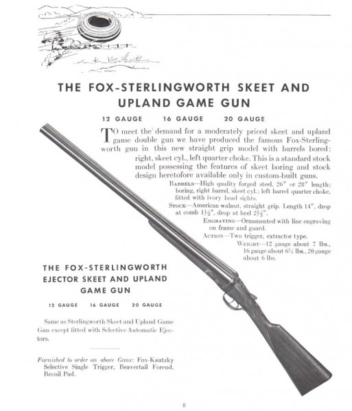

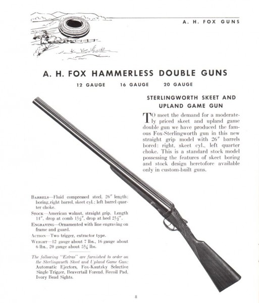

The twin ivory sights were optional on the Fox-Sterlingworth Skeet & Upland Game Gun when it was introduced in 1935 --
1935
1935
but by the 1937 catalog they were standard --
1937
1937
