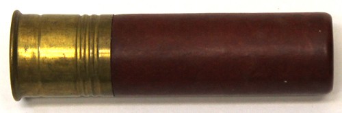

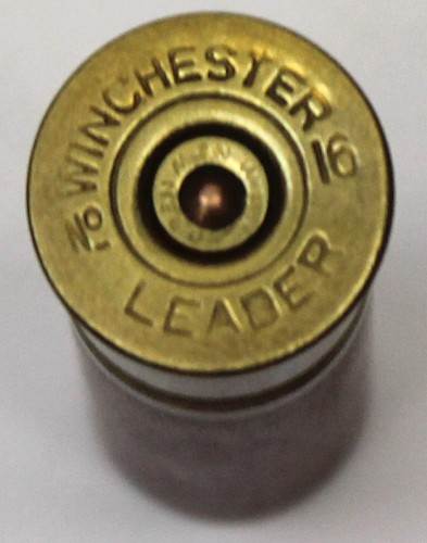

Many of the same Winchester catalogs that offered the 3-inch chambers for the 16-gauge Model 21, showed their progressive burning powder, high velocity, 16-gauge Super-Speed 1 1/8 ounce loads offered in 2 9/16 and 2 3/4 inch shells. Their LEADER "specified" loads, topping out at 2 3/4 drams of bulk smokeless powder or the equivalent in dense smokeless powder pushing 1 ounce of shot came standard in the 2 9/16 inch shell, and could be ordered in a 2 3/4 inch case at no extra cost. They could also be put up in a 2 7/8 or 3-inch case at extra cost. A LEADER 16-gauge 3-inch shell --
Leader No. 16 3-inch Side.jpg (16.74 KiB) Viewed 8920 times
Leader No. 16 3-inch Head.jpg (42.45 KiB) Viewed 8920 times
Historically, from the beginning of factory loaded (1891 for UMC, 1893 for Winchester) paper shotgun cartridges the longer shells didn't offer heavier loads than could be had in the 2 3/4 inch shells. What they offered was more/better wadding which many serious competitive shooters believed an advantage.
