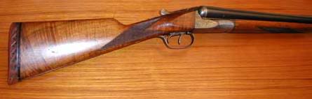

I'm looking at a Fox Sterlingworth 12 gauge for sale locally and I'm interested to see what it's worth. The serial number is 161267 and comes with two sets of barrels. It has a straight grip English stock and a Beavertail forend with a rubber recoil pad. The 30 inch barrels are marked Savage arms Corp Chicopee falls Mass. There is a blemish at the end of the barrel where the bluing has come off. The second set of barrels are 26 inches and marked Savage arms Corp Utica Ny. With 2 3/4 inch chambers. All pieces have matching serial numbers, there are no bulges or dents in the barrels and with a quick check with a barrel gauge both barrels are choked IM and Full.

Couple things that I notice that I would have concern about. First, there has been some damage to, or a botched attempt at repair to, the rear of the top rib and rib extension. I've never seen damage quite like that, and it would require careful examination to determine the level of soundness of the rib in that area. Next, the restock of the butt doesn't seem to be mating well with the rear of the action. There appears to be a gap between the wood and the action on the forward area of the cheek panel. It may be only a shadow, but that area absorbs much of the recoil from firing, and proper fit there is pretty important to prevent movement and subsequent damage/cracking/splitting of the stock head. That could be addressed with bedding, if the gun was intended to be a shooter, but I'd be very concerned about the top rib. Proper repair of that would be prohibitively expensive.
As to value, I'd have to be able to buy the gun for the value of only a one barrel set gun, shooter grade, and that's very subjective. IMO, the set with the damaged rib has very little value.

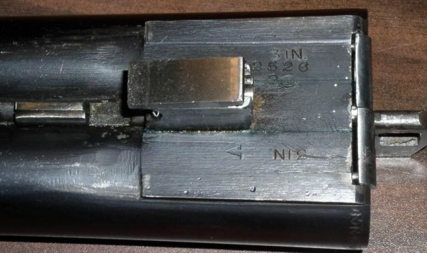

I haven't recorded any Fox-Sterlingworth Skeet & Upland Game Guns above serial number 160818. Those guns I've recorded from 160840 on up all had the capless pistol grip stock. All the guns I've recorded above the serial number of the gun in question have been SP- or "Drawbolt" frame guns. That stock doesn't look quite right for a Skeet & Upland Game Gun stock. The stock cheeks are too defined, the checkering comes too close to the cheeks and the nose of the comb is fluted. A couple of "right" Fox-Sterlingworth Skeet & Upland Game Guns --
135793 02 Fox-Sterlingworth Ejector S&UGG.jpg (9.57 KiB) Viewed 13772 times
I'd like to see some better pictures of those Chicopee Falls barrels off the gun so we can see the lug and rib extension. Wondering if someone worked over a set of Stevens barrels to fit a Fox-Sterlingworth receiver?

It looks re-stocked. But the question remaining is it a SSUGG or Sterlingworth Brush.

Are there individual forearms for each set of barrels or has one forearm been made to work with both? Usually when the factory added a second set of barrels there was a 2 stamped under the serial number on the barrel flats and the forearm iron of the forearm for that set of barrels.
A Second Set of Barrels added by Savage.  Note 2 below the serial number
As long as the original set of 26-inch barrels are sound, the gun still has to be a $600 shooter.

From what can be seen in the pics I'd say the Chicopee barrels weren't factory fitted and that prompts questions, if the interferences and clearances are proper. Just because they work and fire doesn't mean they're right. Also I don't see a discernable proof mark.
The back end of the top rib was obviously filed, and the breeches look to be rounded off to match with the breech balls (fences). JFI - some 12-gauge barrels both later Savage/Utica and Chicopee seem to have been deliberately made quite a bit oversize at the breech end, to be fitted to a variety of left-over frame forgings that were/had been languishing in stock.
