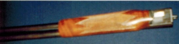

Finding pictures of documented beavertails is tough. Here is a scan of a very poor photo of an extra set of barrels with beavertail forearm fitted to a Sterlingworth by Savage in 1969.
Extra set of barrels with beavertail forearm fitted by Savage in 1969
