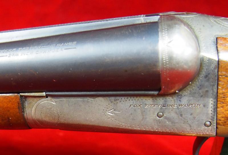

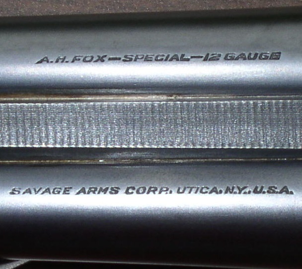

Your gun is a Fox-Sterlingworth, the entry level Ansley H. Fox shotgun, just what it says on the sides of the frame!!

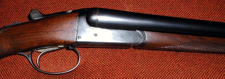

The SP-/SPE-Grade had a blued slab-sided frame. The SP-/SPE-Grade was introduced in June 1932, and the early examples were absolutely plain --
Here is a magazine ad from the introduction of the SP-Grade --
that also shows the Fox-Sterlingworth.
Then by about 1935, they added a bit of border engraving and little decorative flourishes --

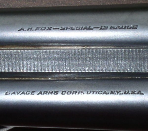

Early on the SP-/SPE-Grades had the right barrel marked A.H. FOX -- SPECIAL - xx GAUGE --

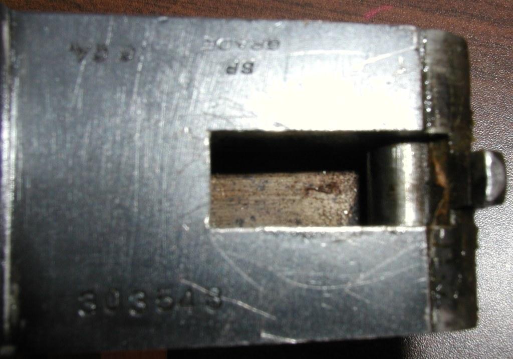

This gun also has the serial number and 16 GA on the watertable --
This gun a few hundred later has SP GRADE also stamped on the watertable --
but the top of the barrels just say SPECIAL ALLOY -- FORGED STEEL --
