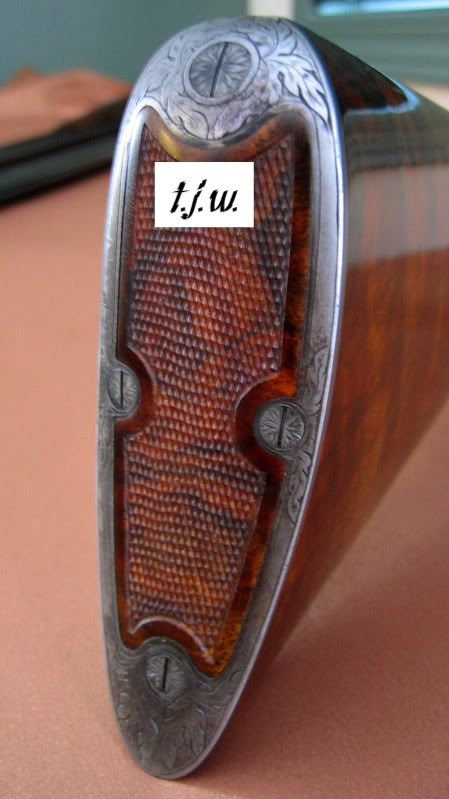

Post by MARSHFELLOW »
This is an original Fox skeleton. It's on a XE (16) 2 bbl set with D style checkering...all documented.
[/img]Image

Post by mc15426378 »
Whoooeee! Very nice Tom. Looks a little too clean though. You need to send that beauty to me for a field test. I'll send her back with a little Missippi mud worked in. :roll: :roll: :roll:
Mike
Posts: 1660
Has thanked: 245 times
Been thanked: 137 times
That beautiful butt ain't never been on the ground! Bobby

Re: buttplates on graded guns?
Today we're back to discussing skeleton buttplates, so I thought I would bring this thread back to the top so everyone could see Tom W.'s skeleton buttplate. On the topic of whether these companies like A.H. Fox built their own skeleton buttplates for the one in ten thousand need for one, I have a Parker Brothers order in my files where Hunter Arms ordered a skeleton buttplate, just one.
