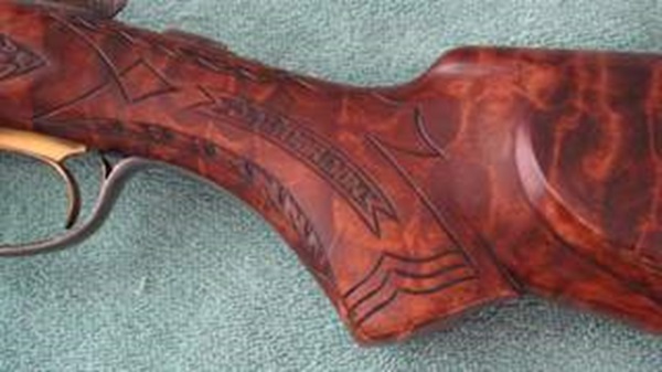

That is extremely rare that a Sterlingworth letters with 24-inch barrels. We have recorded a handful of graded guns with 24-inch barrels -- August 2010, December 2014, and September 2026 Card of the Month.
Come on Bill as far as "never say never" goes can there be anything mor outrageous than the fourteen Joshua Green 30-inch 20-gauge AE-Specials with their silver duck in the rib, carved cheekpiece stocks (several of maple), gold plated SSTs, etc --
